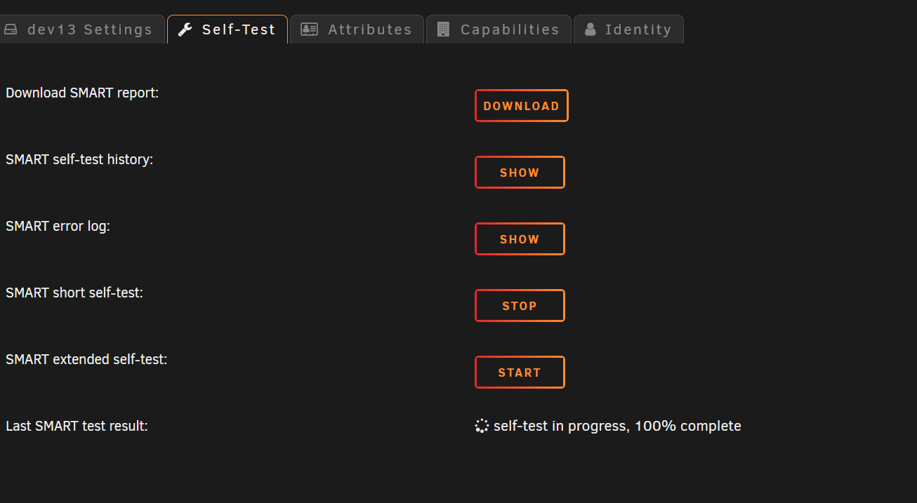

S.M.A.R.T Self Test seems to run constantly
I've just noticed that the SMART self test seems to be running constantly and it's stuck at 100% on all drives. I've rebooted the server and still the self test starts up again, and again, at 100%, for all drives in the array including cache and parity drives.

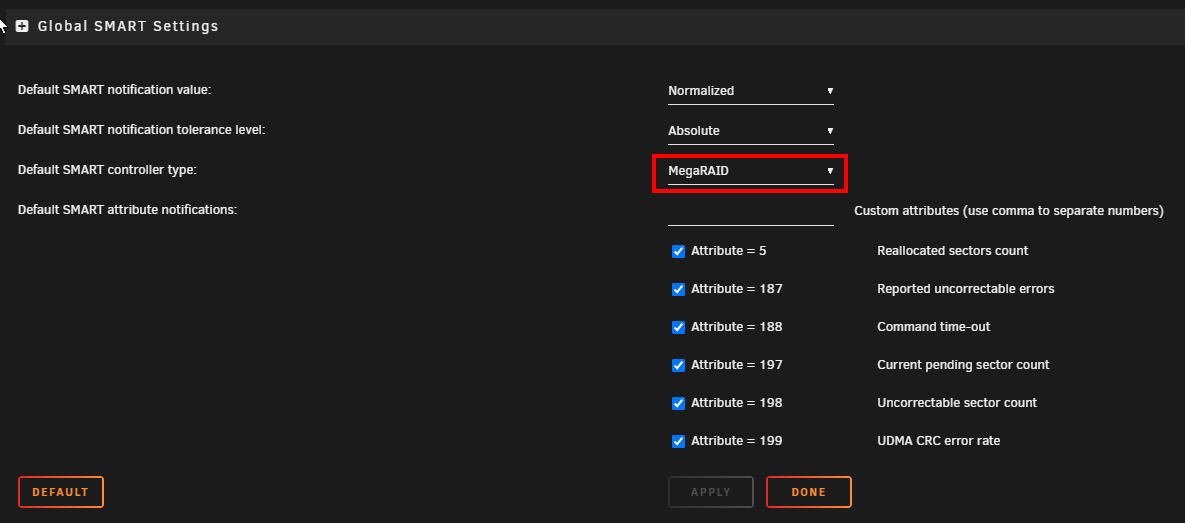

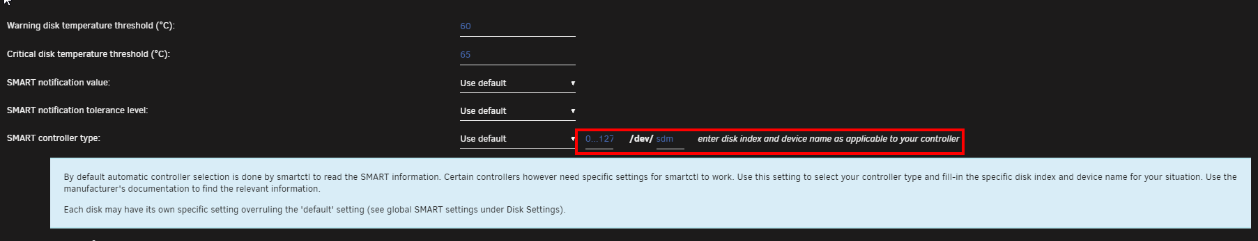

I changed the default Smart Controller Type in disk settings to Megaraid since that is the driver that is being used according to the hardware report.
The continuous SMART test seems to have gone away, but, I have now noticed that each individual drives SMART config has some extra fields.
It appears as though the Device Name is populated automatically and correctly. But Disk Index does not have a value.
I've searched online and through the docs and can't find anything that refers to the Disk Index and where/how I would get that.

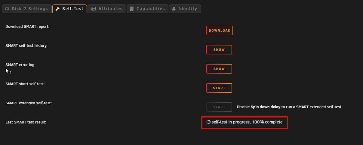

Manually triggering a shot self-test does return a message in red saying "Errors occurred - Check SMART report" but checking the SMART report shows no problem. And, if you refresh the screen the message changes to green and says "Completed".
The interesting thing is this error message only pops up for 3.5inch spinning drives that are part of the Unraid array. I don't see the same error message on SSD drives that are part of the cache pool.

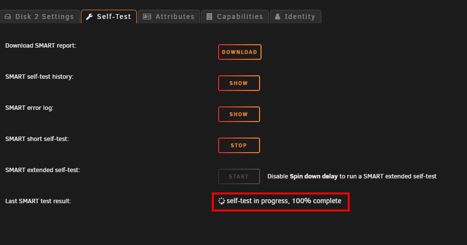

OK, so this long rabbit hole brought me to this conclusion.
There was nothing wrong with SMART testing to begin with. There is however, I think a bug in the Unraid UI.
Switching the default SMART controller type back to auto, results in manually triggering tests to run, report the progress % and complete successfully without error.
BUT,

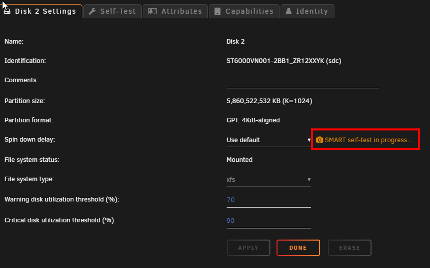

The UI for each drives disk settings will report there is a test running, and, the self-test page will also show "self-test in progress, 100% complete". THis is shown even though there are no self-tests actually running. I've confirmed with smartctl that no tests are currently running on /dev/sdc yet the GUI is showing a test in progress.

The particular line to refer to for a currently running test is;
Self-test execution status:      (   0) The previous self-test routine completed
                                        without error or no self-test has ever
                                        been run.
If the test WAS currently running that would have a value showing the current progress like this.
Self-test execution status:      ( 249) Self-test routine in progress...
                                        90% of test remaining.

17 hours ago, aglyons said:
So the next question is, why is Unraid using the Megaraid driver for the controller that is running in HBA mode?
Because it's not a true HBA, a true LSI HBA will use the mpt3sas driver, some LSI controllers even use it when they are in RAID mode, you have a controller that has a HBA mode but it's not a true HBA, so like mentioned SMART might not work correctly.

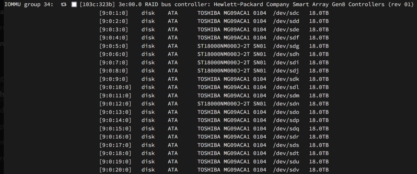

Hi guys,
I'm getting the same IU issue in one of my UnRAID servers, with a HP p822 SAS controller.
In one Dell Server, with a PERC 750 works fine.
  • 2 months later...
I have the same problem, I have an HP Proliant ML 350p G8
