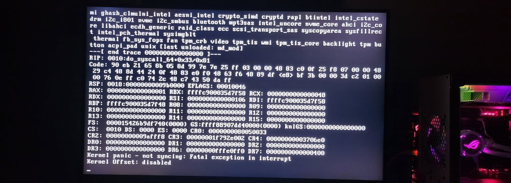

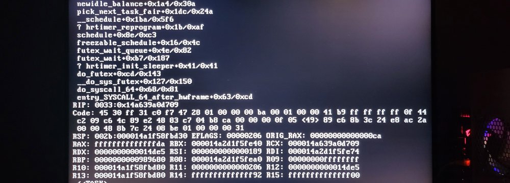

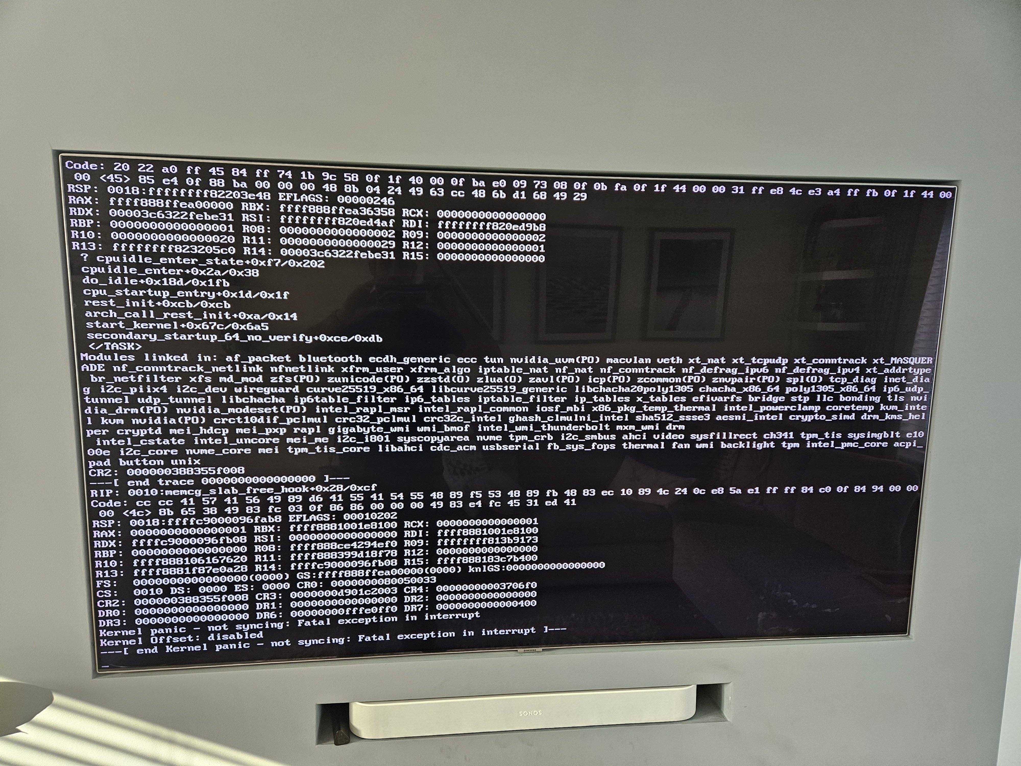

Waves00 Posted October 3, 2023 Share Posted October 3, 2023 34 minutes ago, Tim Knowlden said: Can I piggyback off this thread? Over the last two days I've had 2 crashes. Latest changes were to update to latest unraid version and install compreface. Pic of terminal after crash. Don't know if this makes any sense to someone? I'm getting the same error and keep having crashes as described in this thread. Quote Link to comment

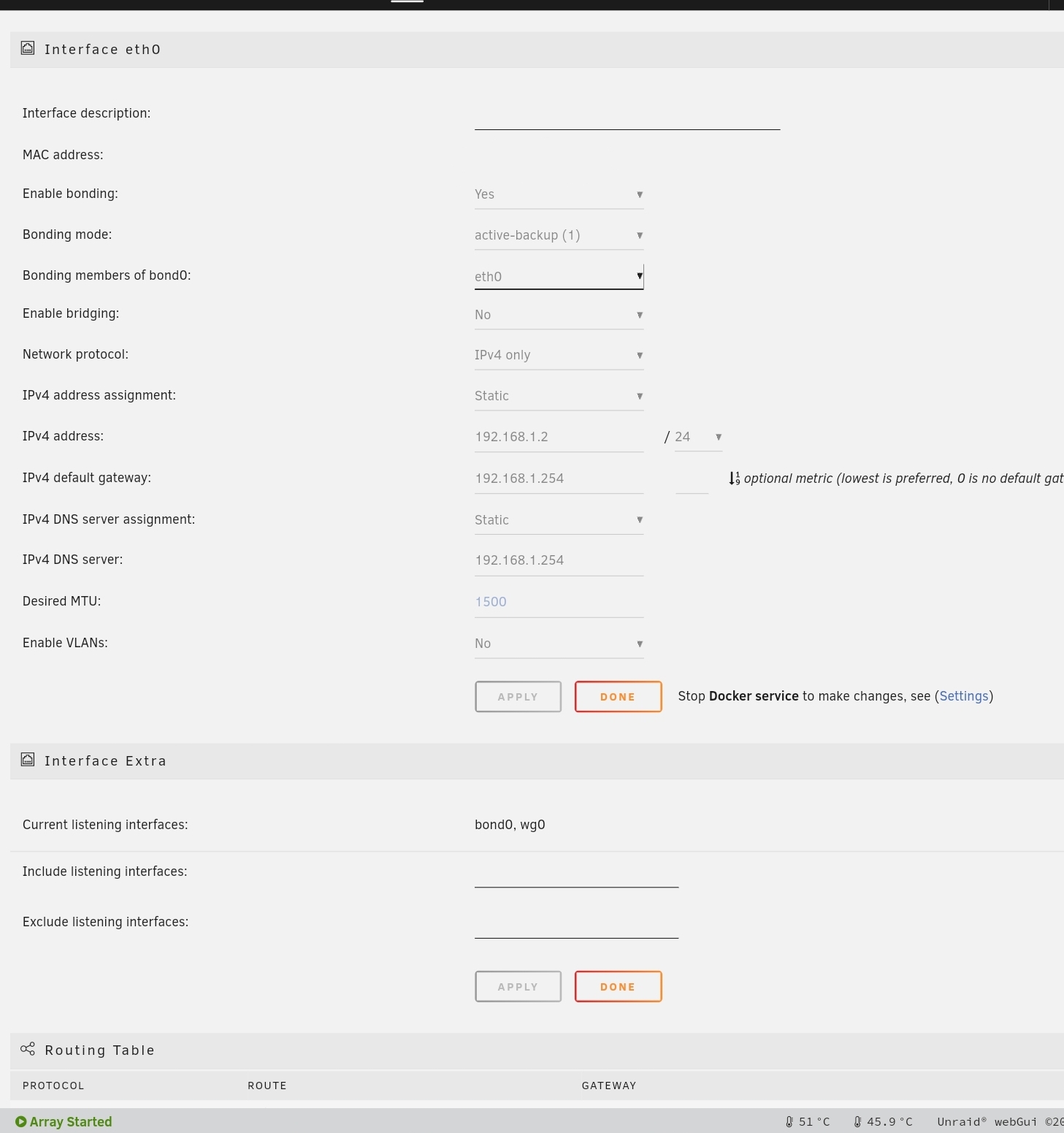

JorgeB Posted October 5, 2023 Share Posted October 5, 2023 5 minutes ago, Tim Knowlden said: I have had another crash Oct 3 00:03:08 TK-SRVR kernel: macvlan_broadcast+0x10a/0x150 [macvlan] Oct 3 00:03:08 TK-SRVR kernel: ? _raw_spin_unlock+0x14/0x29 Oct 3 00:03:08 TK-SRVR kernel: macvlan_process_broadcast+0xbc/0x12f [macvlan] Macvlan call traces will usually end up crashing the server, switching to ipvlan should fix it (Settings -> Docker Settings -> Docker custom network type -> ipvlan (advanced view must be enabled, top right)). Quote Link to comment
Tim Knowlden Posted October 5, 2023 Share Posted October 5, 2023 I did the suggested fixes to continue using macvlan since oct3 https://docs.unraid.net/unraid-os/release-notes/6.12.4/ I read that using ipvlan with unifi equipment can be troublesome? Quote Link to comment

JorgeB Posted October 5, 2023 Share Posted October 5, 2023 25 minutes ago, Tim Knowlden said: I did the suggested fixes to continue using macvlan since oct3 I can't see that in the syslog, so bridging for br0 is disabled now? In doubt post the diags. Also note that the server can crash a few days after the first macvlan call traces, so if you changed and didn't reboot it can still be related to that. Quote Link to comment
