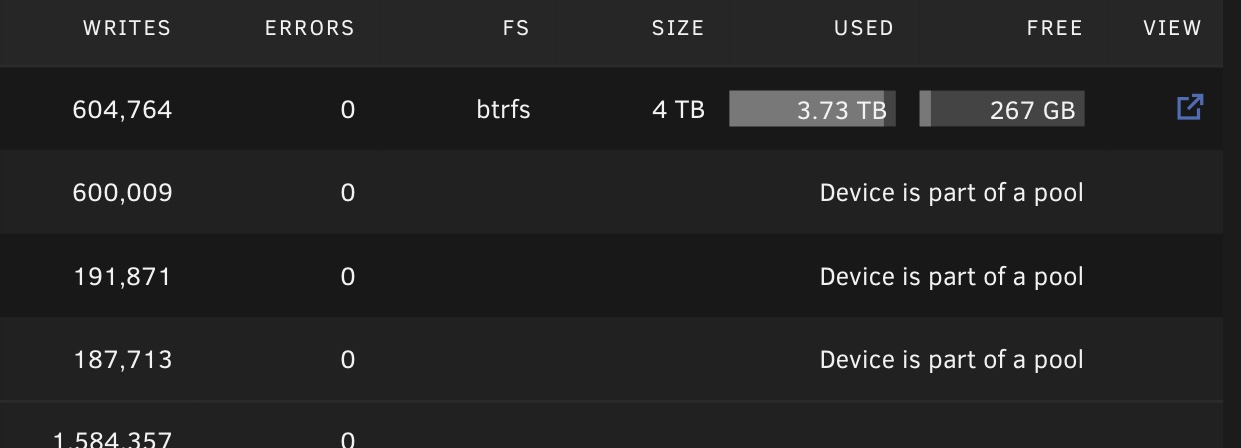

February 19, 20233 yr I apologize in advance if I'm asking for help on a common problem, I couldn't find the right answer in my searches. I am struggling with getting my cache pool to move correctly. My cache pool keeps filling up and won't empty even when mover is running. I have mover set to run every hour if the cache pool gets above 50%, but It will just continue to fill and not empty until a random point in time or if the server is restarted. I understand that "Prefer" will keep all the files from that share on the cache until it fills and "Yes" will write to the cache first and then dump to the array once it is full or mover invoked. I've checked my share sizes and everything with "Prefer" only adds up to a couple hundred GBs. After checking the size of all my shares going into the cache, it appears that my media files being downloaded go in and don't move out. My cache pool is four nvme drives at 2 TBs each, so it is pretty large and quick. What am I missing? I've attached my logs. While looking through them I did notice this error "emhttpd: error: get_key_info, 567: Invalid argument (22): stat: /boot/config/Trial.key" I'm not sure why I'm seeing that, but I'm assuming it is unrelated. Edited February 20, 20233 yr by Macj72x

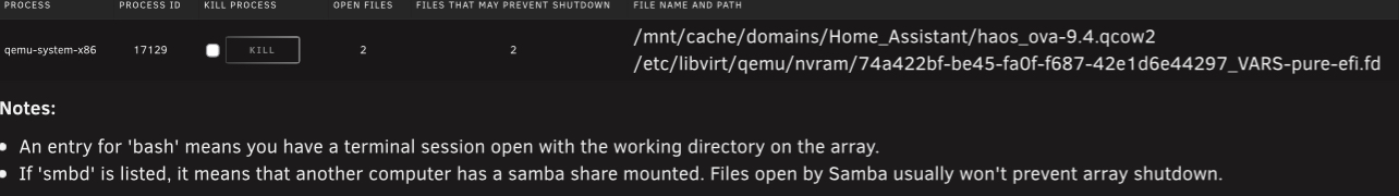

February 19, 20233 yr Author While I still would like to know if I’m using the cache pool in a way that isn’t recommended, I still think something else is wrong with my mover or the way it is configured. I’ve turned off docker. I now only have my Homeassistant VM running. I’ve checked my open files and it doesn’t appear that I have anything with my media files open. After this, I’ve invoked mover and it has been running for over and hour and has hardly moved anything. I started with about 250gb space remaining and am now at 267gb. Any guesses where to start?
February 19, 20233 yr Community Expert Your "default shares" have some files on the array. https://wiki.unraid.net/Manual/Shares#Default_Shares Usually you want these all on fast pool (cache) so Docker/VM performance isn't impacted by parity, and so array disks can spin down since these files are always open. But you don't have space to move them to cache currently. Set them to cache:only so mover will ignore them for now until you make space on cache for them. I'll leave it up to you if you want to keep those other cache:prefer shares on cache. Currently they are all on cache with nothing on the array. Run mover to get your cache:yes shares moved to the array. Then post new diagnostics and we can work on your default shares. You can see how much of each disk is used by each user share by clicking Compute... for the share on the User Shares page, or the Compute All button.

February 20, 20233 yr Author 56 minutes ago, trurl said: What do you get from command line with this? du -h -d 1 /mnt/cache 27G /mnt/cache/appdata 49G /mnt/cache/domains 71G /mnt/cache/system 0 /mnt/cache/temp 3.3T /mnt/cache/data 50G /mnt/cache/backups 3.5T /mnt/cache Mover seems to be moving now that both docker and vm is off, but it wasn't earlier in the day when just docker was off. Like I said earlier, the only vm I'm running right now is Homeassistant which shouldn't be touching my media share.
