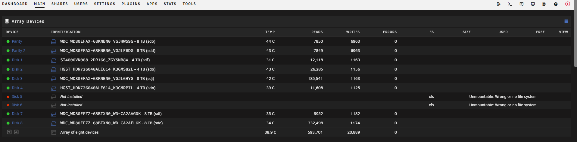

Drive 5 and 6 don't show as emulated though. They just show as not installed. did I miss something somewhere?
They are emulated and missing. Since you have dual parity, you can emulate 2 disks that are disabled or missing. And, it shows the emulated filesystems are unmountable. Also, mouseover the red x.

Now, start array in Normal mode, still nothing assigned as disks 5, 6, and post new diagnostics
Emulated disk5 mounted with 1.7T contents. Let's see how much in lost+found after repair.
 Emulated disk6 mounted with 2T contents. Let's see how much in lost+found after repair.
