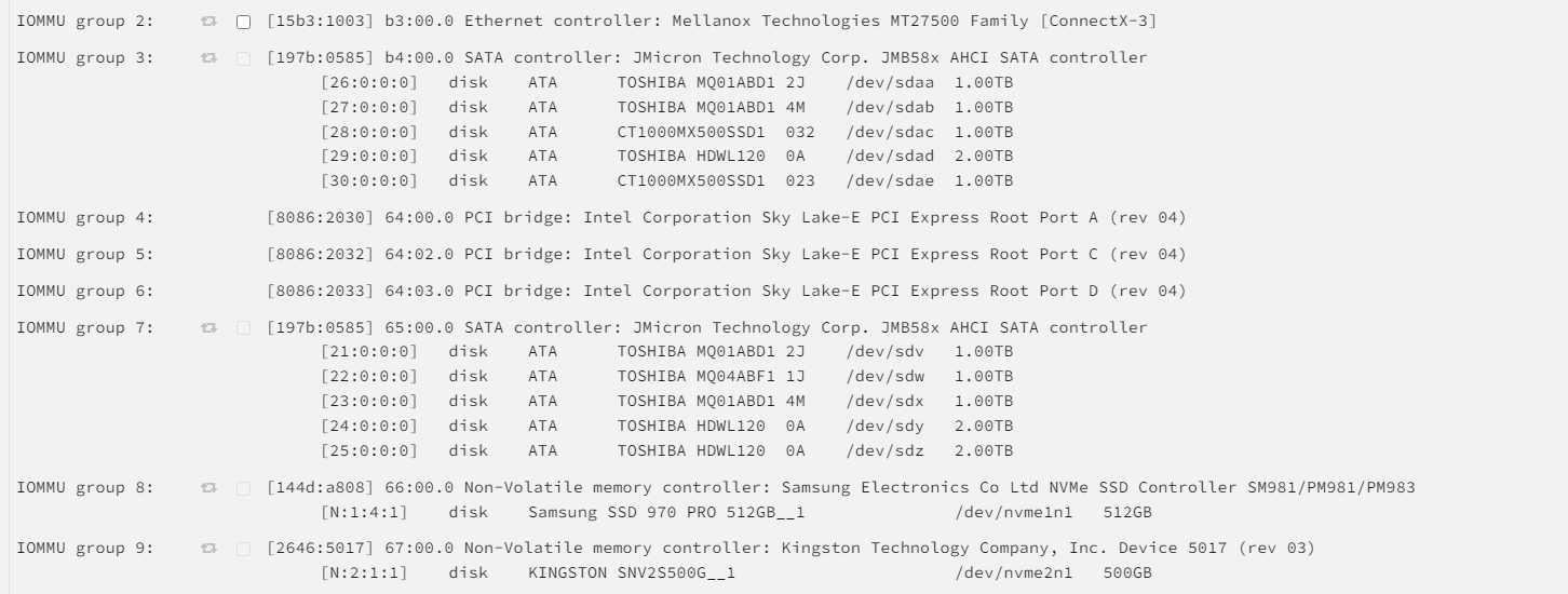

I have one those boards and quite happy with it for NAS use only, but IOMMU groups are not great, so if you want VMs with device pass-though would recommend equivalent Intel platform, like the X11SPL-F, much better IOMMU groups.

I bought mine used from Ebay at around the same price, X11SPL-F cost me 229€ (about 1 year and a half ago), H11SSL-i rev 2.00 195€ (about 1 month ago), CPUs were also about the same 200€ for a 10core Xeon and the same for an 8 core Epyc Rome, plus 220€ for 128GB REG ECC DDR4 2400 for the Intel and 400€ for 128GB REG ECC DDR4 3200 for the AMD (this latter one I bough new since couldn't find any good deals for 3200MT/s RAM).

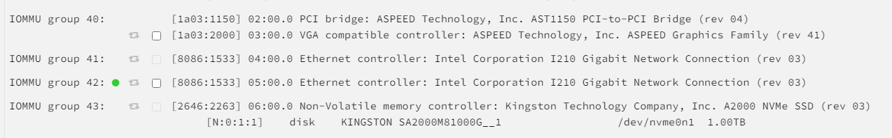

Regarding the IOMMU groups it's known that AMD is usually not as good as Intel for device pass-through, both with desktop and server hardware, so we generally recommend Intel for that, doesn't mean the AMD won't work for what you want, but it might not work or be more difficult to get working, with this particularity board model I meant that comparing with equivalent Intel model where most devices are in their own IOMMU group, including bifurcated NVMe devices installed in the same PCIe slot:

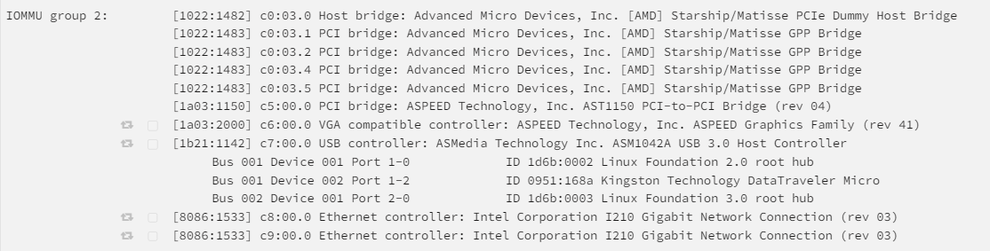

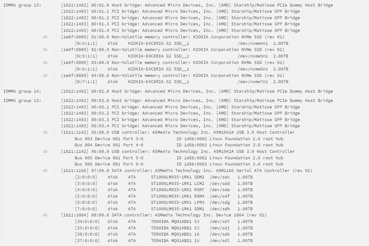

For the AMD system, multiple add-on SATA controllers and onboard USB controller share the same IOMMU group, bifurcated NVMe devices are also in the same group:
Even the dual onboard NICs on the AMD share the same group (together with more stuff), that also doesn't happen with the Intel:
