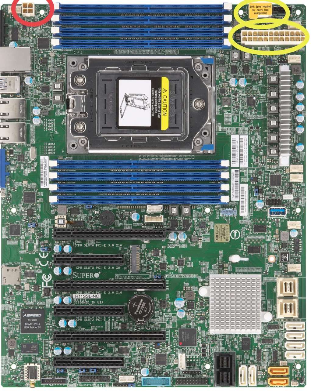

I’m building an Epyc 7302P Supermicro H11SSL-I motherboard and I’m not getting any activity at all. This is my first build with server grade hardware.
I attach the large motherboard connector and the 8 pin at the top right. I connected the switch pins at the bottom. Installed the 7302P CPU, cooler and RAM (micron 3200mhz registered pc4 memory). No lights, fan spin or anything.
Is the 4 pin (red circle ️ in photo) required?
Am I missing anything?
Almost certainly. While i know nothing about this board in particular I have never known a motherboard with optional ATX power sockets.
Edited by primeval_god
Nope, it should be used for high TDP CPUs, I'm not using it for an 8 core Rome.
I am trying to locate a CPU power cable splitter locally but I might have to order online.
Unlikely that the lack of that cable is the problem.

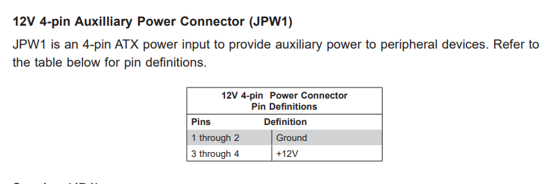

And let me correct myself, from the manual:
So it's not for the CPU, it should be used if there are a lot of high power PCIe controllers/GPUs.
Do these boards have the long post while it checks the memory?
Does that mean I should plug in pcie power into it from PSU?
It's fairly quick, much quicker than my Intel Supermicro boards, it doesn't beep though, I believe the beep is only for CPU overtemp.
No, it's not the same, you could use Molex to 4 PIN, but like mentioned it's not required, I have all PCIe slots occupied and am not using it, but don't have any no GPUs, 3 GPUs alone could use use up to 225W from the PCIe slots.

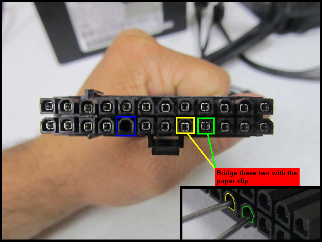

Took the board out and zero activity from board.  Shorted power pins briefly; no lights on board or IPMI no fan spin. Did a bios reset and still no luck.
10 hours ago, Pstark said:
I forgot to mention that I have a smart plug that measures power usage and it reads 1W while it should be booting.
So back in basic troubleshoot step, check PSU first, unplug all cable, short power on, and check does PSU working.
Or use another mobo to test the PSU.
Edited by Vr2Io
PSU was working when I pulled it from the old setup. I did the short the pins on the mb connector and it powered up fine.
Can I short the those same pins to power up the PSU while it connected to the board? Will that damage anything?
I wouldn't if it were me. Isolate the PSU, so the only thing connected is the power cord, that way if the PSU is faulty it can't hurt anything else.
In general, it won't damage anything if PSU in normal condition. The problem for my understanding is mobo haven't turn on the PSU. ( In step 1 or 2 haven't in step 3)
1. PSU provide 5v standby power to mobo.
2. Mobo signal PSU to power on.
3. Mobo got power-good signal from PSU, then perform reset/init/bootong.
Even no CPU RAM, mobo will signal PSU on as usual. So I would suggest you could remove the CPU and RAM.

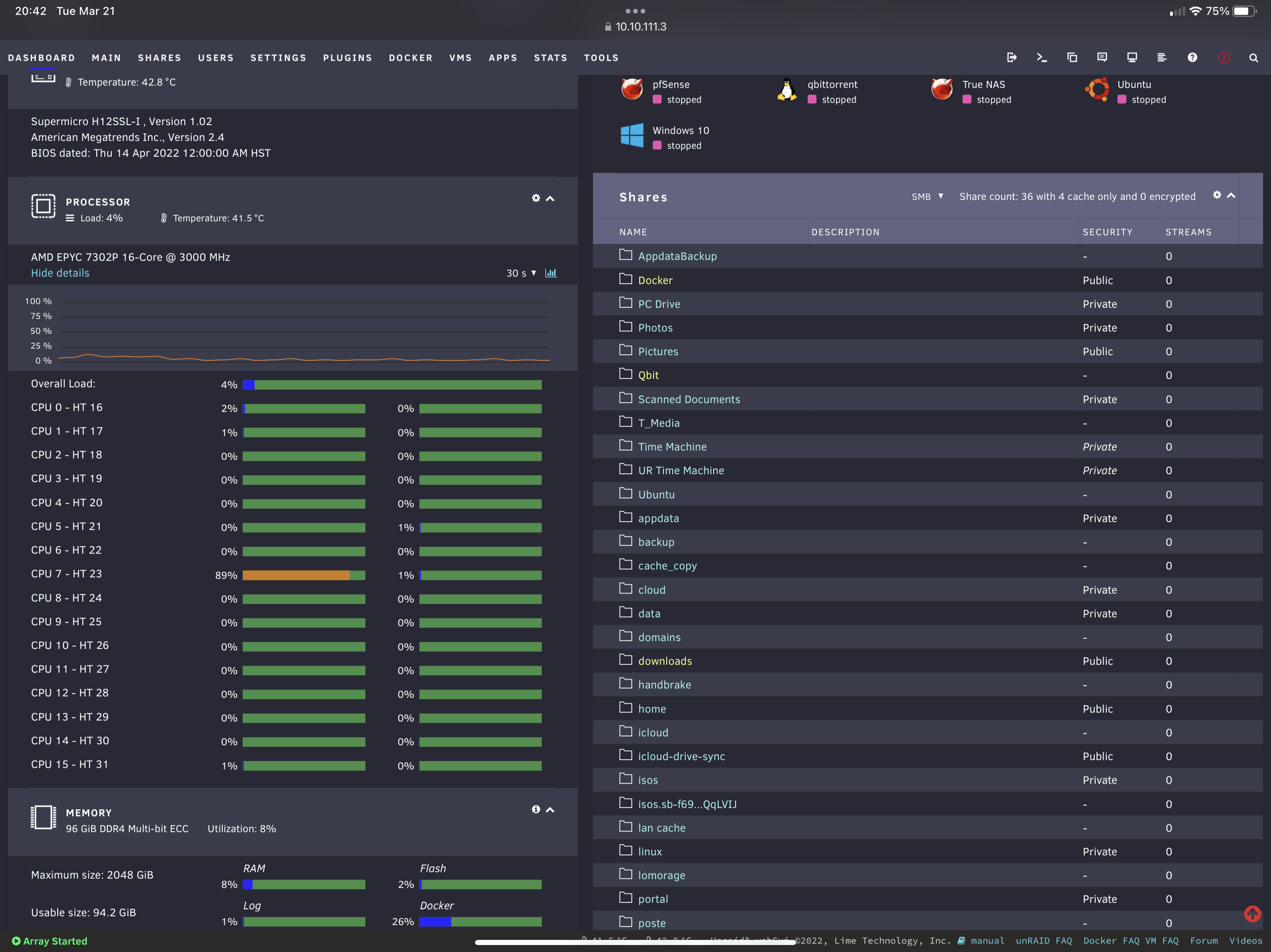

UPDATE/SOLVED
Received my new Supermicro H12SSL board and surprise…. Booted without issue (other then a faulty SATA power splitter).
All those cores!!!
Edited by Pstark
