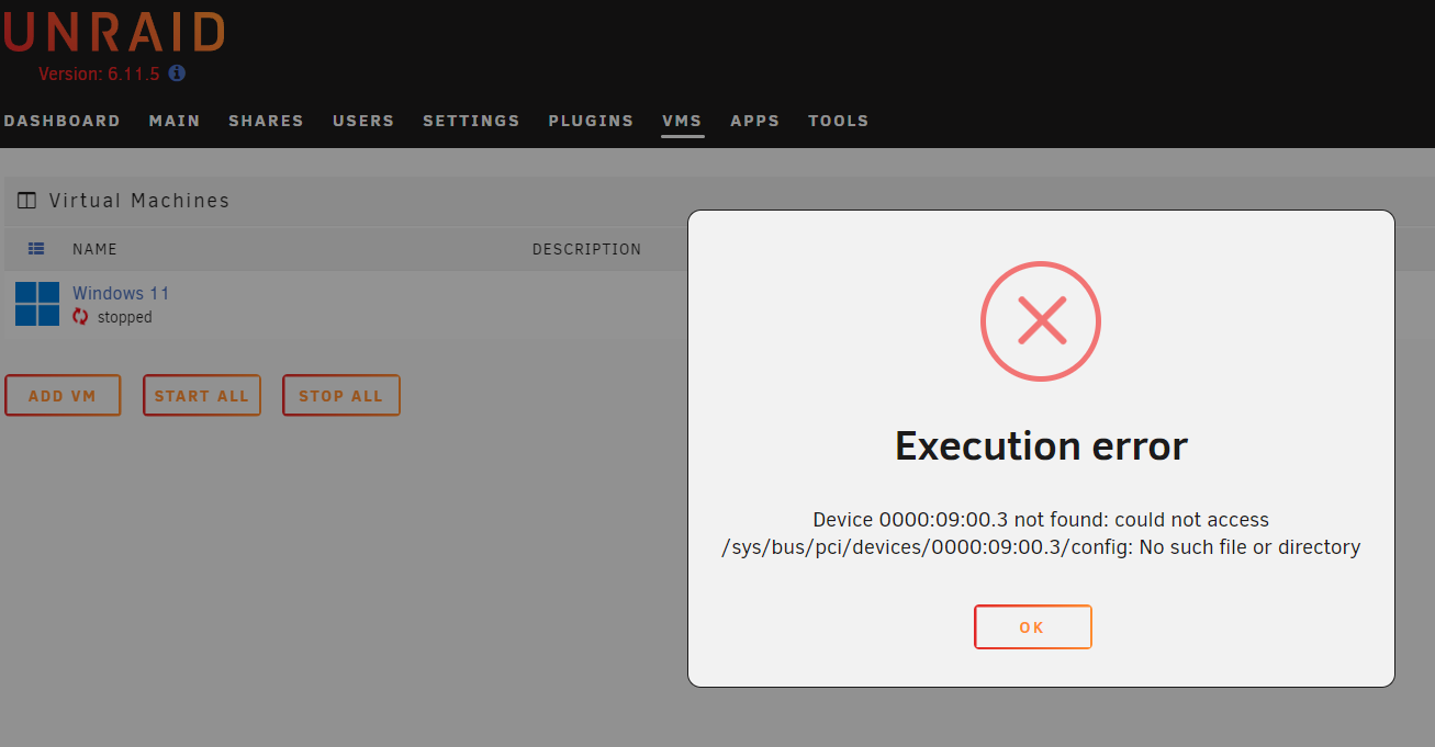

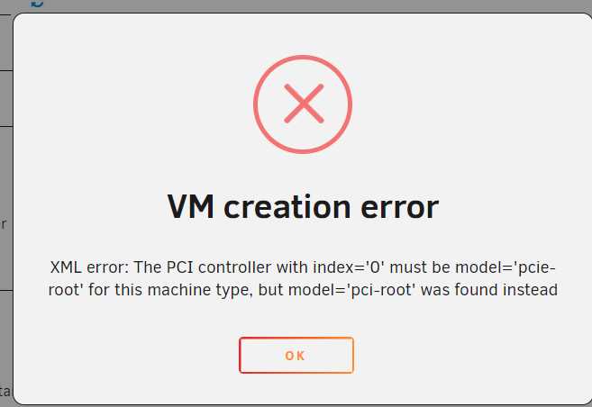

I have an error with my GPU Virtual Machine installation.
When I start the VM the server gets a Black Screen and doesn't come back.
In VNC mode it works fine!
I do all the recommended steps, including on other youtube channels.
I changed RTX 3060 for GTX 1660s and the error persists, imagining that it could be a mistake with the 3060.
I tried to login with Google Remote Desktop and the VM run but,
Too much lag and the GPU recognized but with error, and executed with Basic Microsoft Video in a fixed resolution 640x480p.
And when I try to install the driver, it returns the message that "The best driver is installed"
and it does not allow to update driver
Can Support help install the VM correctly to work with nVidia GPU?
Thanks
Edited by HTO
Have you tried specifying the vBIOS file for the GPU?  There's a video here
I was unable to dump my own as the script wouldn't recognize my card. But I was able to get the copy online and edit with the hex editor but it still didnt work
I make this and i have this errors now
Are you able to post a copy of system devices?

You only have 9.0 and 9.1 not 9.3 where did that come from?
IOMMU group 18:[10de:2503] 09:00.0 VGA compatible controller: NVIDIA Corporation GA106 [GeForce RTX 3060] (rev a1)
[10de:228e] 09:00.1 Audio device: NVIDIA Corporation GA106 High Definition Audio Controller (rev a1)
I dont know where come this 09:00.3 in error print...

-tpmdev emulator,id=tpm-tpm0,chardev=chrtpm \
-device '{"driver":"tpm-tis","tpmdev":"tpm-tpm0","id":"tpm0"}' \
-device '{"driver":"usb-tablet","id":"input0","bus":"usb.0","port":"1"}' \
-audiodev '{"id":"audio1","driver":"none"}' \
-device '{"driver":"vfio-pci","host":"0000:09:00.0","id":"hostdev0","bus":"pci.0","addr":"0xa","romfile":"/mnt/user/isos/vbios/rtx 3060 12g.rom"}' \
-device '{"driver":"vfio-pci","host":"0000:09:00.3","id":"hostdev1","bus":"pci.0","addr":"0xb"}' \
-device '{"driver":"vfio-pci","host":"0000:09:00.1","id":"hostdev2","bus":"pci.0","addr":"0x6"}' \
-device '{"driver":"vfio-pci","host":"0000:0b:00.4","id":"hostdev3","bus":"pci.0","addr":"0x8"}' \
-sandbox on,obsolete=deny,elevateprivileges=deny,spawn=deny,resourcecontrol=deny \
-msg timestamp=on
libvirt:  error : libvirtd quit during handshake: Input/output error
2023-04-14 14:08:58.683+0000: shutting down, reason=failed
you need to remove the hostdev for this part from xml.
where i find XML to edit it?
Can help, im new in Linux plataform and this is my first contact with this.
Edit VM then change to form view.
Scroll down until you find the section
      <driver name='vfio'/>
      <source>
        <address domain='0x0000' bus='0x00' slot='0x02' function='0x0'/>
      </source>
      <address type='pci' domain='0x0000' bus='0x00' slot='0x02' function='0x0' multifunction='on'/>
    </hostdev>
that has source bus = 9 slot = 0  function = 3 and remove that hostdev section.
      <source>
      </source>
    </hostdev>
This error is gone...
I can start VM, but, still in Black Screen
The black screen still there
Thanks for you helping in this situation but, the error still there
Edited by HTO

try adding this video=efifb:off to the append statement in syslinux, you can get to it by clicking on flash in main, example below, just add to end of append line yours may be differnet. You will need to reboot.
label Unraid OS
  menu default
  kernel /bzimage
  append initrd=/bzroot pci=noaer pcie_acs_override=downstream,multifunction  video=efifb:off
If the above doesn't wok try without the vbios and/or using machine type Q35 as an option?
label Unraid OS
  menu default
  kernel /bzimage
I try "video=efifb:off" but dont work
When i try change to Q35 new error apear and cant change
