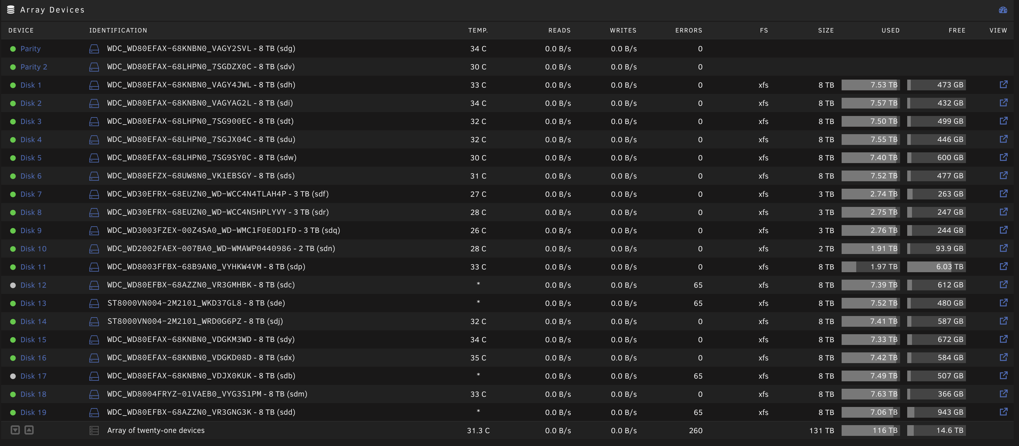

It also looks like two of the 4 disks are stuck in standby mode, but I can't see any of the smart attributes for either of the 4 disks. You can see in this screenshot.
I dumped the diagnostics logs again and shut the server down. All 4 drives with issues are in the same row and use the same backplane. So I'm thinking that the backplane has gone bad and that might be the issue. Problem is I have a NORCO RPC-4224 case and the company has gone under. Seems like there are a lot of problems with backplanes dying and taking drives with them. Maybe I should move to a new case and be done with this one.
