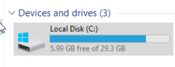

I have aloted 30gb to my vm. I plan on running Blue Iris on it eventually. But after installing Windows 10 Pro, I'm only getting 6gb free out of 30. What am I missing. Still new at unraid and vms. Thanks

Windows update will fill that space rather quickly. If you can't give the VM more space, maybe try using one of the "Lite" windows installs with all the extra junk stripped out.
Completely normal. 30gig is way too small to be useful for windows.

My bad. I was sleep deprived and meant to make the drive 3tb. Thanks
Proper advice is to keep the OS vdisk small (40ish GB) and have the footage be stored on a network share that would be an unraid user share).
You can disable things like hibernation and pagefile (if you have enough RAM allocated to the VM) to reduce OS disk space usage.

How large is the pool you have assigned for domains?
I've allocated 16gb and the footage saved to a network share.
