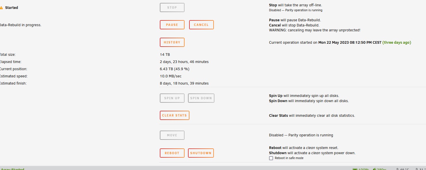

Do you have an option in the GUI to cancel the rebuild? Syslog shows the rebuild finished but other diags show it's still going, kind of strange.
it's been like that since yesterday. I kown it's finished, there is no more disk read / write but I'd like to stop the array and shutdown to change HDD
Click reboot and post new diags after array start.
