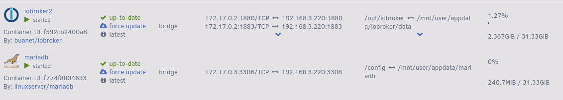

 Is there anyway to see wich container causes the problem? Yesterday I got the same error again "Out Of Memory errors detected on your server".
The docker tab suggest, that there is no max memory allocation set:
Every docker seems to have the whole 32gb available
Edited by bubiman

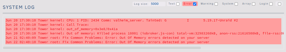

I found the docker that is causing the problem:
but right now I don´t know why this problem occurs. There seems to be pleanty RAM available

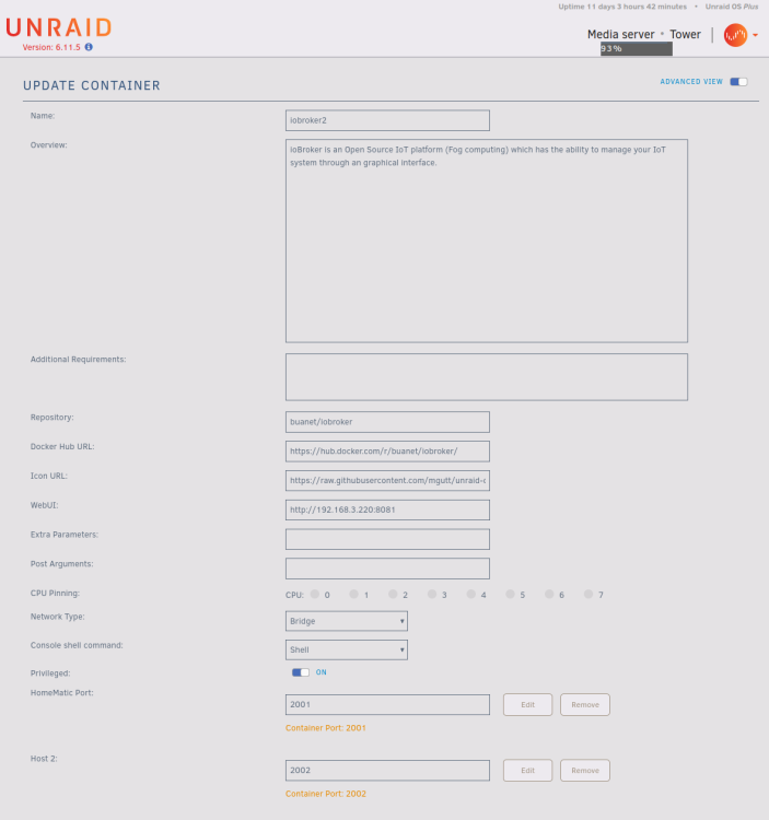

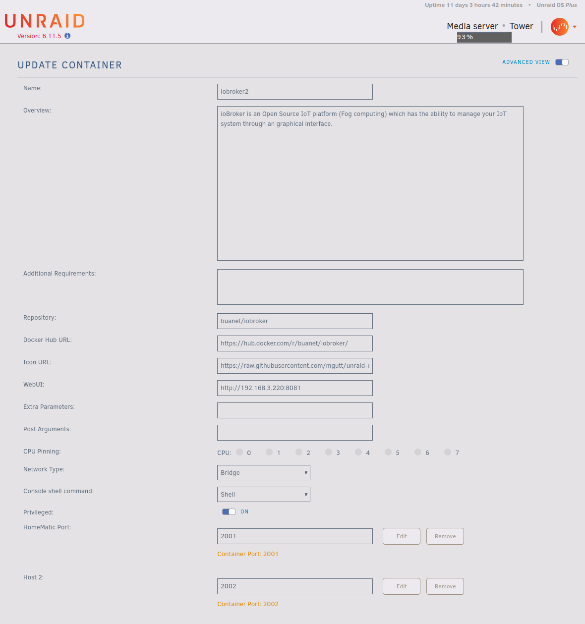

Go edit the template for that container, enable advanced mode, and see if a max ram amount is defined in the extra parameters.
There is no parameter set to limit the RAM amount:

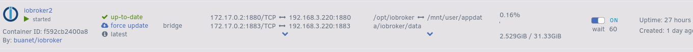

This also suggests that RAM is not limited:
Then iobroker is probably occasionally crashing and filling up the entire RAM and getting killed. You could add "--restart=unless-stopped" to its extra parameters, and install netdata. After it happens again watch netdata and see if there was a spike in RAM usage in this or another container.
