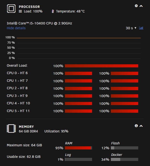

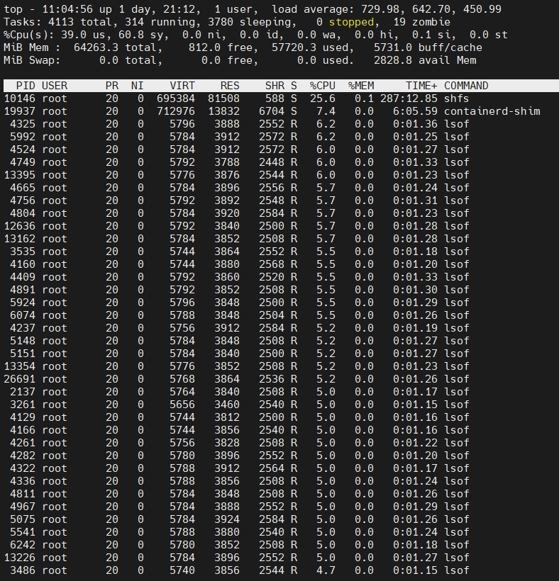

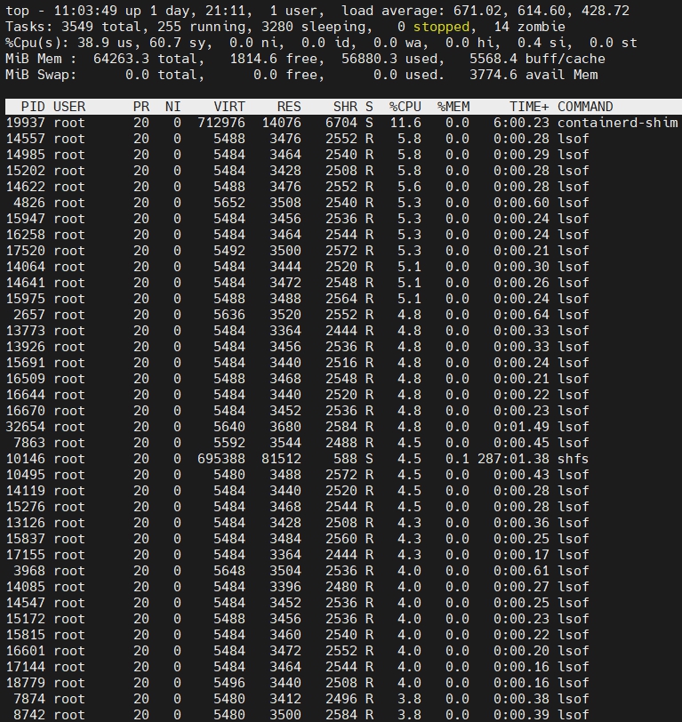

June 20, 20233 yr Hi, in the last couple of weeks I've noticed massive CPU usage spikes, which is bringing my server to a stand still. I pretty much have to reboot the server as even after 1-2 hours it won't recover from the CPU usage spikes. This appears to have happened after updating from Unraid 6.9.2 (after staying on it for ages) to 6.11.5. I noticed that 6.12.0 is now out, so I am happy to update and see if that will help. But, I was wondering if anyone has any ideas of what may be causing the issue or what I can try to fix it? See attached diagnostics and a few screenshots. Thanks spaldounraid-diagnostics-20230620-1108.zip

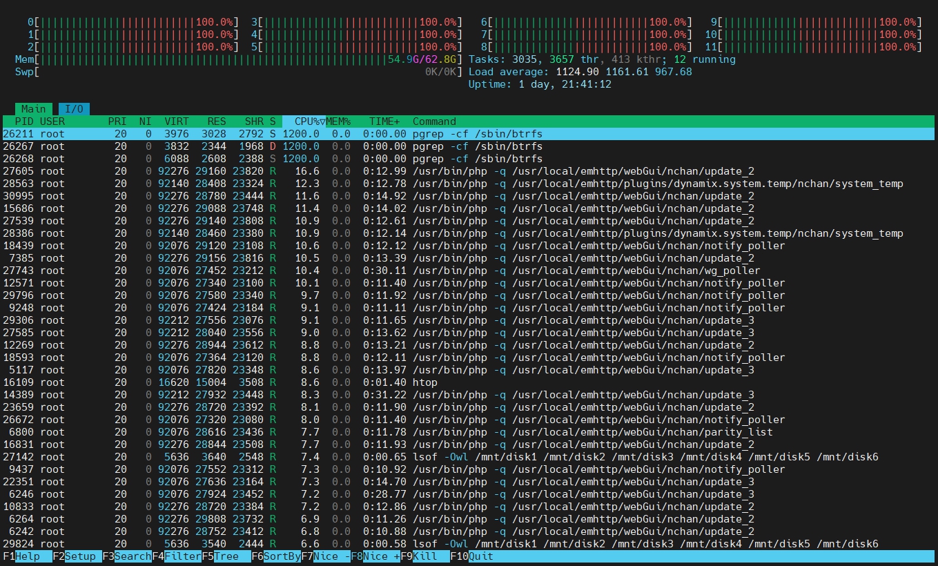

June 20, 20233 yr Author I've found a few similar topics, so I am trying ideas in those as well. See attached updated process list using htop.
