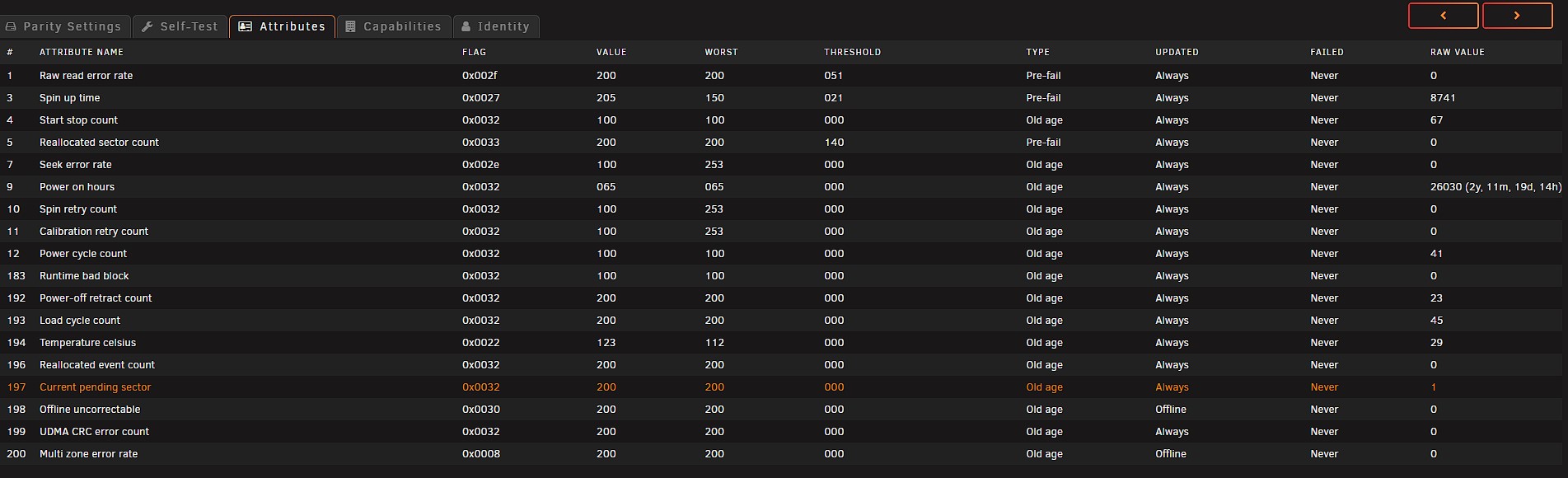

So I already as you may have guessed replaced the old 1.2 parity drive with a 4TB one. Today now on my 8th 4TB drive my parity drive threw a smart pending sector count error. It is only 1 right now and the reallocated sector count is still at 0..... So I humbly ask what is your opinion of this do you think I am screwed.... I have about 6 hours of the current parity rebuild. I was thinking after this parity rebuild to replace that parity drive with a new on and rebuild again. Any consern about something messing up at that point? What do you think I should do/best couse of action?

12 hours ago, Sh3rL0cK said:
ParityWDC_WD4000F9YZ-09N20L0_WD-WMC130117163 - 4 TB (sdal)
Run an extended SMART test, it will confirm if the pending sector is real or a false positive.

Jorge,
Any issue you think with just swaping it out? I purchased 2 new 8TBs that I wanted to upgrade to. I know I need to swap the Parity out first so could I just do it now and not worry about this?
You can do that.
Thanks for the help! Parity drive swapped out and rebuilding 21 hours to go
