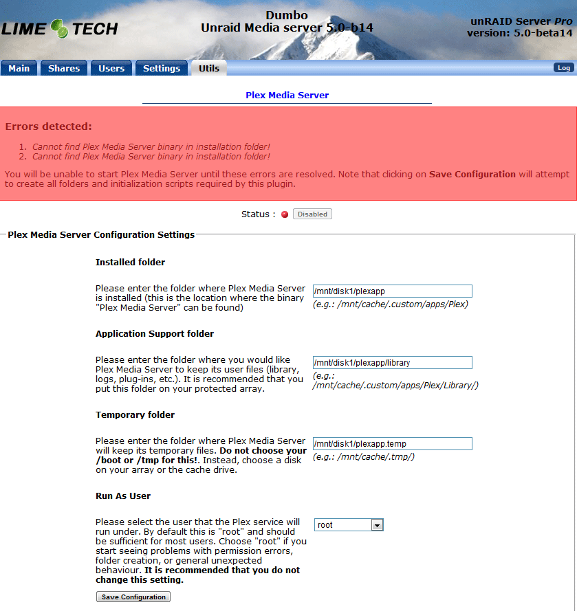

Inside the unRaid web GUI, Plex appears under two tabs. It has an icon under the Settings tab, and another one under the "Utils" tab. Each icon goes to a different style of control for the media server. I have a hunch that there's only supposed to be one...
Under the "Utils" tab > Plex Media Server, I've updated all my directories to the ones I mentioned above. I get a big pink banner across the top: "Errors detected:
1. Cannot find Plex Media Server binary in installation folder!
You will be unable to start Plex Media Server until these errors are resolved. Note that clicking on Save Configuration will attempt to create all folders and initialization scripts required by this plugin."
When I hit Save Configuration, after putting all the correct folder paths in there, I still get the same error, but it looks like this:
"Errors detected:
2. Cannot find Plex Media Server binary in installation folder!
I suspected it was a permissions problem.
root@Dumbo:/mnt/disk1# chmod -R 777 plexapp
Still come up with the same error.
Also I've noticed that the Plex server DOES start up using the unRaid Web GUI "Settings" tab, but even with the correct path to the library, it starts up with an empty library and settings from my old installation. (/mnt/disk1/plexapp/library)

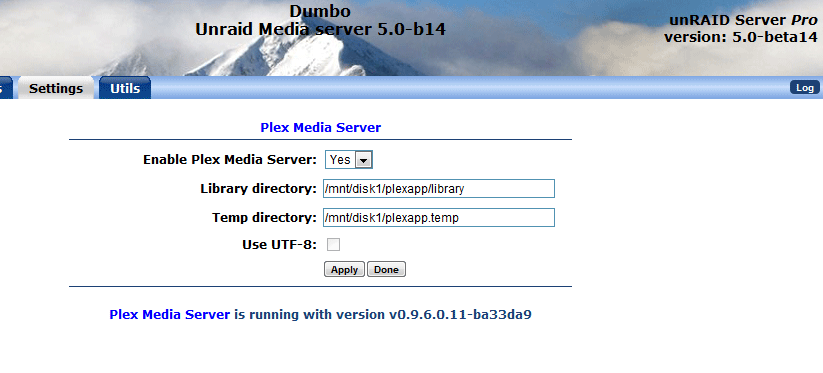

I am able to run the PMS from webGUI > Settings > PMS Server box, but I'm not able to do much from the webGUI > Utils > PMS Settings.

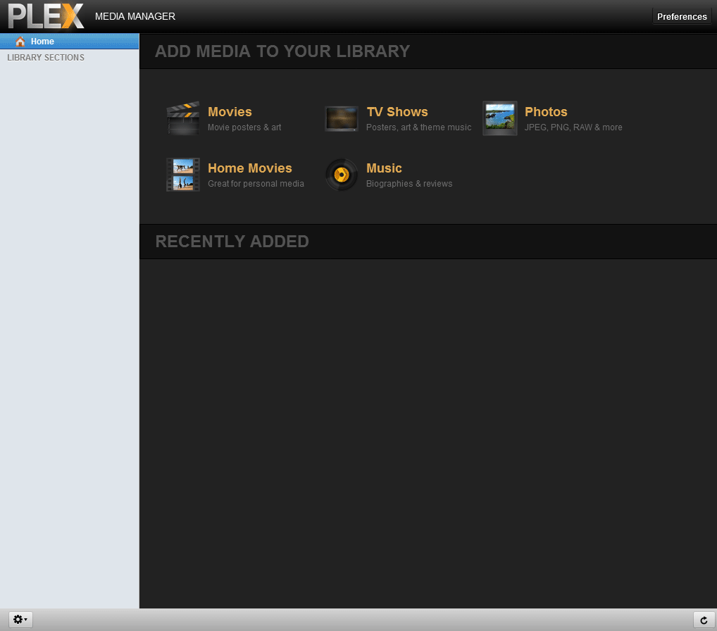

PMS is running, but my libraries are gone. There are no files in the /mnt/disk1/plexapp, and not much in any of the sub-folders.

root@Dumbo:/mnt/disk1/plexapp/library# /etc/rc.d/rc.plex version
v0.9.6.0.11-ba33da9

So, how can I get this puppy to realize I already have a library built up in:

I'm able to get PMS running from your plugin Settings > Network Services > PMS, but no joy for the library.
you have to point to "/mnt/disk1/plexapp/library" on the webinterface.
Yup, I've got it pointed there, but still no joy with finding the library.
there has to be a structure like this:
root@nas:/mnt/cache/appdata/plex/Library/Application Support/Plex Media Server# ls -al
total 9
drwxr-xr-x  9 unraid-plex users  296 2012-04-15 21:27 ./
drwxr-xr-x  3 unraid-plex users   88 2011-11-02 20:47 ../
drwxr-xr-x  3 unraid-plex users   80 2011-11-17 22:03 Cache/
drwxr-xr-x  3 unraid-plex users  432 2012-04-15 11:49 Logs/
drwxr-xr-x  3 unraid-plex users   80 2011-11-01 17:37 Media/
drwxr-xr-x  6 unraid-plex users  144 2011-11-01 17:41 Metadata/
drwxr-xr-x  7 unraid-plex users  200 2011-11-01 17:52 Plug-in\ Support/
drwxr-xr-x 30 unraid-plex users 1072 2012-04-15 19:08 Plug-ins/
-rw-------  1 unraid-plex users  563 2012-04-15 21:27 Preferences.xml
drwxr-xr-x  2 unraid-plex users   80 2012-04-07 11:22 Scanners/
-rw-r--r--  1 unraid-plex users 1237 2012-04-01 12:53 dlnaclientprofiles.xml
That did it. I just had to move the directories by hand.
