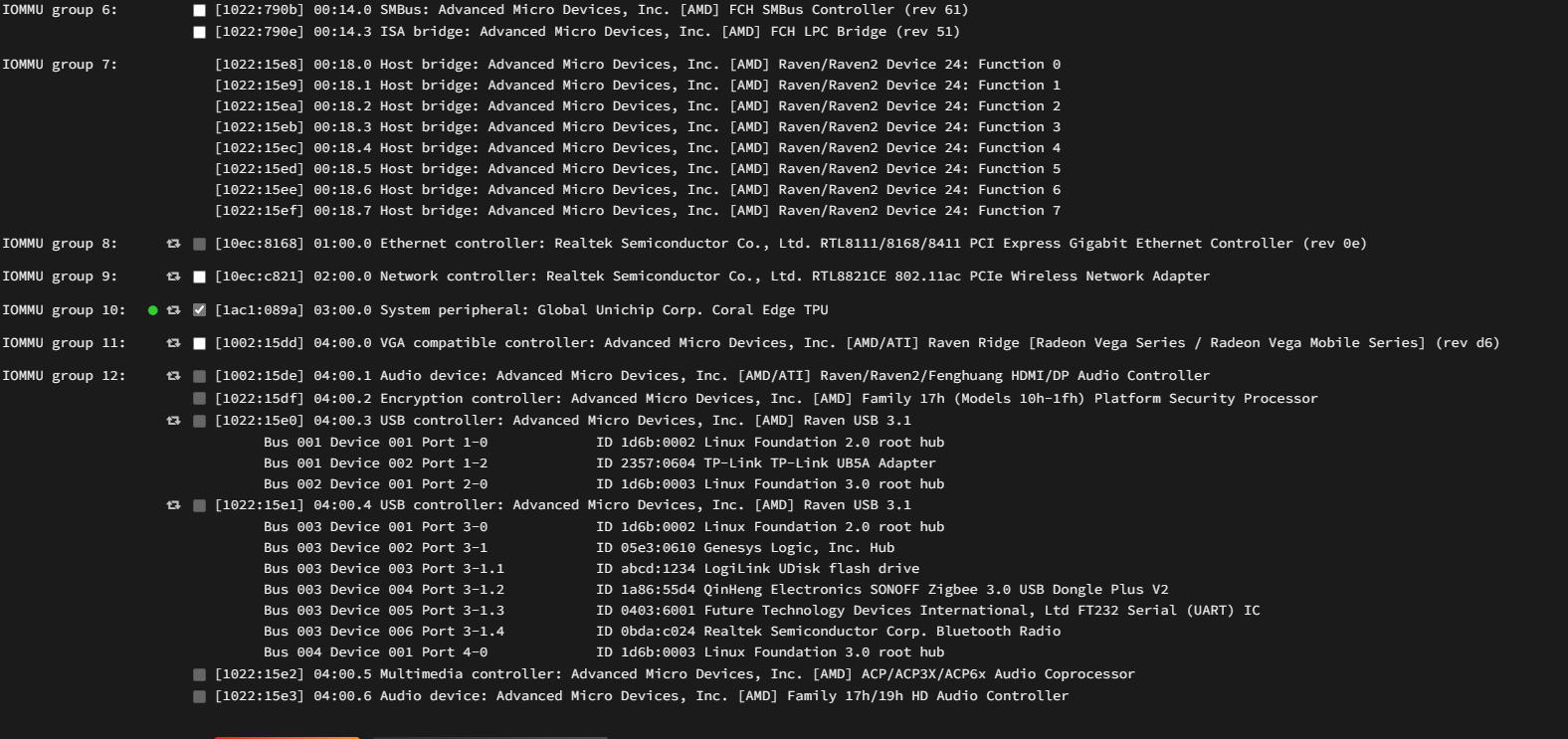

PCIe Passtrough "None Available"
Solved by SimonF
  • Replies 87
  • Views 9.7k
  • Stop vm, Edit xml and change to XML view via the slider top right    Make a copy of the XML before changing. Creating diagnostics will have a copy of the xml in it also.
  • Yes you can edit here /usr/local/emhttp/plugins/dynamix.vm.manager/include/libvirt_helpers.php   Around line 766 you could do this   if (in_array($arrMatch['id'], $arrBlacklistID
  • Thank You very much. This is working for me!
I tested proxmox and the pcie coral card appears??
It’s a shame that it’s so complicated on unraid

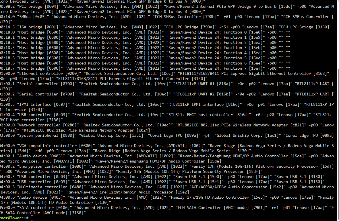

Can you run this command so you get this output. I will then check to see if it can be added as a valid type.
root@computenode:~# lspci -m -nn -s 03:00.0
03:00.0 "VGA compatible controller [0300]" "Intel Corporation [8086]" "DG2 [Arc A770] [56a0]" -r08 -p00 "Intel Corporation [8086]" "Device [1020]"
It's already been posted in a comment on the first page of this thread:
yes I saw that but it doesn't work or is it just me who doesn't know how to do it very well??

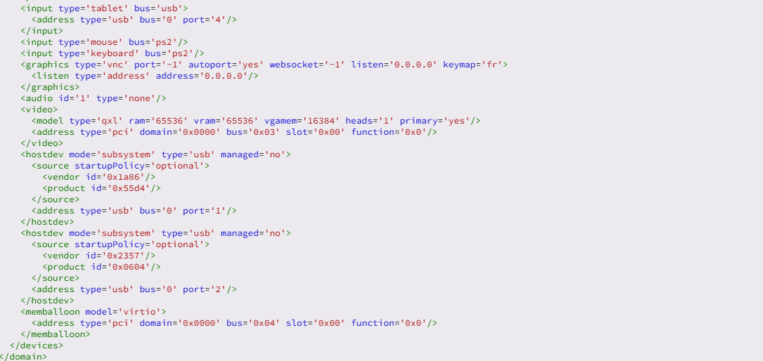

It does not work

I saw that this address is used

That is the address as it will be seen in the VM. For the TPU it will be address below. Do you have any errors in the VM log or pop ups? Is the TPU bound to vfio in the system devices on the tools menu?
      <driver name='vfio'/>
      <source>
        <address domain='0x0000' bus='0x03' slot='0x00' function='0x0'/>
      </source>
      <address type='pci' domain='0x0000' bus='0x05' slot='0x00' function='0x0'/>
    </hostdev>

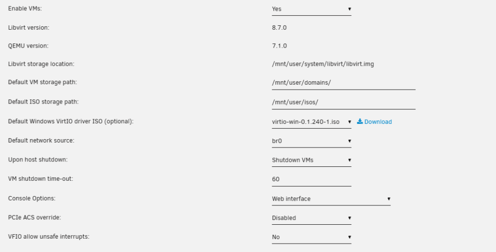

I don't have any error it happens but in the creation of the vm it is not in other pci
for info in vm manager I didn't check anything
11 minutes ago, sapphireone said:
It will not appear in the list, You might need to add back if you make changes in the gui.
I have made a PR to allow this to be seen in the next release.
Once you have added in the XML. Start the VM and it should be available in HA.
I hope the next unraid version will be much more

I come back, I spent too much time to make this pci card from Google Coral work on unraid so I switched to proxmox no problem it all recognizes its problem is I emulated unraid which coexists and it works very well
sollution for me was: in the terminal type: cd /usr/local/emhttp/plugins/dynamix.vm.manager/include  then: nano libvirt_helpers.php
now look for this line:         $arrBlacklistClassIDregex = '/^(05|06|08|0a|0b|0c05)/';    and remove : 08|
save the file and now the coral is visable
In the terminal type: cd /usr/local/emhttp/plugins/dynamix.vm.manager/include
save the file and now the coral is visable in the list to add to your VM.
