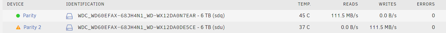

I am running 6.20 and disk 12 failed, this was replaced OK but in doing so Parity 2 was excluded.
I have omitted Parity 2 from the array, added it back and left it rebuilding.
It has got this point but progress has stopped being updated, however data is still being written to the Parity 2 drive
Also I have found that Disk 2 has dropped from the array again!
