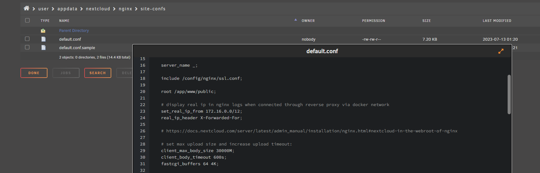

Hey,
i had the exact same problem with the same setup. For me the solution was:
Changing the client_max_body_size values in mnt/user/appdata/nextcloud/nginx/nginx.conf and mnt/user/appdata/nextcloud/nginx/site-confs/default.conf
Restart the docker and hopefully you will be good to go. I also ran in to a 504 error for gateway timed out after this fix since i was transporting pretty large files, so i changed the client_body_timeout value also in mnt/user/appdata/nextcloud/nginx/site-confs/default.conf
Changing the values in the Swag instance didnt seem to do anything. I dont know what you did in the php.ini file, but maybe change it back also.
After this all my files synced without problems! I still get some 504 errors after files finish syncing, but the files go through and do get synced even if the server displays errors.1130291975_Nyttkuva2023-07-13012113.thumb.png.a4147f6de0037a7e7e77b122af2e7ac6.png

Yes i am using the Dynamix file manager plugin, it gives you a bit more traditional file manager if you arent used to using the terminal. What ever you want to use is fine. The command for editing the files in the terminal would be:
nano /mnt/user/appdata/nextcloud/nginx/nginx.conf
nano /mnt/user/appdata/nextcloud/nginx/site-confs/default.conf
Hey Rapt,
I can confirm this has fixt the issue for me!
THANK YOU ETERNALY!!
My issue was that i could not find those locations in my system.... I tryed lots of different "copied" text strings but none were found. Your ones worked for me and i just updated the max client body to 10240M.
I think i will be tryiong out Dynamix file manager plugin as well, i think this will make it easier for future changes.
Thank you again Rapt - Legend!
