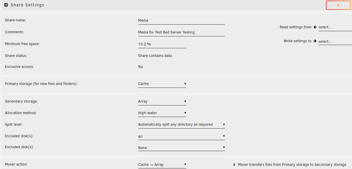

I don't know if it is really that clear yet as this 'new' usage of terms is concerned.  I point out this section of the release notes in the Documentation:
     https://docs.unraid.net/unraid-os/release-notes/6.12.0#share-storage-conceptual-change
This are a couple of screen shots from my 6.12.3 Unraid server:
and
I will point out that both of my servers are basically NAS setups with a single cache drive as the Primary storage and an Unraid array as the secondary storage.  I seem to recall that they decided not to change the notation of 'Cache' and 'Array' for existing setups.   I can't recall what was done for those more complex setups having multiple drives in ZFS and BTRFS configurations.
It is my opinion that this mixing of terminology is going to be confusing---  at least in the short term and to the casual/new user of Unraid.  It might have been preferable to change the designation for the 'Unraid Array' to, say, 'UnArray'.   One thing that needs to be done (In my opinion) is for @limetech  (or one of the Unraid staff) to generate a table of terms that they are going to be using to describe/define all of the various configurations and add as a section in the Documentation.  I really don't care what things are called as long as I know exactly what the term defines.
