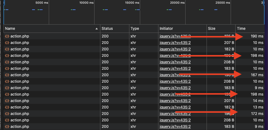

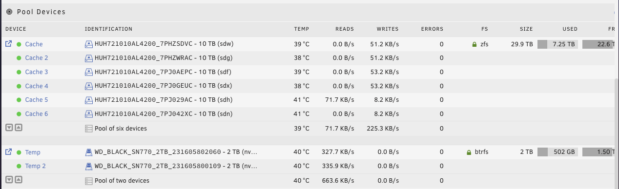

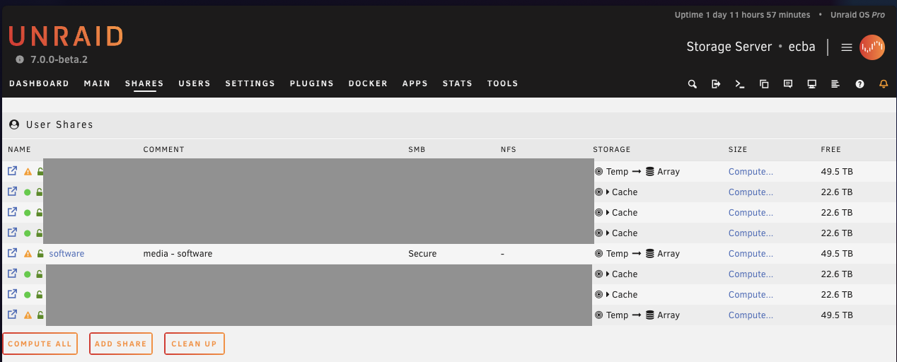

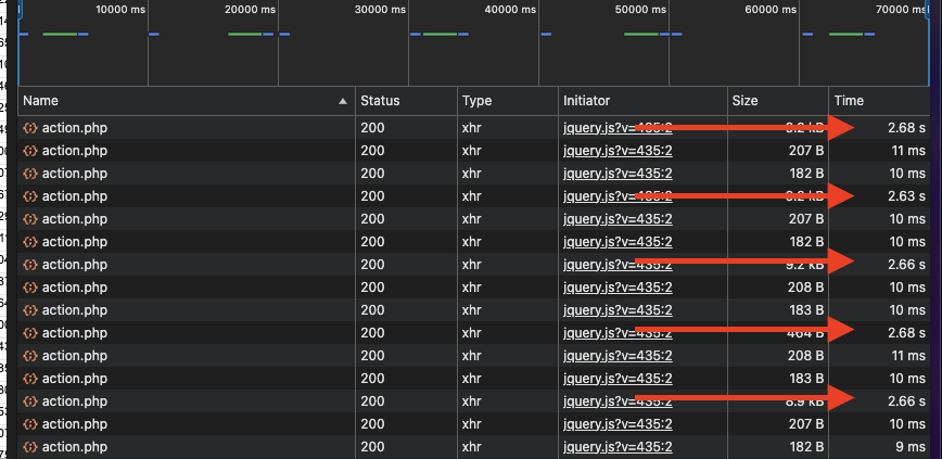

Just to tell the story of what I am encountering, visually. This is how I can dynamically recreate this problem. Note: Neither cache or temp pools have any files for the software share. Not even the folder. Everything is on the Array currently. But now when I swap the temp (btfrs) pool with the cache (zfs) pool: This result is reflected immediately after swapping the pools and it makes no difference if I restart the container or the entire machine. I'll see if I can replicate this performance drop in a container but outside of rtorrent and then see if that also can be replicated outside of docker.

I can confirm that a container mapped to an exclusive share on my mirror ZFS pool is extremely fast and responding in <200ms with 1000 torrents. There is definitely a weird interaction happening with zfs behind fuse, and it's not inherent to zfs (which I didn't expect anyway).

This doesn't happen when it's just the array (27 drives) or when the nvme cache drive as primary is formatted as btrfs. As soon as that same cache drive is formatted to zfs, the performance tanks, with no other changes.

I've been plagued this issue in both 6.12 and 7.0.0-beta.1/2 and I have finally narrowed down the exact configuration cause. In all of my instances of this docker container, I am mapping the root of one of my shares (R/W). Normally, the list action on the webui will take 700-1000ms to respond back but it's been take 10+ seconds and it's when any ZFS pool is configured to be the primary storage with the array being secondary. Here is the results of some configurations for this share that I've tried, where-in it's the ONLY change that is made: Primary: Array, Secondary: None - 700-1000ms response time Primary: single 2TB NVME encrypted btrfs, Secondary: Array - 700-1000ms response time Primary: single 2TB NVME encrypted zfs, Secondary: Array - 6000-8000ms response time Primary: 3x 2-Mirror 10TB encrypted zfs, Secondary: Array - 10000-12000 response time I have done testing with the cachedirs plugin and it does not affect these outcomes at all. I originally thought this was the cause because my zfs pool wasn't named "cache" at the time and the plugin only seems to cache /mnt/disk* and /mnt/cache, but later renaming the pool had zero effect. Now this is also when the zfs cache/primary drive is completely empty, it still affects the performance. I also tried with direct_io turned on and it had zero effect (though I didn't expect it to). I am going to be setting up a container to test whether this also occurs with the zfs pool as an exclusive share or if this is entirely cause by zfs behind fuse. I couldn't find any similar issues so I don't know if this is just extremely specific to whatever rtorrent is doing. I'd like to determine what exact command(s) are taking so long to return back when the share is configured this way, but that would be a whole other deep dive to get some proper profiling on the process because the debug logs didn't give me any useful information. ecba-diagnostics-20240715-1508.zip
