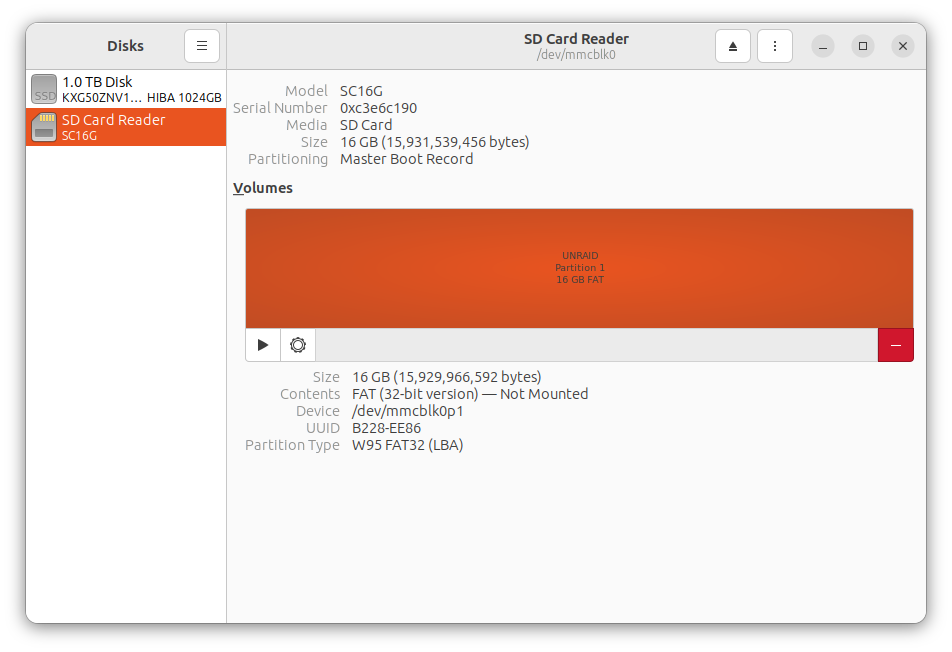

I looks like the script detects the device as `/dev/mmcblk0p`, omitting the partition number 1 after it.

Hi @jpmeijers, it seems from your screenshots that you are trying to install on a SDcard, not a flashdrive.
Could it be the reason ?
Yes, I was indeed installing to an SD card, because my HP ProLiant DL380p Gen8 has an internal SD card slot on the motherboard which I wanted to boot from. And yes I am aware of the caveats regarding this (reader GUID used).
The issue above seems to be that the `make_bootable_linux.sh` script assumes device paths that follow the `/dev/sdX#` pattern. If one gives it a `/dev/nvme#n#p#` or `/dev/mmcblk#p#` it fails.
The easiest thing to do would be to edit the script to use the actual device id type you have and see if that then works.
