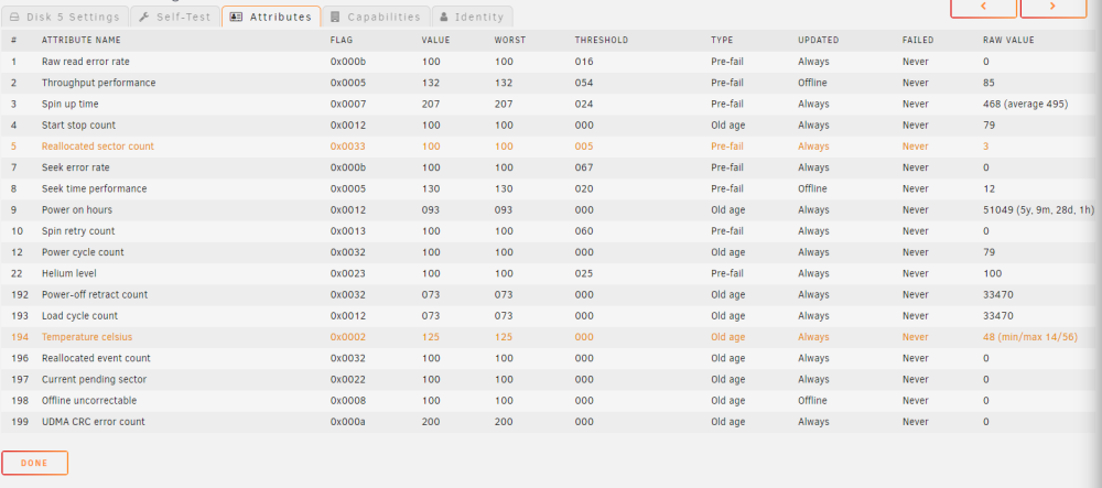

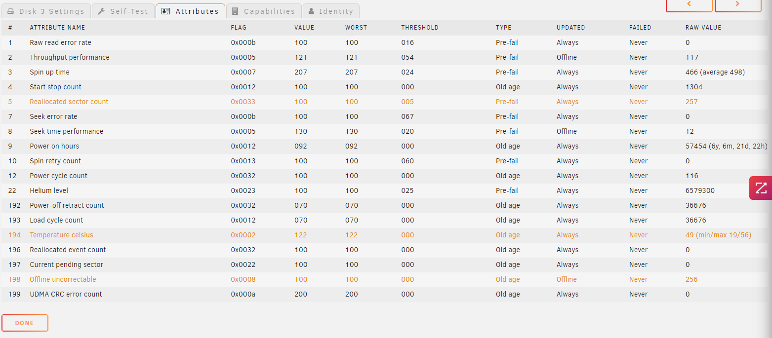

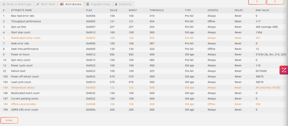

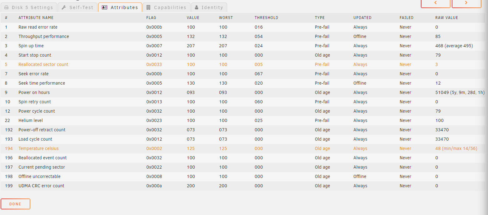

That said, are there any hardware diagnostics that can be recommended?  i.e. run a memory check (although I think that would show up in diags?), HBA controller check?  I do have a couple drives that had displayed errors (I'm currently replacing them over time as they fully fail).  Could the drives in partial fail state cause the server to crash?  (see attached SMART reports).
hunternas-smart-20230906-1100.zip hunternas-smart-20230906-1100.zip
