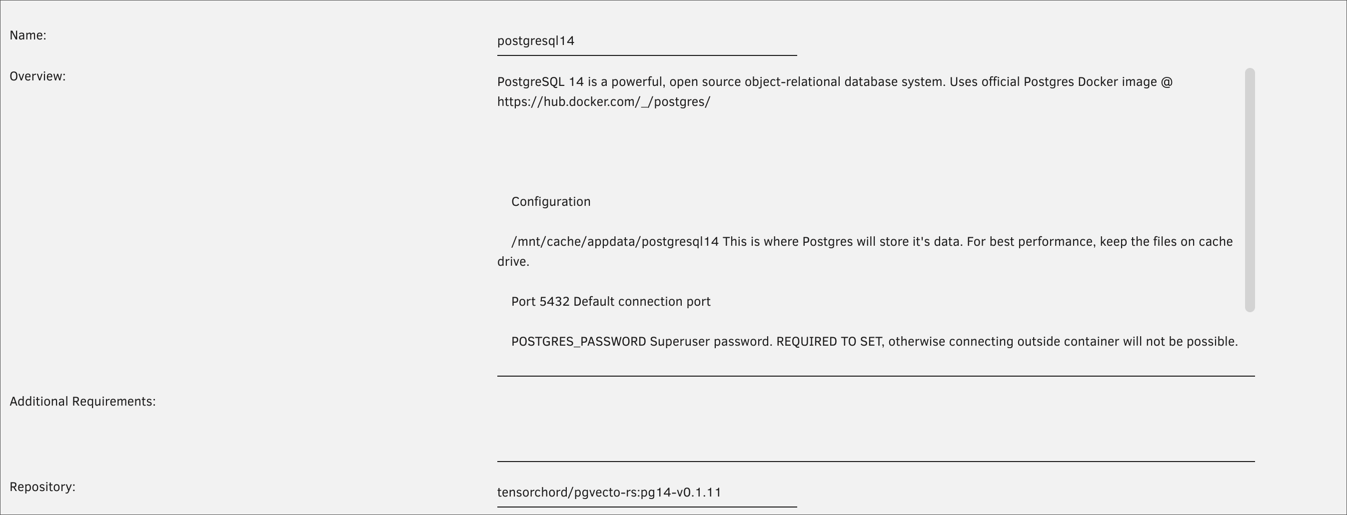

Solution captainfeeny Posted December 16, 2023 Solution Share Posted December 16, 2023 I ended up just changing the repository on the postgresql14 docker to: tensorchord/pgvecto-rs:pg14-v0.1.11. Then I restarted immich and all is good. See attached. The repository info was from here: https://github.com/imagegenius/docker-immich 4 Quote Link to comment

CapriciousCrawdad Posted December 17, 2023 Share Posted December 17, 2023 (edited) Info about this change can be found at this issue on the imagegenius github page. The suggested fix worked for my instance. I'm up and running again without any apparent issues. Edited December 17, 2023 by CapriciousCrawdad 1 1 Quote Link to comment

DrMac Posted December 25, 2023 Share Posted December 25, 2023 changing to tensorchord/pgvecto-rs:pg15-v0.1.11 fixed my first time install issues also. After I uploaded some pictures it stops and now my postgres log shows this: 2023-12-25 03:46:59.273 CST [925] FATAL: could not open file "global/pg_filenode.map": No such file or directory 2023-12-25 03:47:03.827 CST [66] LOG: checkpoint starting: time 2023-12-25 03:47:03.944 CST [66] PANIC: could not open file "pg_commit_ts": No such file or directory 2023-12-25 03:47:03.950 CST [1] LOG: checkpointer process (PID 66) was terminated by signal 6: Aborted 2023-12-25 03:47:03.950 CST [1] LOG: terminating any other active server processes 2023-12-25 03:47:03.956 CST [1] LOG: all server processes terminated; reinitializing 2023-12-25 03:47:03.978 CST [1] PANIC: could not open file "global/pg_control": No such file or directory ** Press ANY KEY to close this window ** Quote Link to comment
