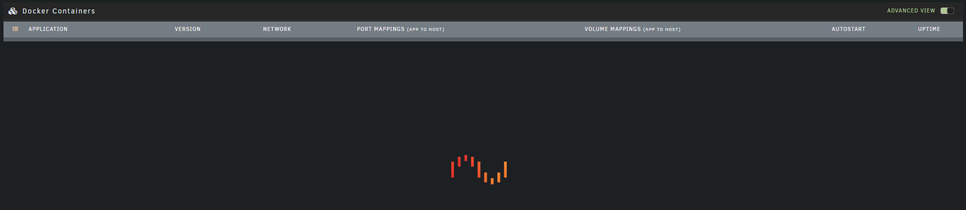

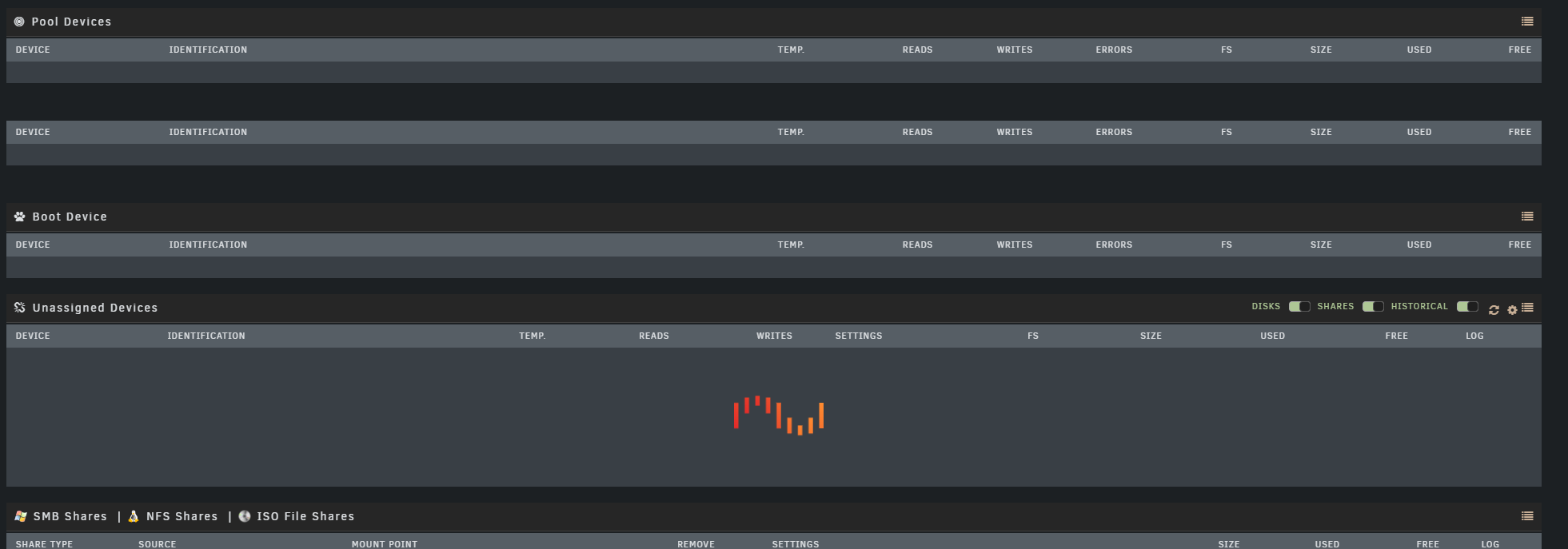

I don't know if it's related to the update from 6.11 to 6.12, I did a few days/1 week ago or so. But part of the dashboard will not show, the table, borders will show but not the data, I only have an unraid logo waiting forever. The server is still running, the dockers are running, etc.. just that the gui is not useful. After a reboot, everything looks good (at least when I did). It can be the docker page, the main page, the share pages, sometimes one can work but not the others. I don't think it's the same as this topic : I am already on IPv4 only and the gui is partially working in my case. I am trying to get the diagnostic, but when I download, it also seems unresponsive (or just take a lot of time), but the tools and setting pages were working.
