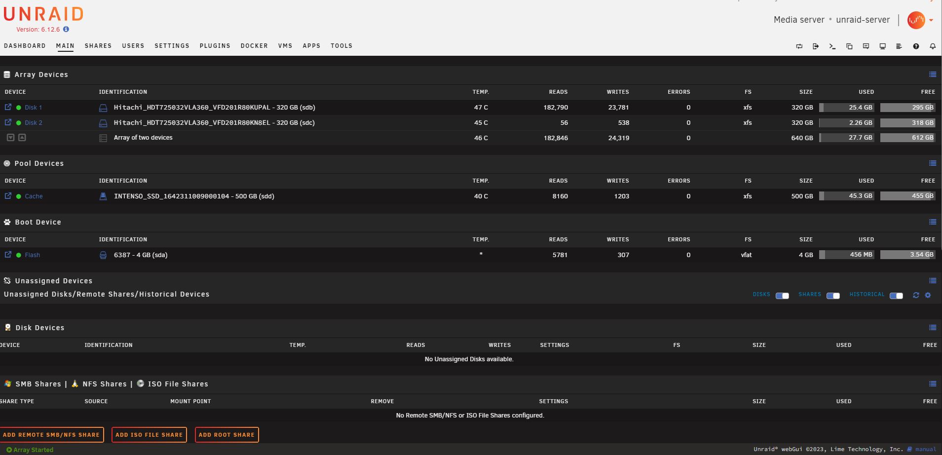

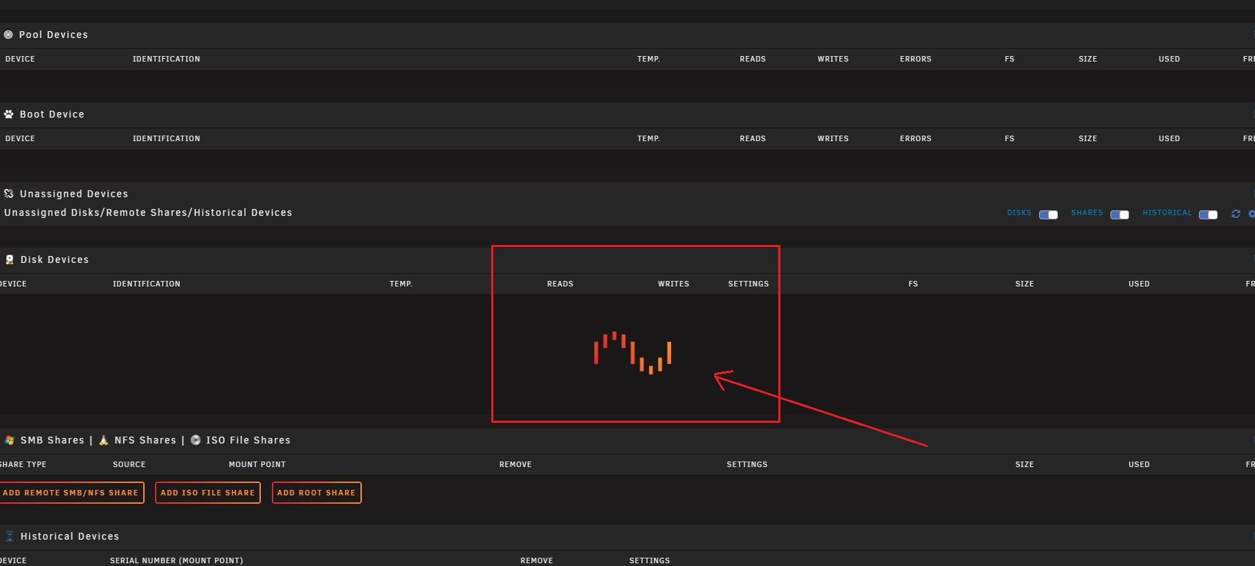

But now the devices under "Main" are not displayed anymore when I login remotely.
When I connect locally to my Unraid server, the devices under "Main" are displayed normally.

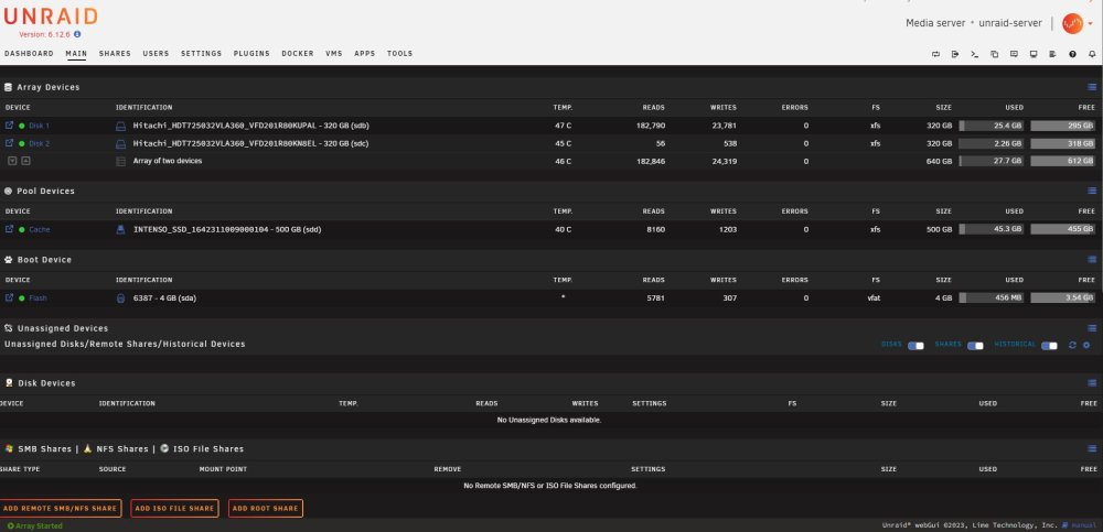

  • Post a screen shot of the devices when viewed locally.
  • Post your diagnostics,
Thanks for the quick reply,
  • Update the UD Plugin.          -->>  done

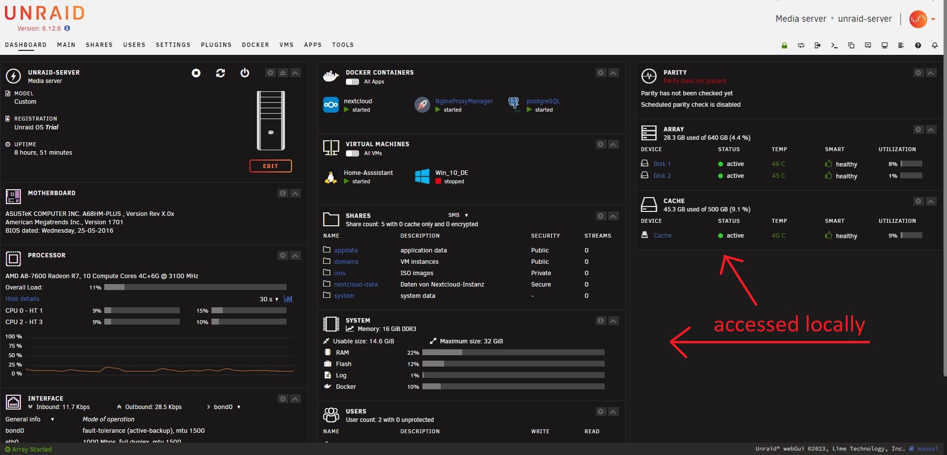

  • screen shot local devices     -->>  done

I have updated the Unassigned Devices plugin and removed all unassigned disks,
but still the same behavior no devices under "Main" are displayed when I login remotely.

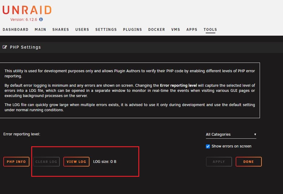

Turn on php logging by going to Tools->PHP Settings and set 'Error reporting level" to "All Categories".  Check the "Show errors on screen" check box.  Then access your server remotely.  Report any php errrs/warnings logged.
I've activated PHP logging and clicked around in every tab for a while
but there are no errors in the PHP report coming up (see screen shot)

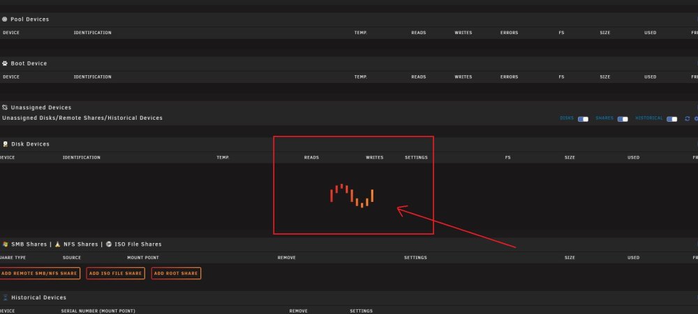

 Ya I've removed all the UD Plugins and tested it remotely.
Unfortunately still the same behavior no devices at all under "Main" are displayed.

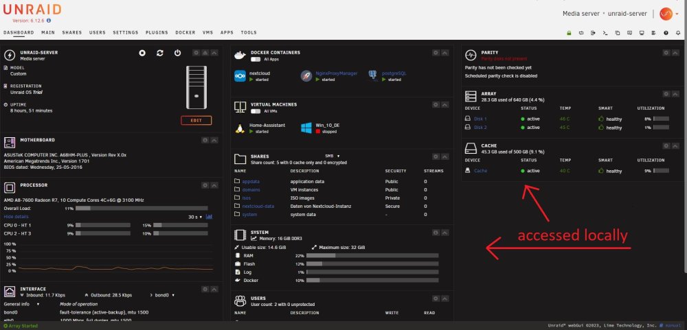

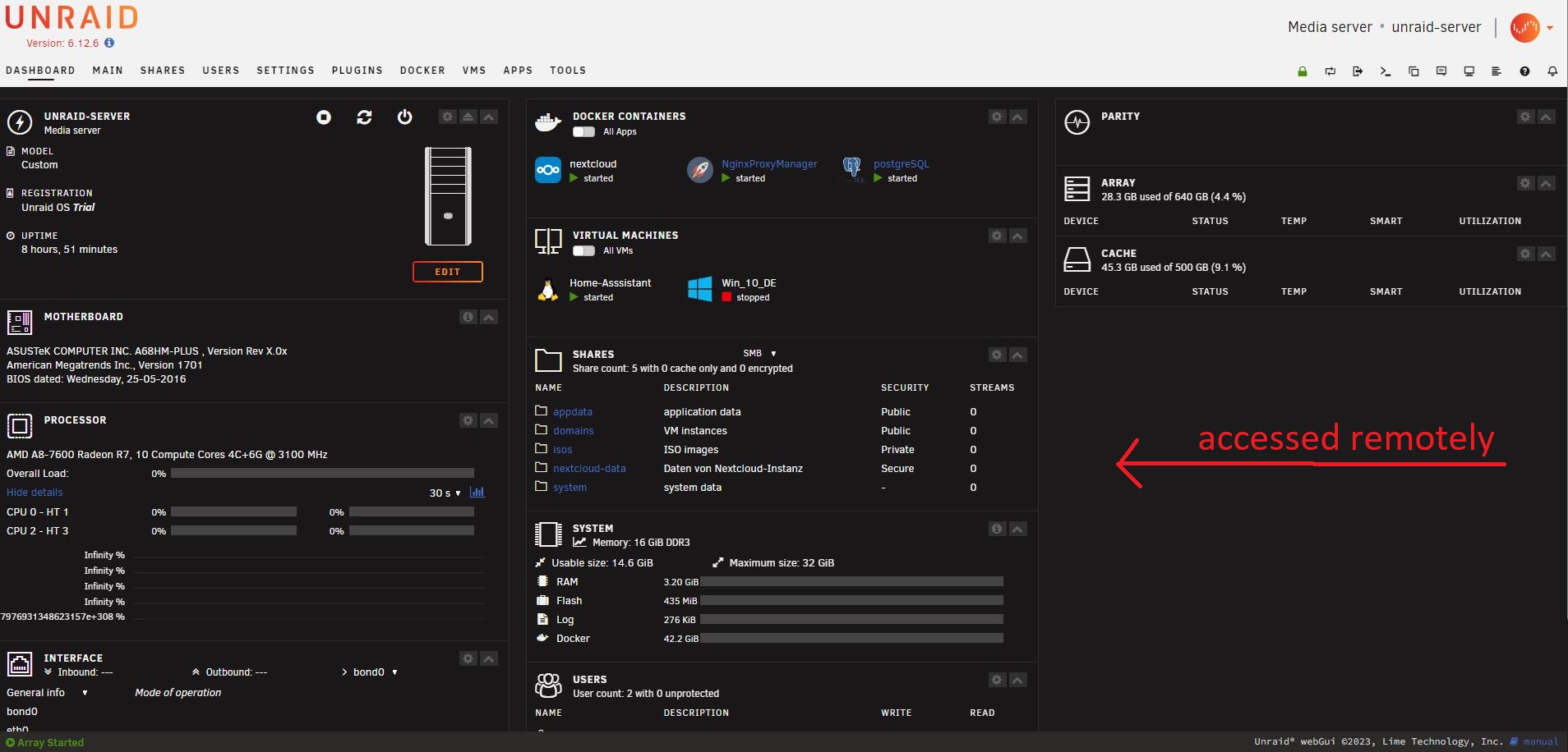

By the way also under the Dashboard no activity is shown (see screen shots).
And I've also tested it under different browsers, all shows the same issue.

The picture shows there is no nchan communication (this is the background communication to update the gui).
Some how your remote access blocks this.
