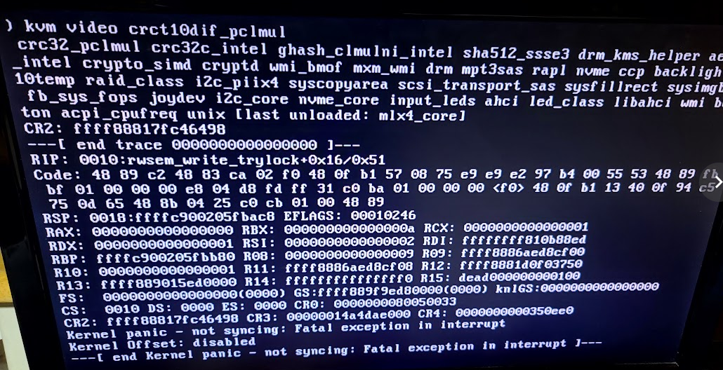

Chasing 2 things here. Server started locking up once a day after I added a new vlan on the NIC and adding that VLAN to docker. (unsure if that is the cause, but that's the major last thing I've done). All I can capture is this on the screen. Server is locked up hard and can't be interacted with. Any thoughts what causing this issue? macvlan?
Second thing is after a couple hard reboots drive6 started reading "unmountable: unsoported or no file system".

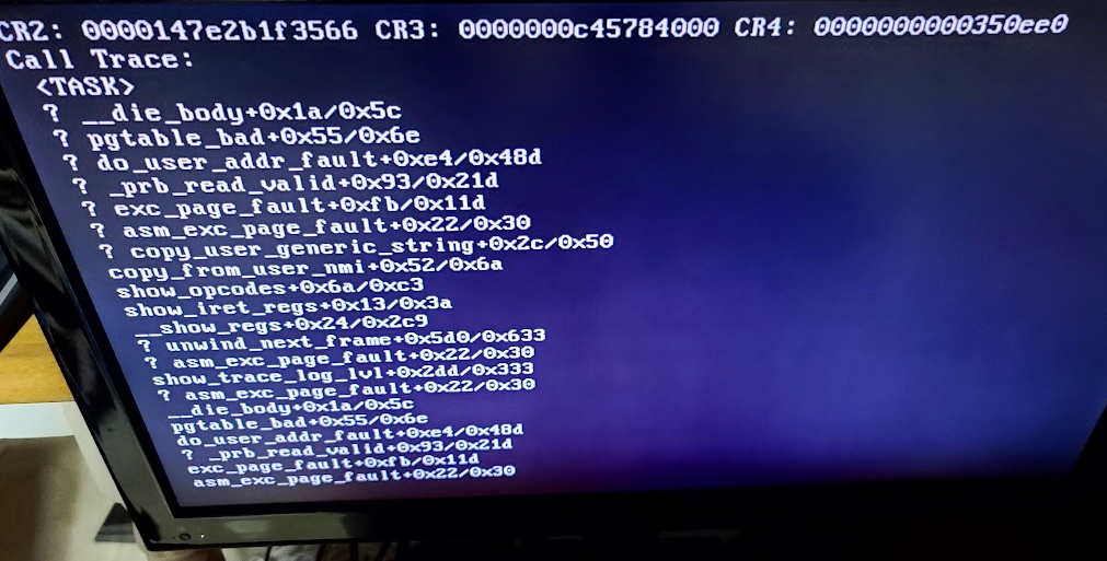

In case this pictures helps this was displayed on the screen when I got to it.(when there was a hard crash, not related to the previous text dump)
tower-diagnostics-20231226-1702.zip
