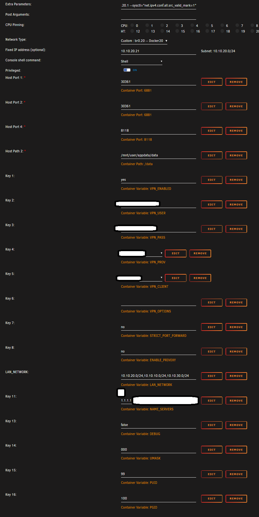

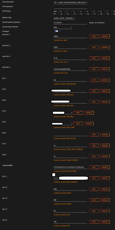

[Support] binhex - qBittorrentVPN
Seeking assistance on my configuration that is throwing me for a loop. I've got 3 subnets, 10.10.10.0/24 10.10.20.0/24 (this is the docker network). Qbittorent at 10.10.20.21 10.10.30.0/24 What works: I can connect to the web interface from: 10.10.10.0/24 10.10.30.0/24 ping ONLY from from 10.10.20.0/24 to qbittorent ping from qbittorent to anything on docker network What doesn't work: I can't connect to the web interface from the docker network. I can pcap on qbittroent docker and see packets coming in and responses leaving, but not making it back to my originating docker container (docker container 1 to qbittorent over tcp does not work) ping from 10.10.10.0/24 and 10.10.30.0/24 to qbittorent doesn't work. Any thoughts on what the issue is ? I have this configured like this:
