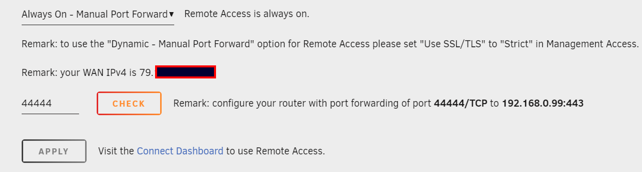

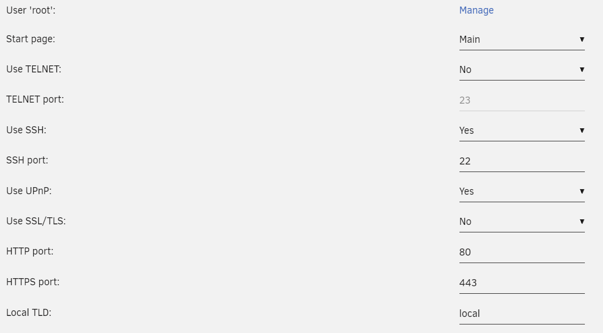

Getting quite frustrated. I can not connect remotely anymore through the app or anywhere. It seems I can not reach the few dockers I have exposed either so I don't understand the problem. It all worked perfectly before the update.
These are my settings:
And these:
Is there anything obvious I am missing?

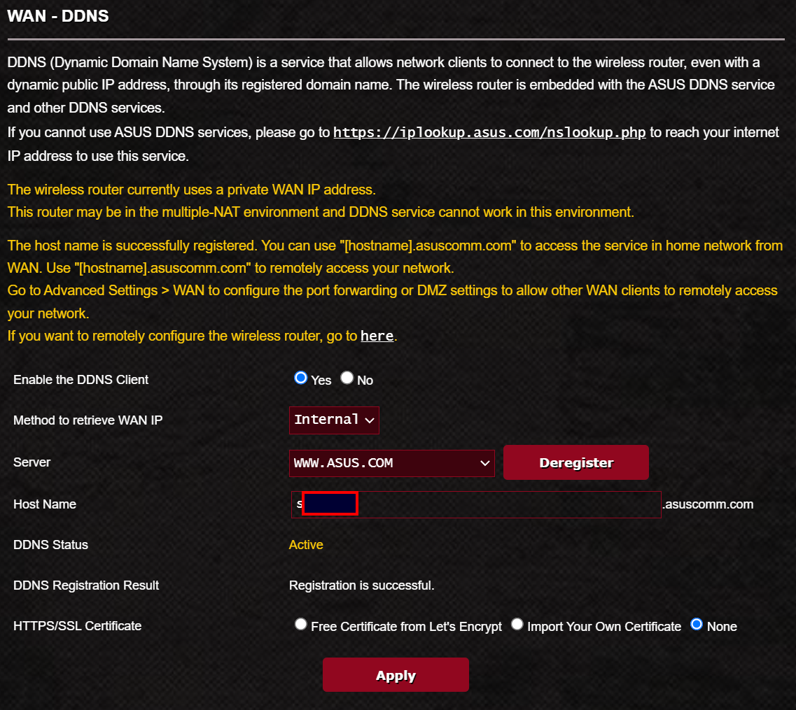

Also I have a asus GT-AC5300 router so I have setup it up as a DDNS Client so I have my own "hostname" i usually access my stuff remotely from but none work.

What version did you upgrade from?
Is the WAN IP that you blacked out correct?
What happens when you press the Check button?

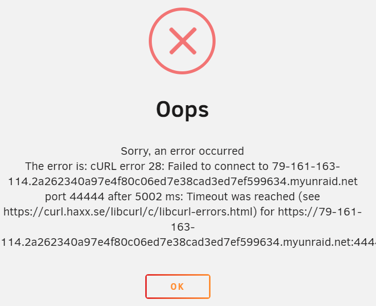

Please upload your diagnostics (from Tools -> Diagnostics)
The following error:

Wow about the WAN IP - it is actually wrong. Checking on WHats My IPAdress both the Unraid reported IP and the real IP start with 79. so I missed that they are the same. How the heck does this happen?
Something on your network is routing outgoing traffic from the Unraid server through a different WAN IP than you are expecting. I'd guess you have it behind some sort of VPN service, but I don't know.
Whatever WANIP is used for outgoing communication from the server is the same WANIP that is used for the port forward check and when the Connect Dashboard checks for Remote Access availability.

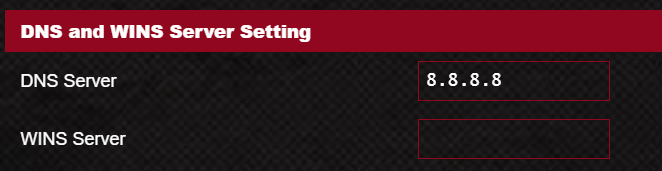

I took a look at my router settings. I had my DNS server setup to point to my pi-hole. I now removed this and pointed it to Google DNS instead:
I don't know if this should matter at all, but after changing these settings. I rebootet my Unraid server and also my router. Still the same issue is there.
I have also setup WAN - DDNS in my router if this could have any importance.
