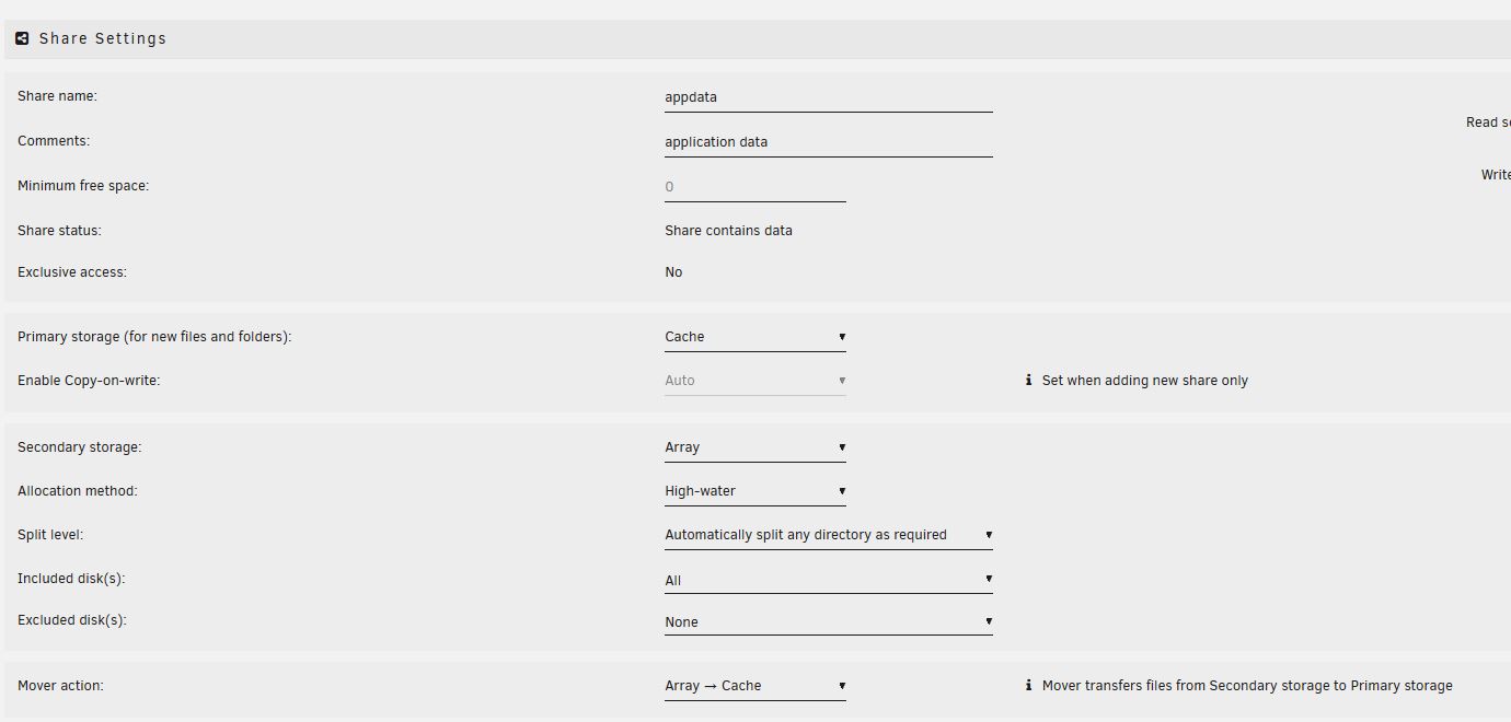

1 hour ago, trurl said:
Your appdata, domains, and system shares have files on the array.
Is it a wrong configuration? All files are marked with the cache as location. I added a screen of the appdata sahre setting.
Just trying to find it in the diagnostics.
Edit: I found it in the diagnostics. When I backed up the cache drive, I copied all onto a folder, location is on disc1, is that the problem?
Edited by Decay
The share settings are fine, but those settings only control where new files are written, or where mover will move files. By themselves, the settings won't move anything.
Did you try to move anything with mover or with Dynamix File Manager?
Nothing can move open files.
18 minutes ago, Decay said:
When I b
If the folder name is the same as the share name then as far as Unraid is concerned that share exists on that drive.

3 minutes ago, Decay said:
The folder I used for backup has a unique name, but all inside has the same folder name. Probably I should delete them.
That is not a problem, and would be a standard way of backing up to the array.   It is only if the top level folder corresponds to a share name that would be an issue.

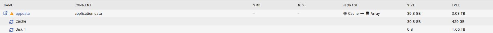

You can see how much of each disk/pool is used by each User Share by clicking Compute... for the share on the User Shares page.
29 minutes ago, trurl said:
That means everything in that folder is in the "unique name" share, not in the shares we are discussing.
Yes, all data and folders I backed up are in the "unique name" share. Just in that share are all folders have the original name.
Edit: I´ll try something. I´ll add "_TMP" to the backup folders and will see what is going to happen.
Edit2: Renaming doesn´t solved it. It looks like there are no data on the array, attaced some screenshots.
Edited by Decay
I am sorry, I was stupid... Missed empty folders.
Edit: Forgot to delete domains from disk1, also done that right now.
