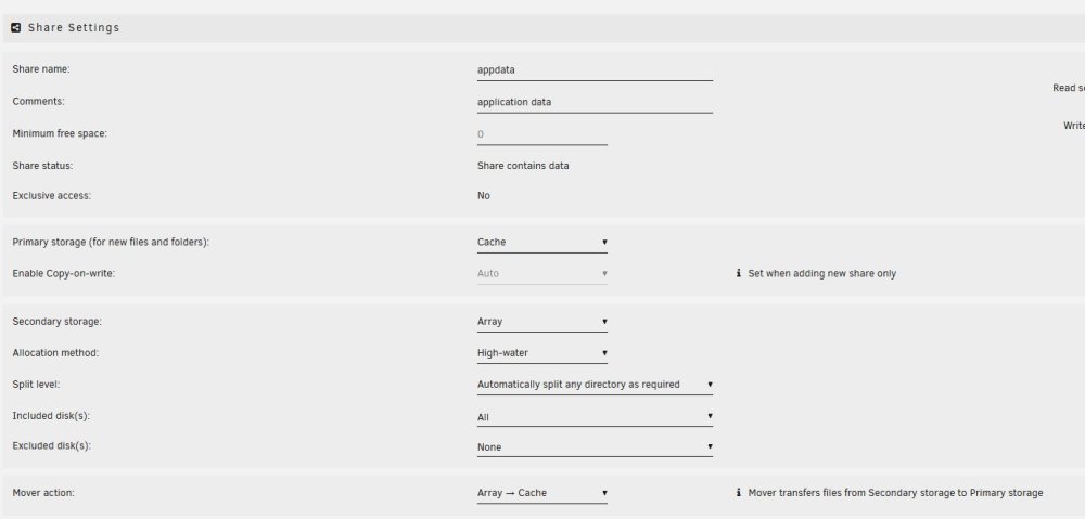

First, your appdata, domains, and system shares have some files on the array. And your domains share is set to get moved to the array.
Ideally, these shares would have all their files on fast pool such as cache, so Dockers/VMs can perform better and so array disks can spin down since these files are always open.
Set domains Mover action: array->cache
Nothing can move open files, so you have to disable Docker and VM Manager in Settings so these shares can be moved.
Then, run Mover, wait for it to finish, and post new Diagnostics so we can check if everything got moved.
Shares such as ‘appdata’ and ‘system’ still have files on the array so that still needs resolving.
I checked that and it is set to: array->cache
How could I resolve that problem? Could it be possible, that that are files from an old and wrong configuration?

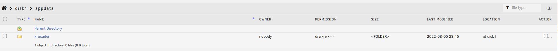

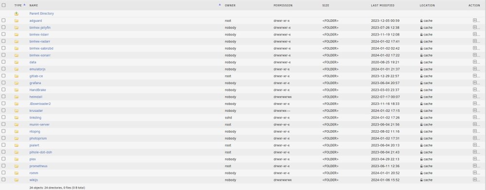

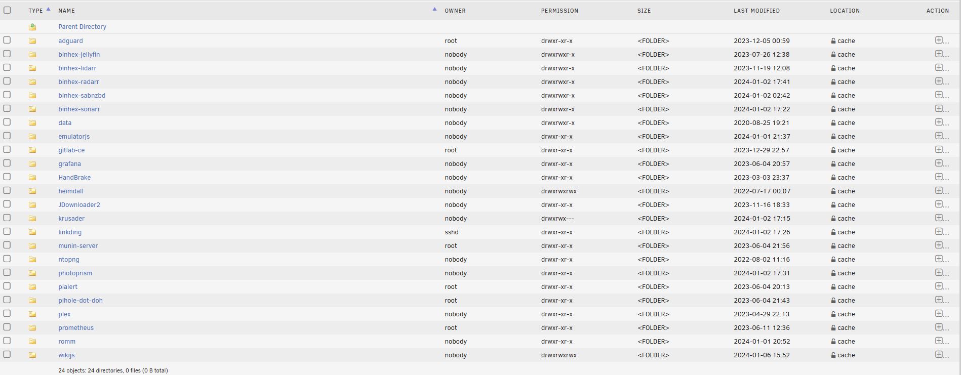

What is in the appdata folder on cache and on disk1? Screenshots will be fine.
Here are the screenshots. Yes, VM and Docker are disabled.
Edited by Decay
Looks like the only duplicate is krusader. Personally I would just forget all about krusader and use Dynamix File Manager.
