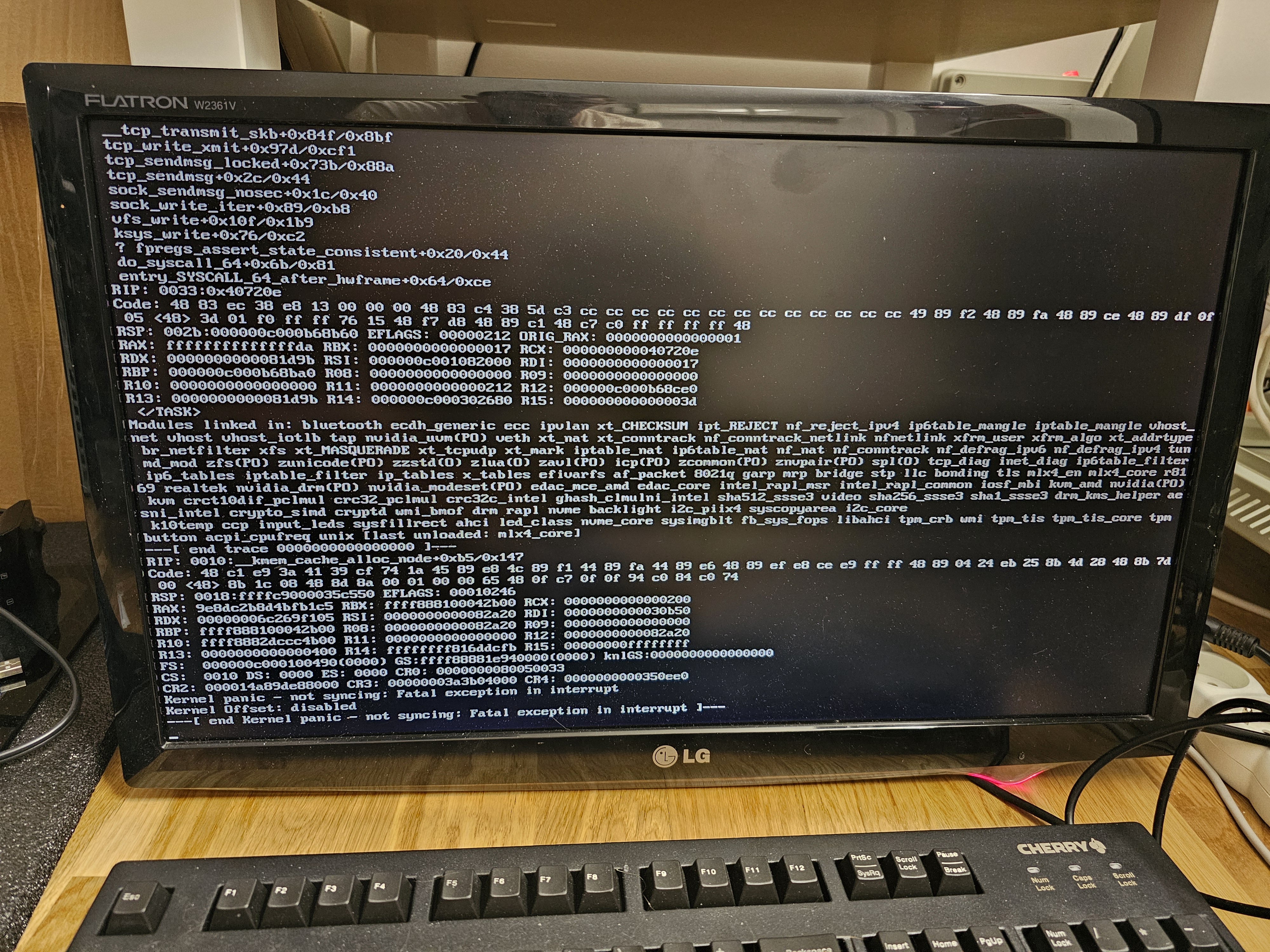

System locked up again this afternoon unfortunately. Kernel panic from the KVMoverIP console.

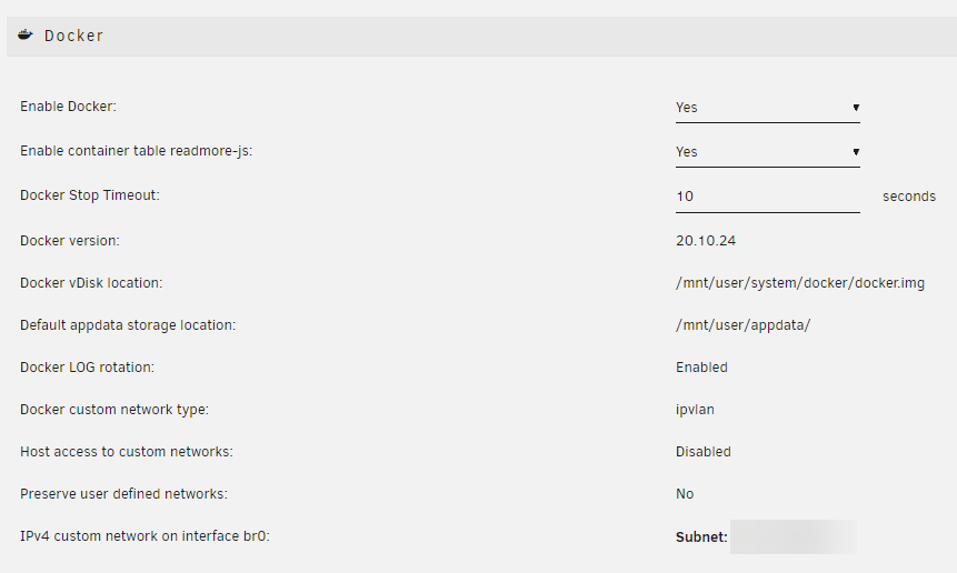

I can't seem to select eth0 or bond0 for the containers that had static IPs previously, and so they fail to start. I suspect it's a setting I need to change in network settings or docker settings, but I'll have to wait until later when plex is no longer needed.
Would the docker bridge setting for the containers be causing the issues? I do have 802.3af bonding on 5 NICs (one port disconnected cable). Not sure if any of that is related.

Before I saw your message I noticed that enable host access to containers was still enabled, and the extra info specified macvlan; even though I had ipvlan enabled. So I disabled that, and started up docker again. To see your message and have run the command. Happy to revert and run the command again though.
Containers with specified IPs are back, but still showing br0, rather than Bond0 or eth0. So I'm not sure if I've done it all right now.
No macvaln now, suggest rebooting one more time and see if it no longer crashes now.

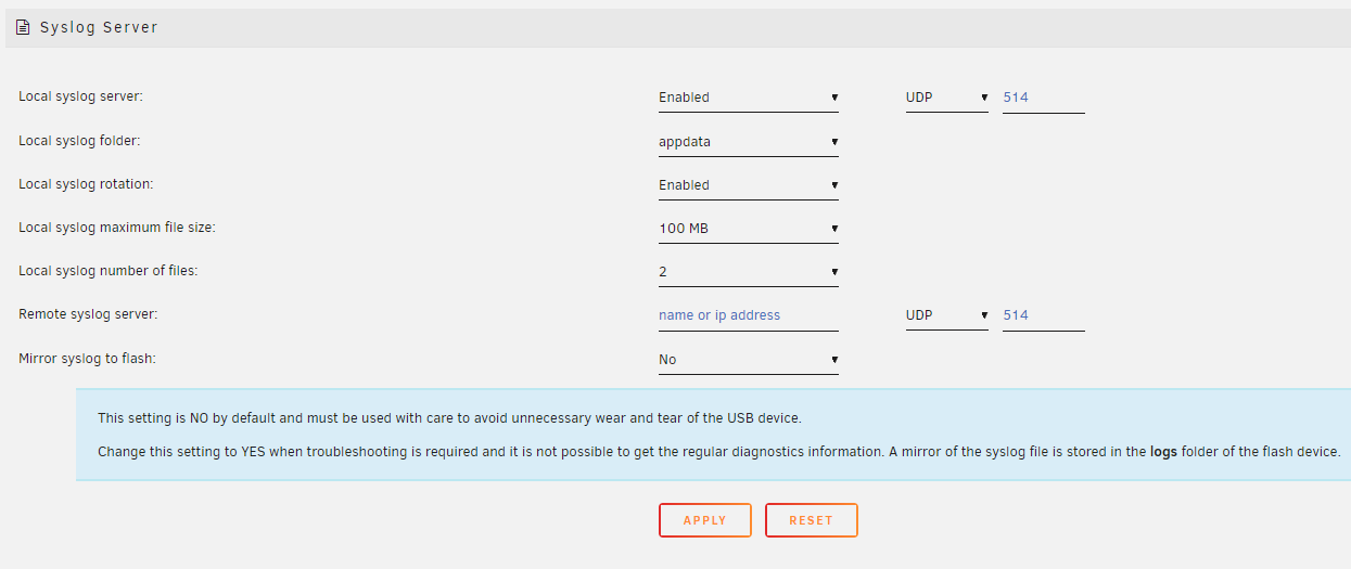

Since it's not boot related, would you still recommend mirroring the logs to flash, or `appdata` storage will suffice in this instance?
Appdata should be fine but you need to input the main Unraid server IP in the remote syslog server filed, or nothing will be logged.
If its only going to be for a short period I would say mirror to flash as easiest and catches the most information..  If it will be for any significant length of time then use the remote syslog server field to log to the location you specify to avoid wear on the flash drive.

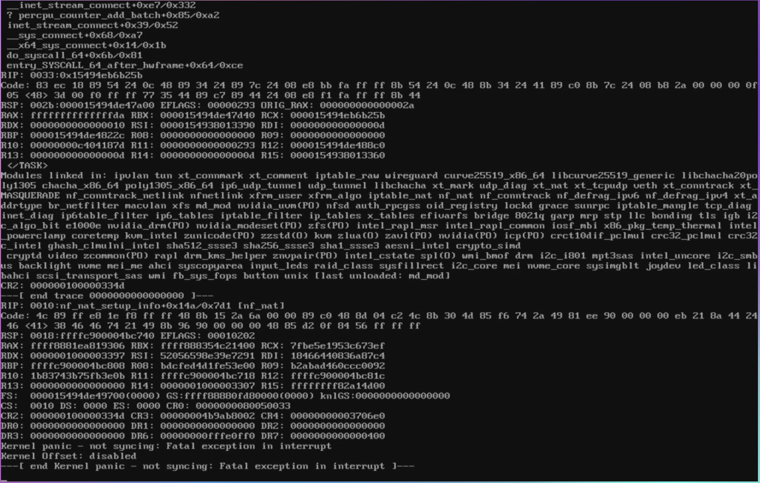

The crash occurred today around 22.20 CET and I've recovered around 0:20 CET, so rough 2h later.
Please see the logs attached
syslog-10.10.10.99.log
Feb 27 22:13:28 Server kernel: xhci_hcd 0000:03:00.0: WARN Set TR Deq Ptr cmd failed due to incorrect slot or ep state.
Feb 27 22:13:28 Server kernel: xhci_hcd 0000:03:00.0: WARN Successful completion on short TX
Feb 27 22:13:28 Server kernel: xhci_hcd 0000:03:00.0: ERROR Transfer event TRB DMA ptr not part of current TD ep_index 2 comp_code 1
Feb 27 22:13:28 Server kernel: xhci_hcd 0000:03:00.0: Looking for event-dma 0000000102666710 trb-start 0000000102666720 trb-end 0000000102666720 seg-start 0000000102666000 seg-end 0000000102666ff0
This is the last thing logged before the crash, seems some USB controller related issue, it's not good but not sure it would be a reason to crash the server, try again, if the same thing happens it might be.
