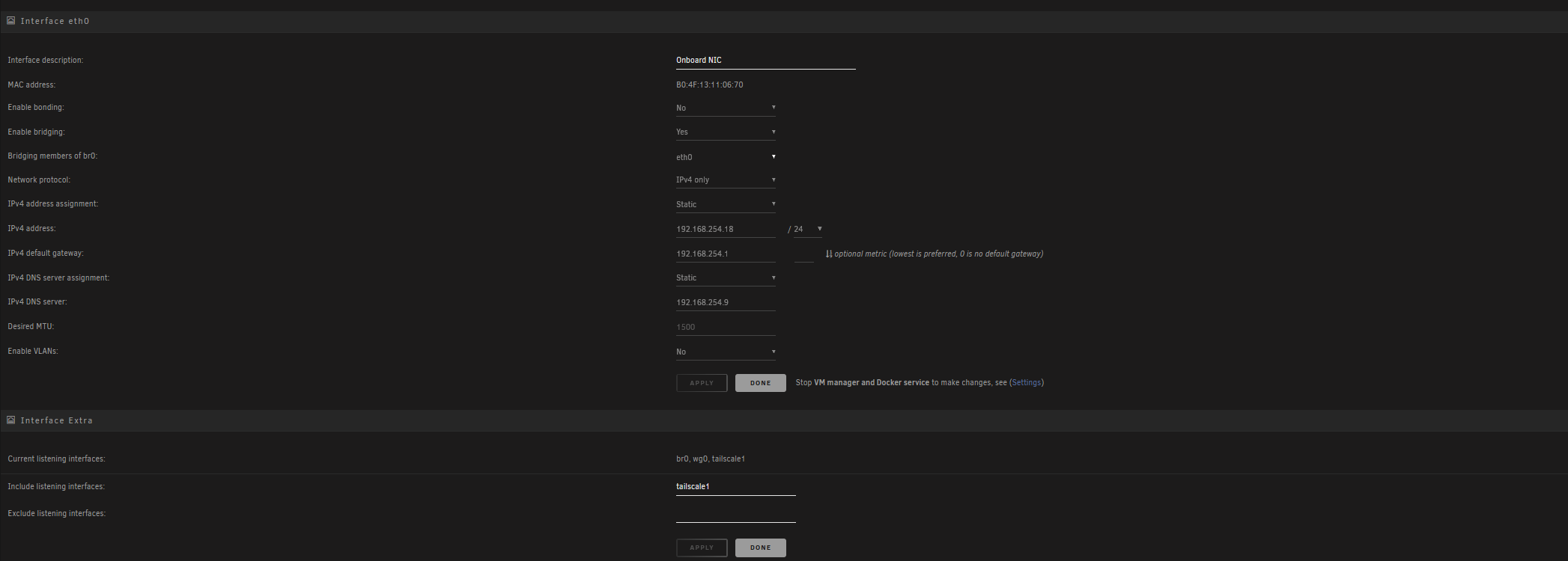

I have installed 2 10gb nics, both in different unraid servers, to try and directly connect them. My older box shows the new nics in the network panel, but the precision3450 does something different. It show the devices in system devices:
But they do not show up on the network page as expected:

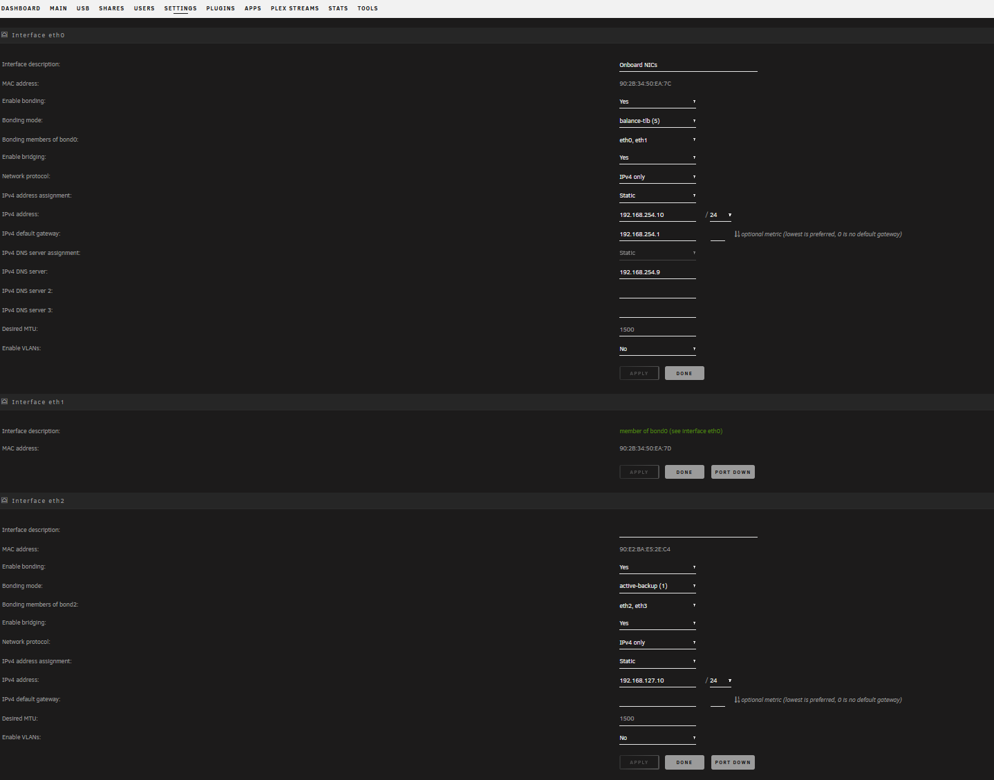

Working computer same views:

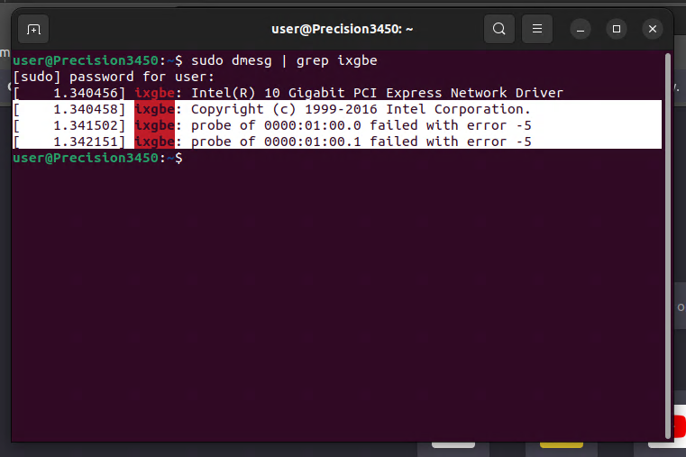

Both NICs are failing to initialize, so the driver is not loaded, but don't see why:
Jan 18 22:59:50 Precision3450 kernel: ixgbe: probe of 0000:01:00.0 failed with error -5
Jan 18 22:59:50 Precision3450 kernel: ixgbe: probe of 0000:01:00.1 failed with error -5

In this case I suspect network-rules.cfg is not being created because the other NICs are not loading a driver, so basically Unraid only sees one NIC.

Just installed windows on the same machine, and had no issues adding the drivers for the x520. It seems like it isnt a hardware issue, but is unraid specific as it works with windows.
Could be a kernel in-tree driver problem, you can try booting a different Linux distro, ideally with a similar/same kernel.
Same issue in ubuntu 20.04.3, what does that indicate?
It does confirm it's not an Unraid problem, could be an issue with the Linux in-tree driver, or a problem that the Windows driver ignores and Linux one doesn't, either way I'm afraid I don't have a good solution, other then maybe trying a different NIC if possible.
