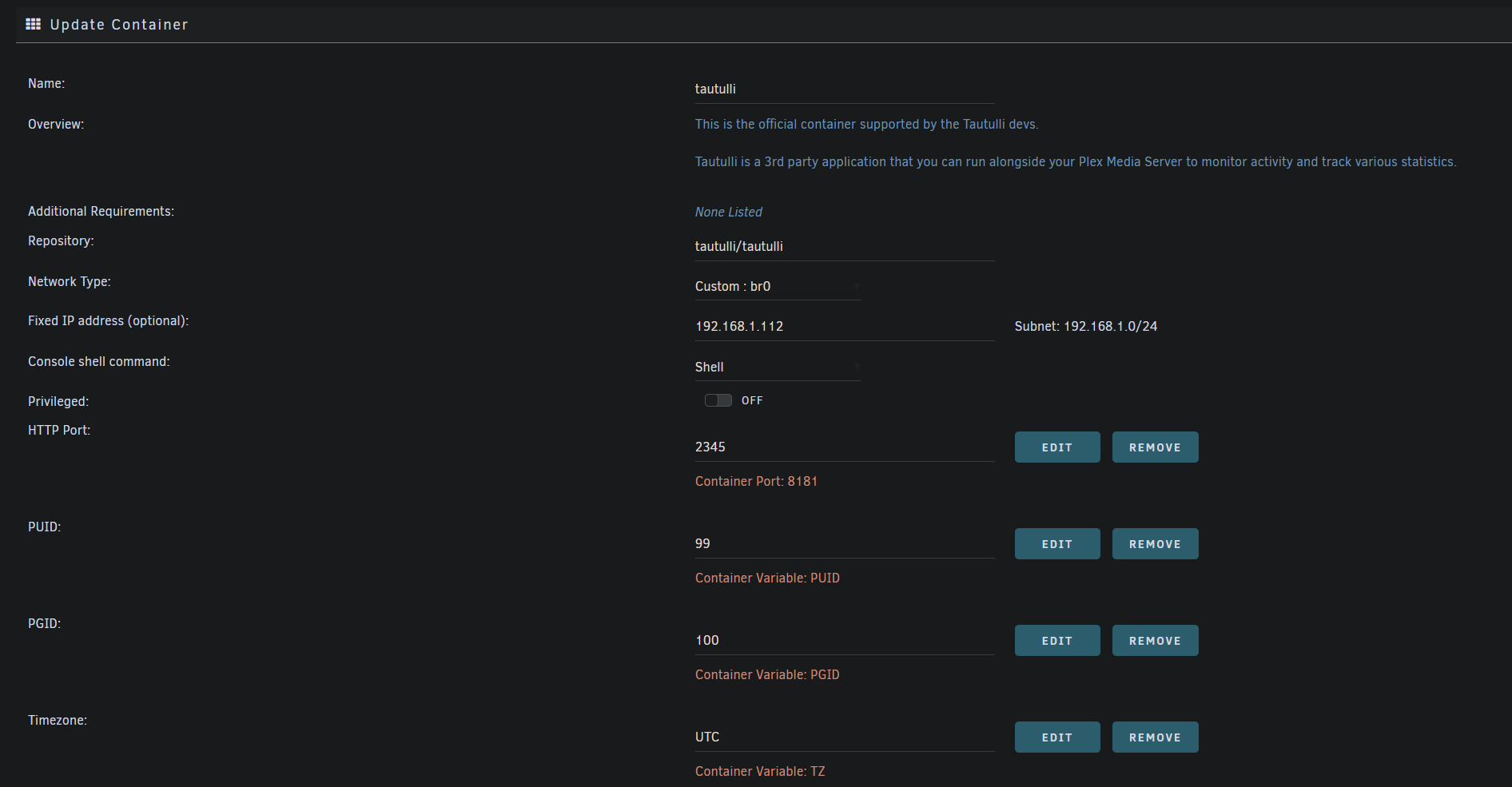

I switched the network type from bridge to Custom: br0. I set the IP of the containers to an unused IP on my LAN. The IP address updates correctly, but I can't set the port of the docker anymore. Is that expected or am I doing something wrong? The port always uses the default port of the application. I've tried with Tautulli, MakeMKV, and Handbrake all having the same problem.
I have the port of Tautulli set to 2345 but docker is showing 8181.

To be expected.  The docker system ignores all port mappings when network type is a custom IP (or host)
Okay. How do I set static IPs for Dockers but also make port changes? Or is that not possible?
When docker container has its own IP the only way you can change the port is for the container developer to make a change within the container.
