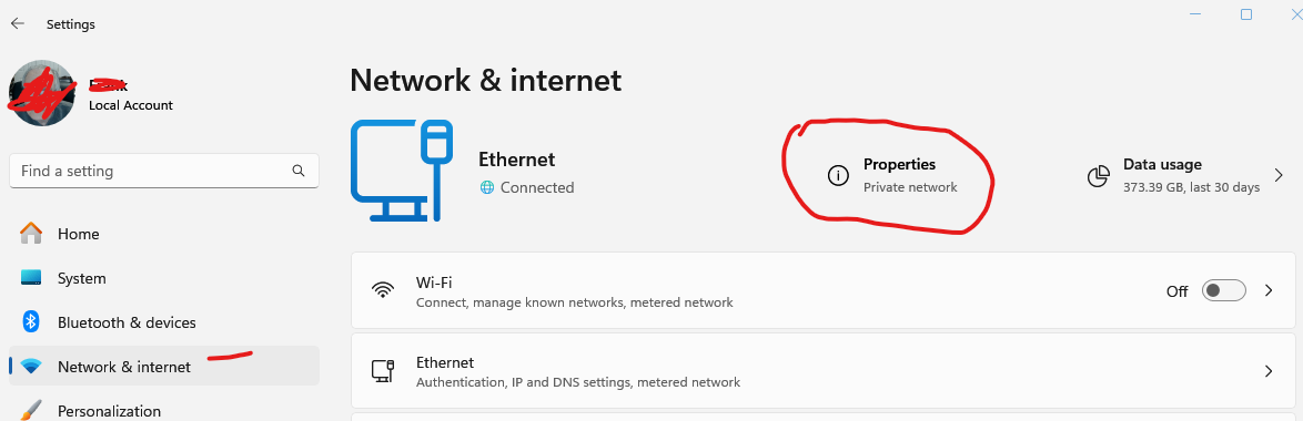

IF you are using a wireless connection, make sure that this setting is on 'Private network'.  You can change it by clicking on it.
Both desktop and server have wifi turned off and running on an ethernet lan connection.

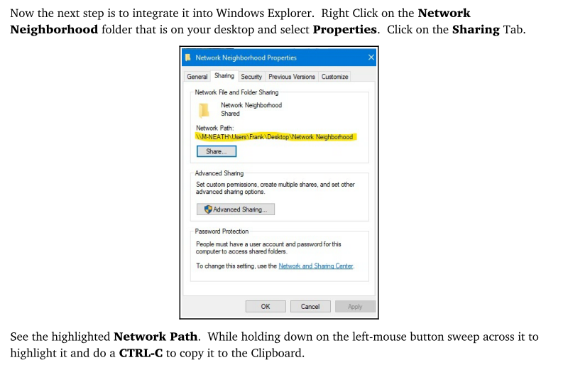

  3. The next step is to integrate it into Windows Explorer. Right Click on the Network Neighborhood folder that is on your desktop and select Properties. Click on the Sharing Tab.
The Network Neighborhood folder I created per the instructions is not automatically shared like shown in the sceenshot in the "Unraid & Windows 10 SMB Setup" pdf referred to above.
When I click the Share button in the Properties/Share tab of my Network Neighborhood folder, it says:

Here is a screenshot of that part of the instructions:
You are now done with the Network Neighborhood Properties.  Click on the 'X' in the upper right corner and close it.  The only thing we needed was the 'Network Path:' to this folder and it is on the Windows Clipboard.
We now move onto this step:

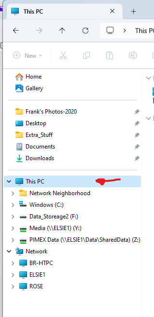

Below is a screenshot of the left pane of Windows Explorer with an arrow indicating where to right click:
Then follow the remaining instructions.
By the way, you can use the Network Neighborhood folder that is on your desktop to access your server.
Just double click on it to open it and double click on the shortcut to your server that you created earlier.  You do not have to integrate it into Windows Explorer but that step is a very convenient feature.

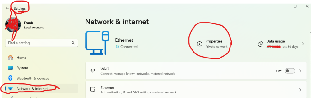

One more thing.  Make absolutely certain that your Connection (Wireless or Ethernet) is set to 'Private Network' as shown below:
The 'Public Network' setting is for connection to network in Public places-- WiFi hotspots, McDonald, motels, airports, etc.  It is much more restrictive in permitted activity.

I'm hesitant to say it but for the past 2 days the issue seems to have improved (watch it going wrong tomorrow of course).
I am not sure what made the difference, but I think it may have been putting every exported file to "Yes" now and no more "Yes - hidden"
Was not able to set up the Network Neighborhood with any results.
