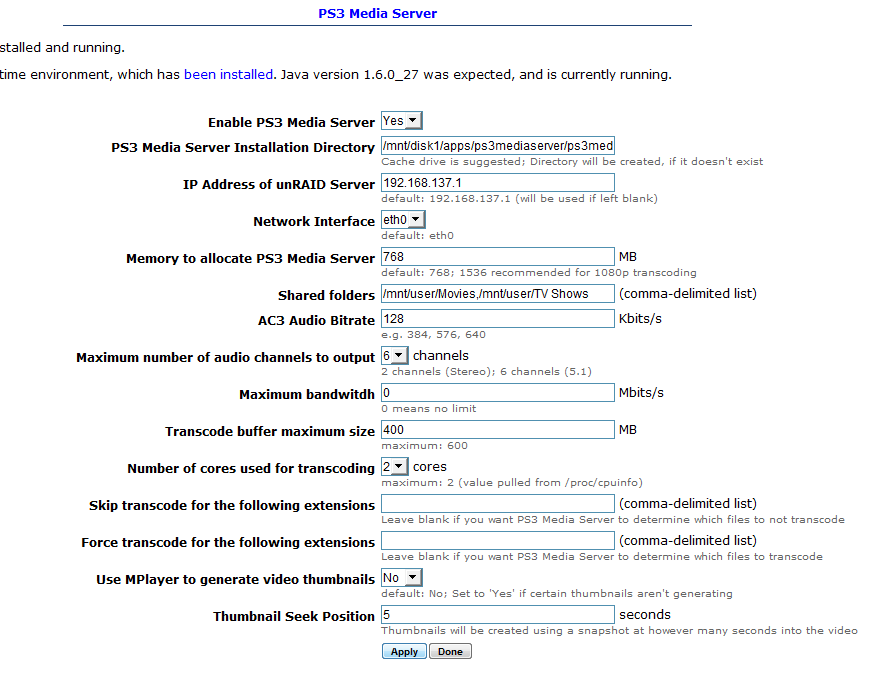

I changed the PS3M install dir to /mnt/disk1/apps//ps3mediaserver/ps3mediaserver    Note the double // after apps.

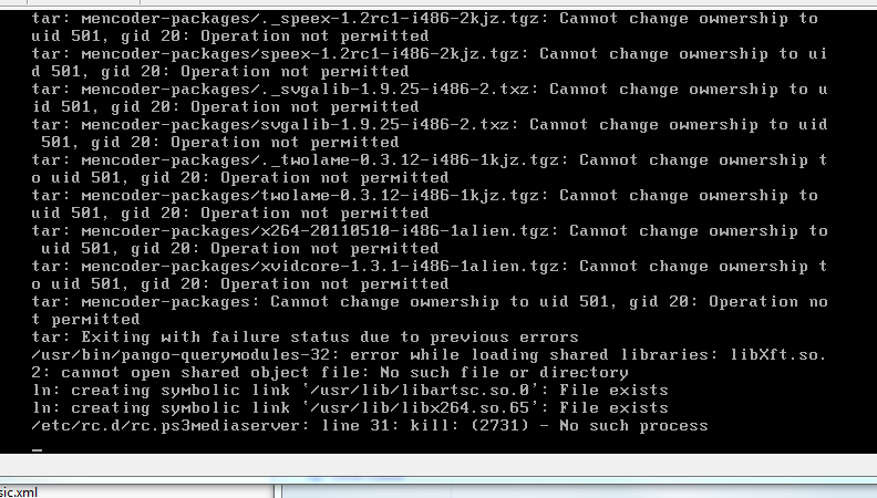

It started it's install .. and many errors.  Mostly
'tar: mencoder-packages: Cannot change ownership to uid 501, gid 20: Operation not permitted"
'ln: creating sym link '/sur/lib/libartsc.so.0': file exists
'etc/rc.d/rc.ps3m..: line 31 Kill (2731) no such process.
I restated unraid and reinstalled to /mnt/disk1/apps/ps3mediaserver/ps3mediaserver
But it still throws a lot of errors.
I'm not sure where these errors are logged.. I looked in syslog and demsg.. no msgs there.
I get these messages now with each restart
The  unRaid PS3 Media player webpage says it's started.  . But it doesn't show as a source Windows Media player
See attachment for screenshot
I'd like to erase and re-do..  Where do I start?

Zoltran,
You should be able to ignore the mencoder-related errors. I originally created the mencoder package on my Mac and the permissions are set up a bit differently there. You're not the first person to be confused by this so I'll try to address that in a future version of the plugin.
Also, before the process starts, I try to kill any existing PS3MS process. If none is running, you should get that "error".
If those are the only errors then you should be okay. Have you tried starting the plugin and seeing if it shows up on your XMB?

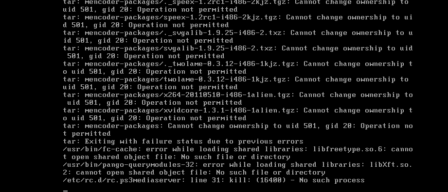

1) In the .plg file, you have:
// install all the mencoder files
exec_log("installpkg /boot/packages/mencoder-packages/*.t*z");
which will install packages in the order in which the directory lists them.  However, there seems to be some dependency on this order such that simply installing them in list order generates the following in the /var/log/plugins/ps3mediaserver:
Executing install script for fontconfig-2.4.2-i486-2.tgz.
/usr/bin/fc-cache: error while loading shared libraries: libfreetype.so.6: cannot open shared object file: No such file or directory
My "quick" fix was to change the above script to:
exec_log("installpkg /boot/packages/mencoder-packages/freetype*.txz");
which guarantees freetype is installed before fontconfig.  There's probably a better way to handle this...

Heya ajax,
here you go, and thanks a million!
root@MediaTower:~# #ps3mediaserver configuration
root@MediaTower:~# SERVICE="enable"
root@MediaTower:~# EXPECTED_VERSION="1.40.0"
root@MediaTower:~# INSTALLDIR="/boot/config/plugins/ps3mediaserver/ps3mediaserver"
root@MediaTower:~# hostname="192.168.1.76"
root@MediaTower:~# network_interface="eth0"
root@MediaTower:~# HEAPMEMORY="1536"
root@MediaTower:~# folders="/mnt/user/Movies,/mnt/user/Music,/mnt/user/Pictures,/mnt/user/TV Shows"
root@MediaTower:~# audiobitrate="384"
root@MediaTower:~# audiochannels="6"
root@MediaTower:~# maximumbitrate="0"
root@MediaTower:~# maxvideobuffer="600"
root@MediaTower:~# nbcores="2"
root@MediaTower:~# notranscode=""
root@MediaTower:~# forcetranscode=""
root@MediaTower:~# use_mplayer_for_video_thumbs="false"
root@MediaTower:~# thumbnail_seek_pos="5"
root@MediaTower:~# uuid="23ad1e9e-dc6e-8e88-a29e-0000721c2a53"
