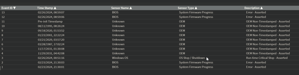

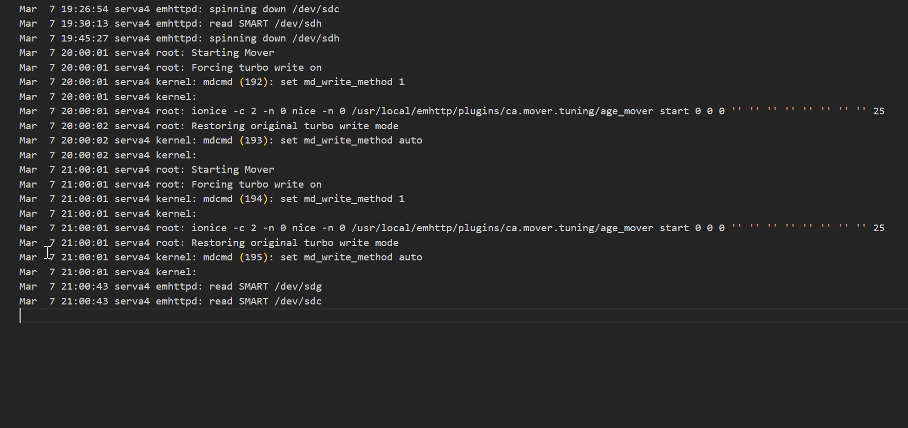

this is my last attempt to fix these random kernel panics. I'm fighting this issue since years, but never had a hint where to start.
Because I never got anything in the logs. I had set up an external rsyslog server for this, but the last log was minutes before the blackout and had nothing to do with kernel panics.

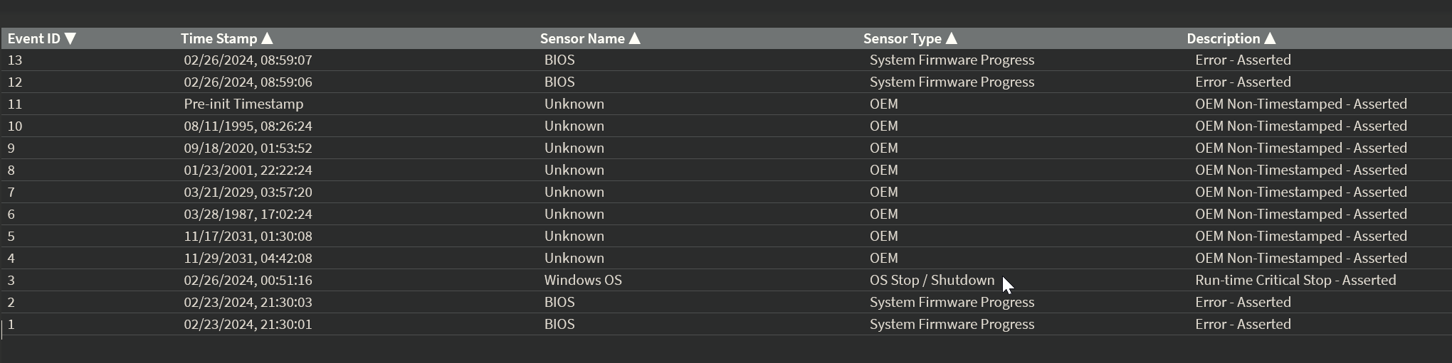

The Screen was always black and in the ipmi log was only this:
Not really helpful for finding the root course, but I could react on "OS Critical Stop" | "kernel panic" and send an
ipmitool -I lanplus -H 192.168.2.241 -U user -P pass power cycle
Command to automatically reboot.

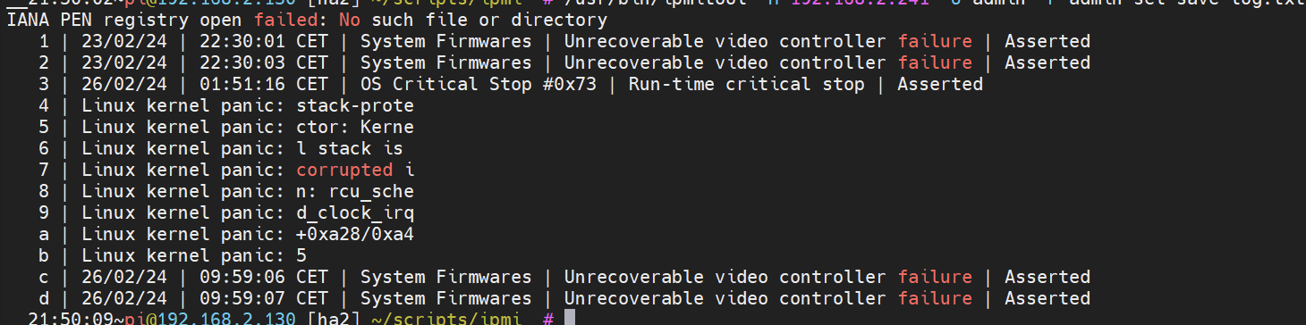

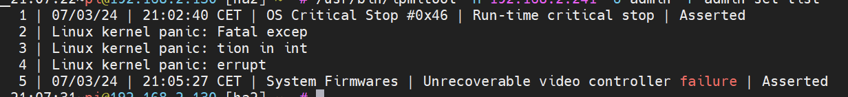

But today I played around with the ipmi tools and the first time I got something what maybe can help. So that's my hope. :)
The string is not complete, and I don't get more information from the ipmi tool. But maybe this helps.
Any Idea?

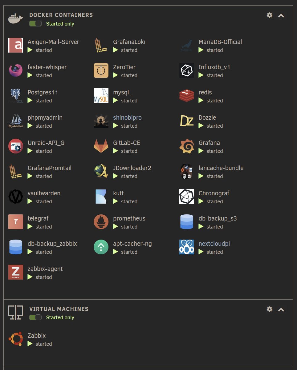

Running Aps:
The RTX is pass through to Shinobi

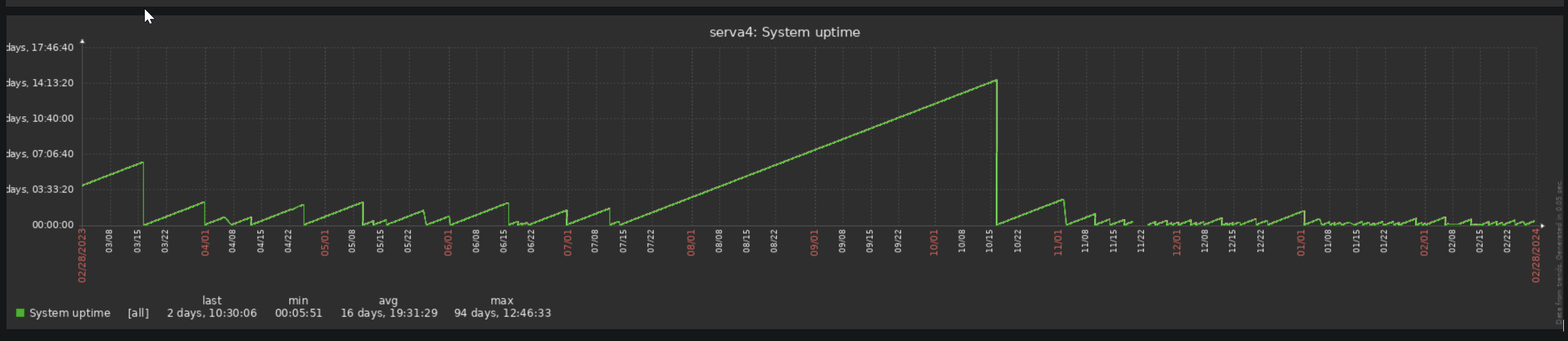

I have this problem nearly since 3-4 years as the server exists. At the beginning, this only happens once in a month. But since a year this happens once a week.
After a power cycle while the server is checking parity, this never happens. Only 1-2 days after the parity got checked, what takes around 19h.
Here is my uptime diagram from the last year. Every drop was a black screen.
So any Ideas what to check, or what's the root cause of this problem?

After I deinstalled the second ATI GPU, I had hopes that the System is more stable now.
But sadly it crashed again after 3 days uptime.
The stop was at 21:02.
Ipmi Log:
Last Unraid Log was 6min before.
So it looks like, that there is nothing written.

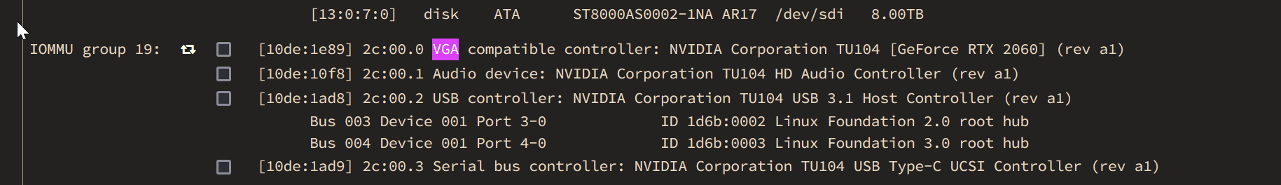

The ipmi log says that the Video controller had a failure, but not which.
I have a RTX2060 and the onboard in the system.
How can I deactivate the onboard VGA for unraid? I think I can't do that in the bios.
greetz Stefan

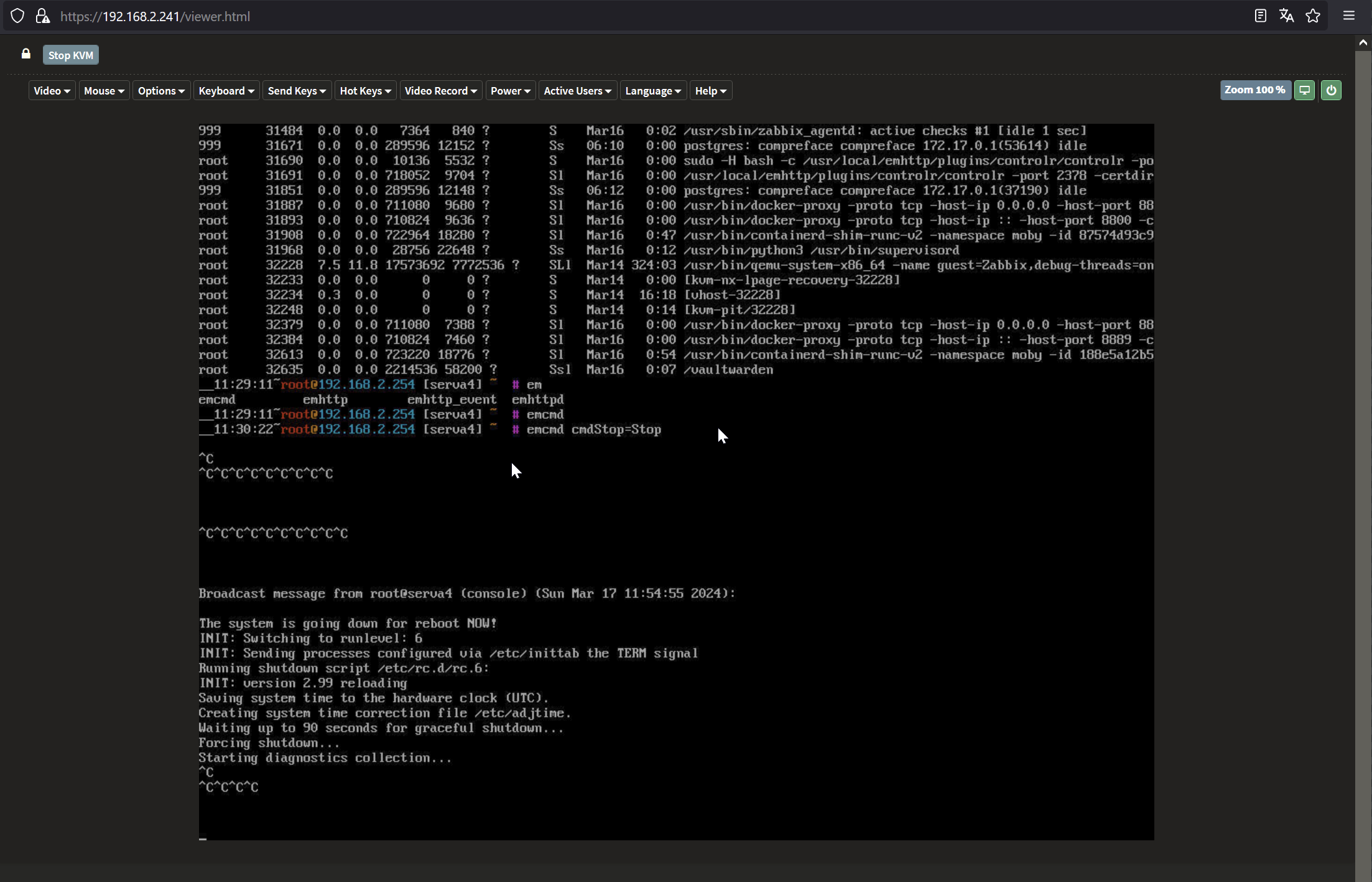

Hey all..
After removing the gpu driver, the GPU Errors in the ipmi logs are gone. That's good.
But tonight the server crashed again, but with a different error.
The server was not reachable from the network with a 100% packet loss.
But I could log in via the onboard KVM and use the terminal.  Strangely, a ping from the server to the network was successful.
Now I have a ton of these errors in the log.

The CPU Numer (CPU 14 to CPUs 0:) itterated from 0-15.
I then wanted to stop the array from the command line and reboot, but the server got stuck and hung for over an hour.
Then I send a CRTL+ALT+DEL but got stuck at the "starting diagnostic collection" step. So I had to send a "power cycle" via ipmi to reboot and now have to do the parity check again.
