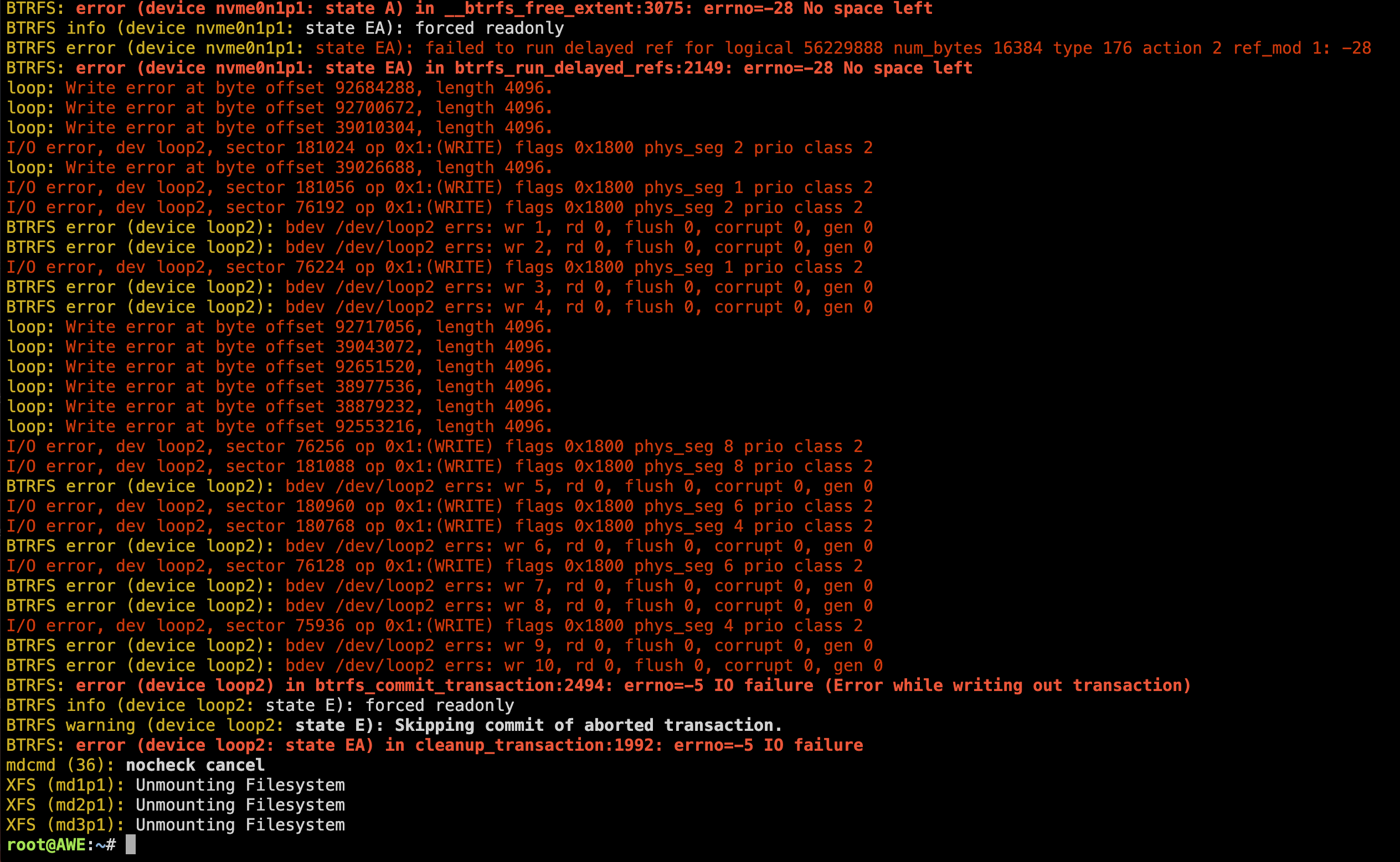

can't delete files from FULL BTRFS pool (read only)
Mar  2 13:50:25 AWE kernel: BTRFS: error (device nvme0n1p1: state A) in btrfs_run_delayed_refs:2149: errno=-28 No space left
Mar  2 13:50:25 AWE kernel: BTRFS info (device nvme0n1p1: state EA): forced readonly
Mar  2 13:50:25 AWE kernel: BTRFS warning (device nvme0n1p1: state EA): Skipping commit of aborted transaction.
Mar  2 13:50:25 AWE kernel: BTRFS: error (device nvme0n1p1: state EA) in cleanup_transaction:1992: errno=-28 No space left
Mar  2 13:56:04 AWE kernel: BTRFS warning (device nvme0n1p1: state EA): checksum verify failed on logical 2169117310976 mirror 1 wanted 0xb123218b found 0xb40b712a level 0
Mar  2 13:56:04 AWE kernel: BTRFS error (device nvme0n1p1: state EA): parent transid verify failed on logical 2169117310976 mirror 2 wanted 10415 found 10411
So I got a warning my cache drive was full, due to downloads. I tried running mover but didn't work. Also tried deleting all files in qbittorrent (was a large torrent) and it showed as ERRORED. So I did a delete and the files are still there. tried running "rm" in terminal and it showed files are read only.

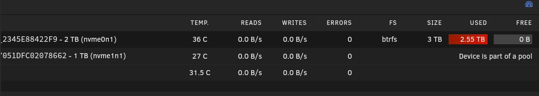

Yep, makes sense. Still I wouldn't expect 2.55TB out of 3TB to be considered full? Mainly when I have preallocate disk space in qbit.

You have mismatched disk sizes, presumably in a RAID1 setup. Btrfs free space is basically meaningless in that case and it can run out of blocks to allocate at unexpected times, and... is likely to corrupt when that happens.
Edited by Kilrah
It's actually raid0 because I wanted as large a cache as possible and since I backup appdata and vm data everyday I didn't really care if any data is lost. It's just downloads anyway that eventually get moved to the array. Hence me finding it weird it's showing 2.55tb as full when it's a 2tb + 1tb nvme drives

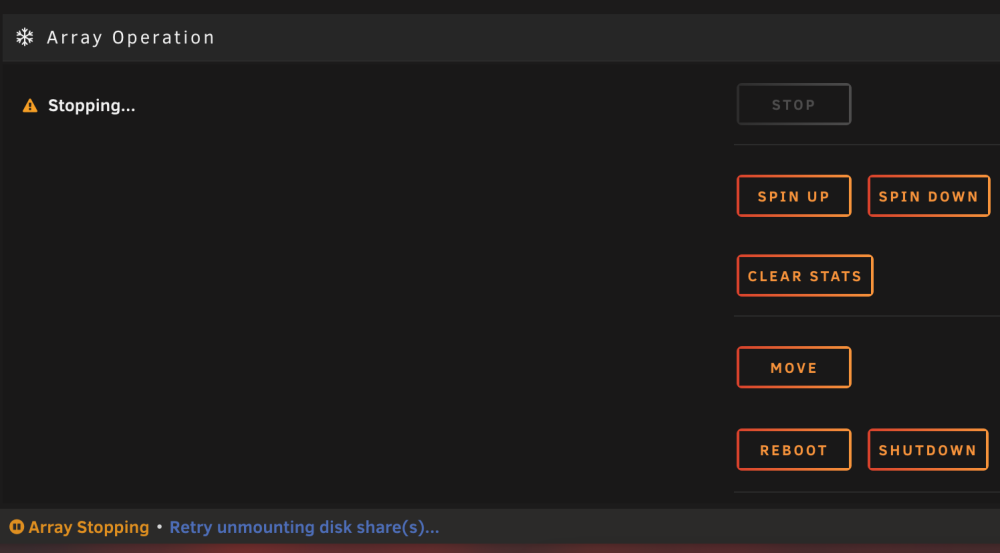

Stopped all dockers, VMS. Turned docker off in Settings.
Trying to stop the array results in this:
1205344589_CleanShot2024-03-02at19_32.59@2x.thumb.png.ed26bb21478fe1b0a60ab82fe49acb19.png
Just stays like this.... Don't know what to do...

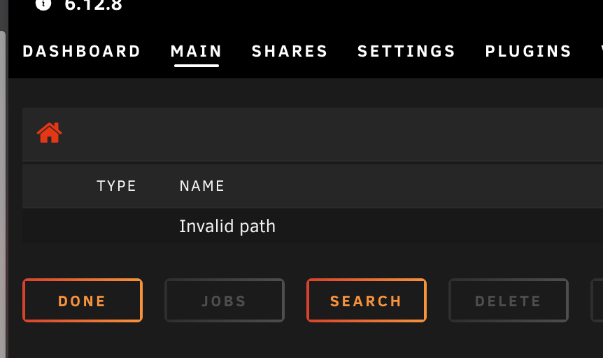

When I click on any drive or share I get this. Not sure if it's because it's "stopping" the array...
dmesg -T:

Not sure how it managed to get 2.5TB with raid0, it should only be able to use 2TB, only the single profile can use the full 3TB, stop the docker and VM services so nothing writes to the pool, reboot and post new diags, if the pool doesn't immediately go read-only it may be possible to remove some data, or try to convert to single profile

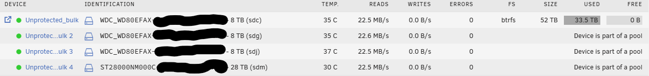

This has happened to me a few times. This time i cant seem to fix it. It is quite frustrating how broken basic Btrfs pool is in unraid. I would have used a second unraid pool but that was not supported in 6.X.

After multiple days of trying different things I was able to resolve the issue.
I had run the balance command before set to single mode but it did not work and did not run balance at all. This is something i tried at the beginning. After much messing about and trying other things to save the data I decided to revisit using the single mode. With the server running for a bit and the container running that accesses that pool the balance command errored out (would go into read only mode). The container accessing that pool might be doing some kind of writing that i was not aware of.
Booted up the server with the container and SMB disabled for the BTRFS pool and the first thing I did was run the balance command to single mode. This time it ran without erroring out. Took some stressful 5 days but the data is intact and the pool is healthy and working properly in single mode.
I wish I would have know that BTRFS needed to be in single mode to use the full space. This was something I specifically looked for when I added the 28tb drive to the other 8tb. The problem was the Unraid GUI lied to me about the amount of free space. I was also not knowledgeable enough at the time to check the correct place for the amount of available free space.
