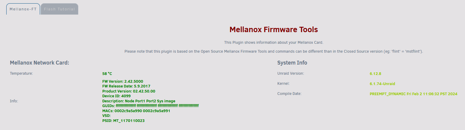

best choices are used "Mellanox Connect-X3" cards. There are several different versions, the very old one uses a PCie2.0X8 interface, the newer one a PCIe3.0X4 Interface. Make sure you have an appropriate spare slot available on your Motherboards. They are rock solid.
Either on Windows,
or on UNRAID:

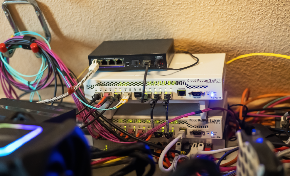

One Addon: its cheaper and more reliable if you buy a 2nd 4*2.5+1SFP+ unmananged switch (they are less than 70€). Connect one SFP of the microtik with a 20cm DAC and you have 4 RJ45 Ports that work well and cost less.
Looks like this
(Sorry its a bit full in the moment, I am building a new PC currently, the desk is full of new parts :-)))
You see 2 Mikrotik 309 (connected with 2*DAC as a trunk to each other) and a cheap 4*2.5+2*SFP noname unmanaged switch on top.
As long as there is ONE managed switch, flow control will work because the unmanaged ones pass it on.
Cheers mate your advice is invaluable..  I'm going to start pricing this up and get ordering, going of that picture looks like your using a hell of a lot of fibre in your setup.. Does the 309 offer anything more over the 305 besides the additional ports. Also are you able to manage the switch via the sfp ports or do you have to plug something into the dedicated management port to access the management software?.
