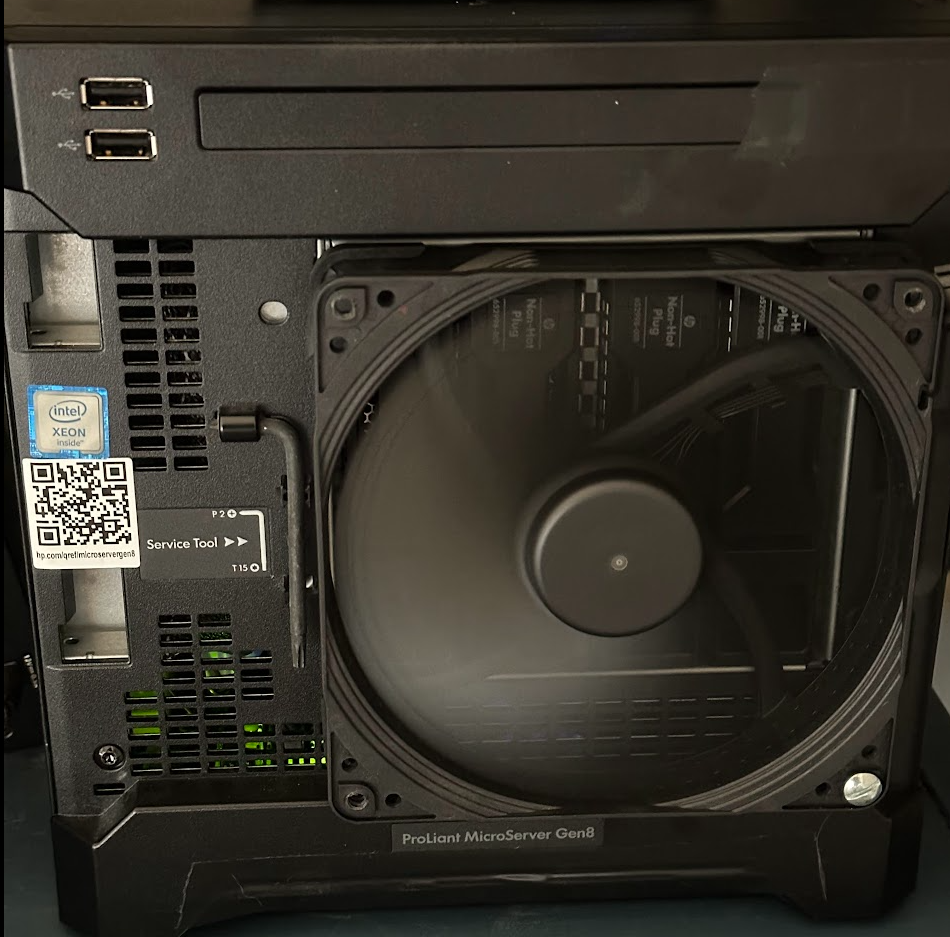

It's a tiny case with little cooling capabilities: there's one exhaust case fan that cools the entirety. Both the CPU fan and the HBA fans are DIY, it ships with a passive cooling CPU heatsink.
Cutting into the case itself is an option I've explored. I've mocked up a way to add an intake fan, but I want to continue minimizing wattage and noise.
Appreciate the consideration!
I looked at a YouTube video and I would be considering doing an 'ulgy' case Mod!  I would cut a opening for a fan in the hinged front panel directly in front of the HDs to mount a fan which would blow air into the case.  I would also look at adhesive form tape around that opening that would force high percentage of the fan's output over the drives.  (Please understand that in a server I value function much more than form and beauty!!!  To accommodate the latter, I would turn the case so one of the side panels was the one must likely to be seen.  This might be a good use for that Noctua NF-A12.)
Used a 140mm Noctua NF-F12 (the pressure optimized version) as an intake fan and made one hole for the bolt as a temp mounting solution. So far temps are down from high 50s and in to the high 40s. It does look like the exhaust fan could only hold the temps stable and not cool the case if temps rose. Thanks for everyone's responses!
