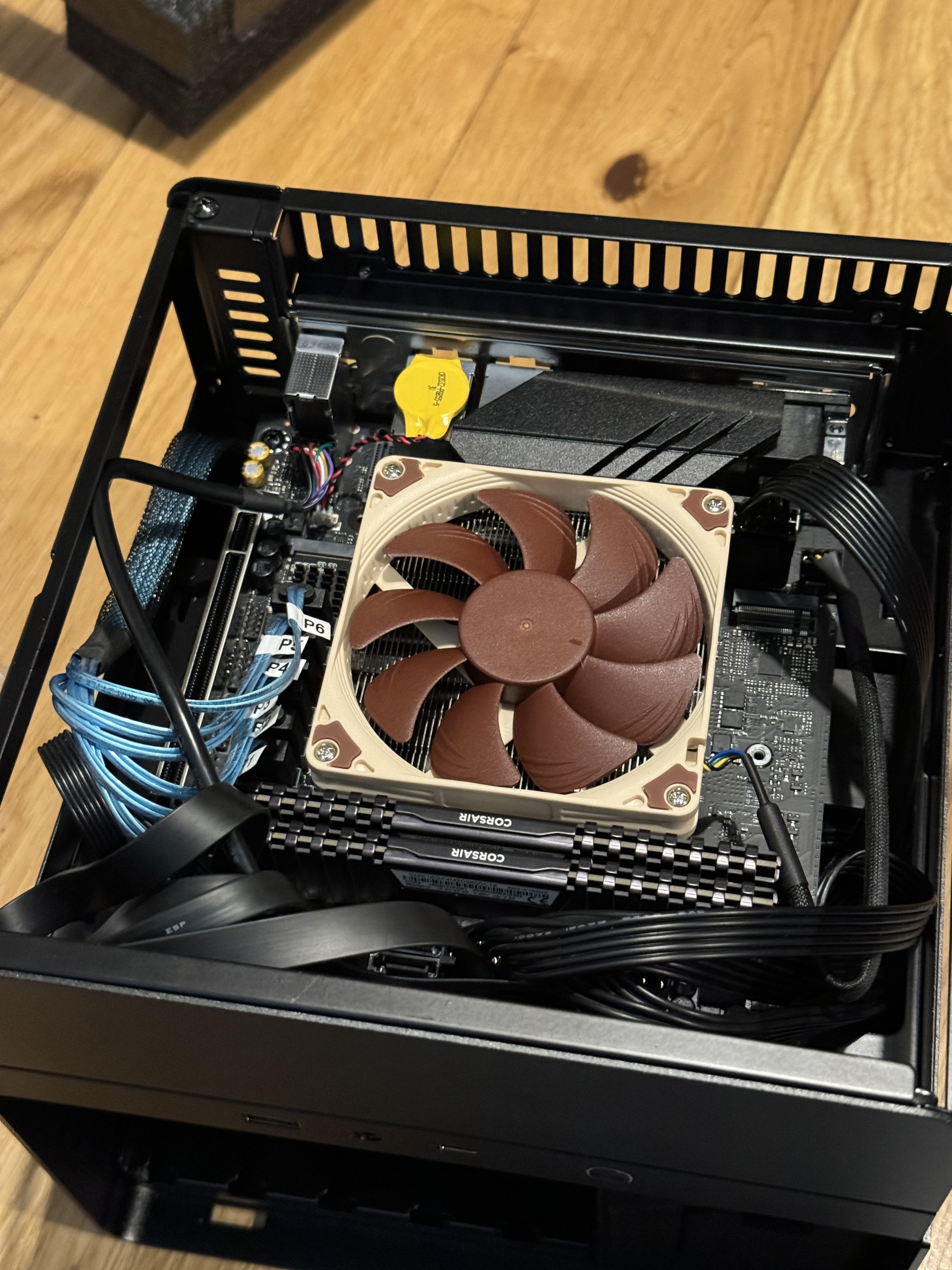

Top of the case (missing the GPU):

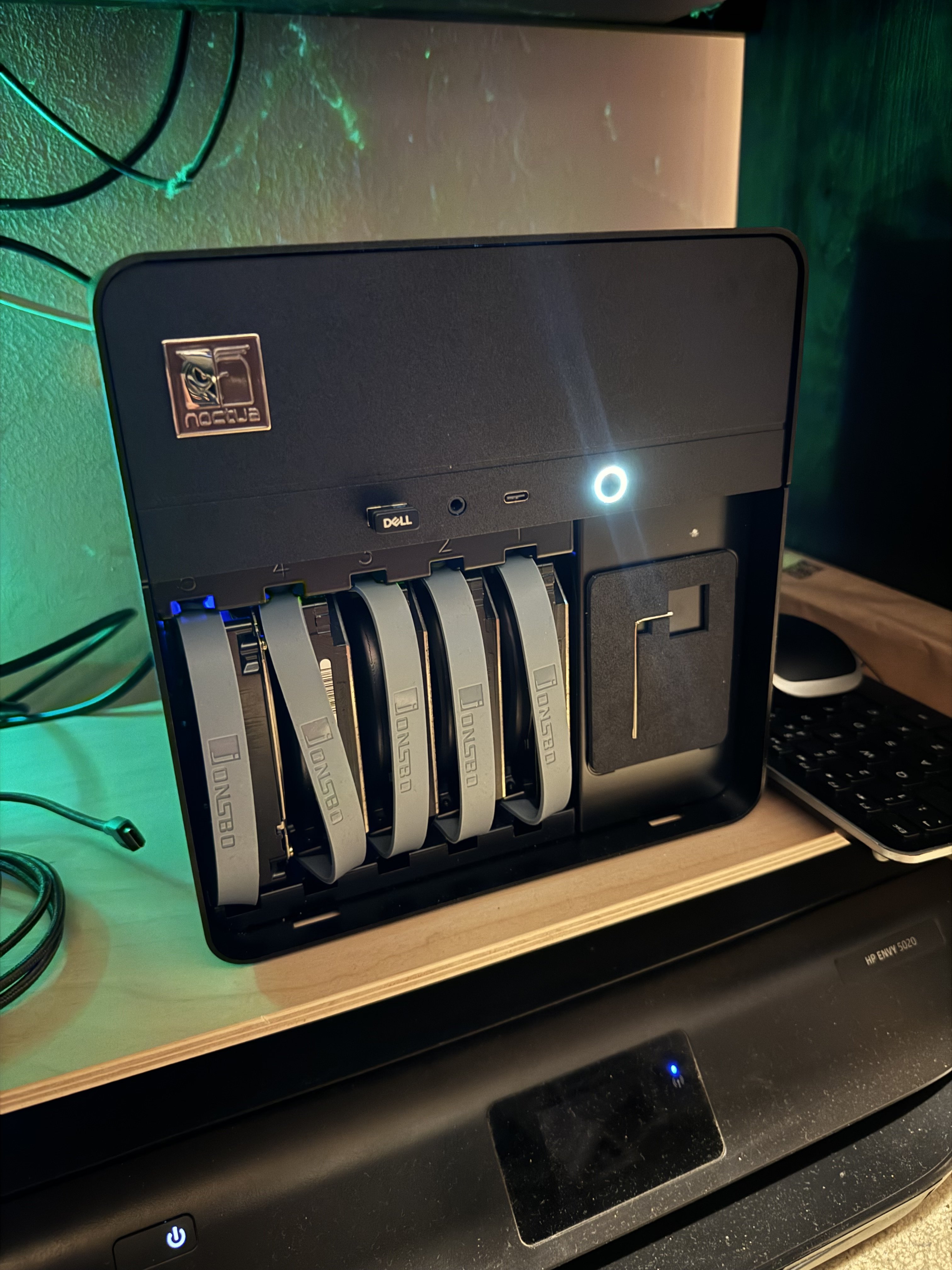

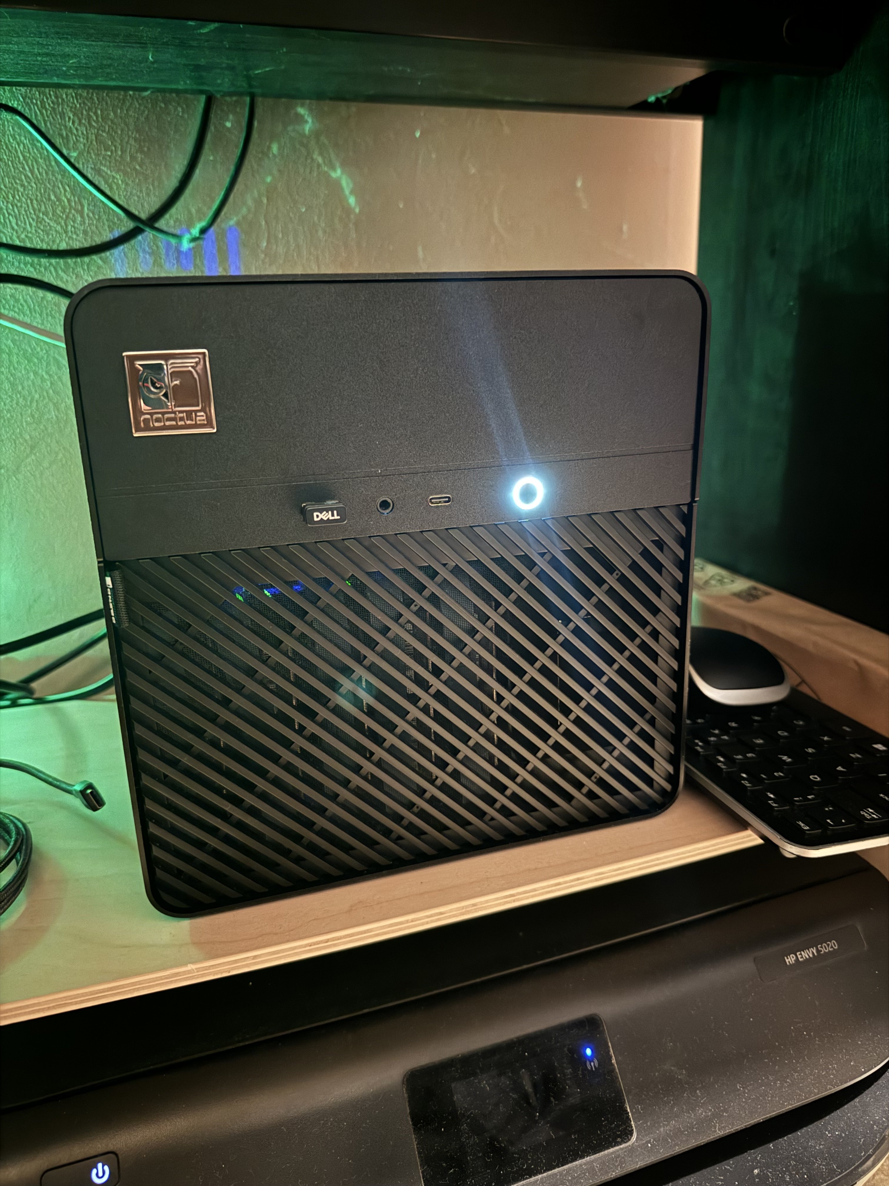

Front view, currently under my desk:

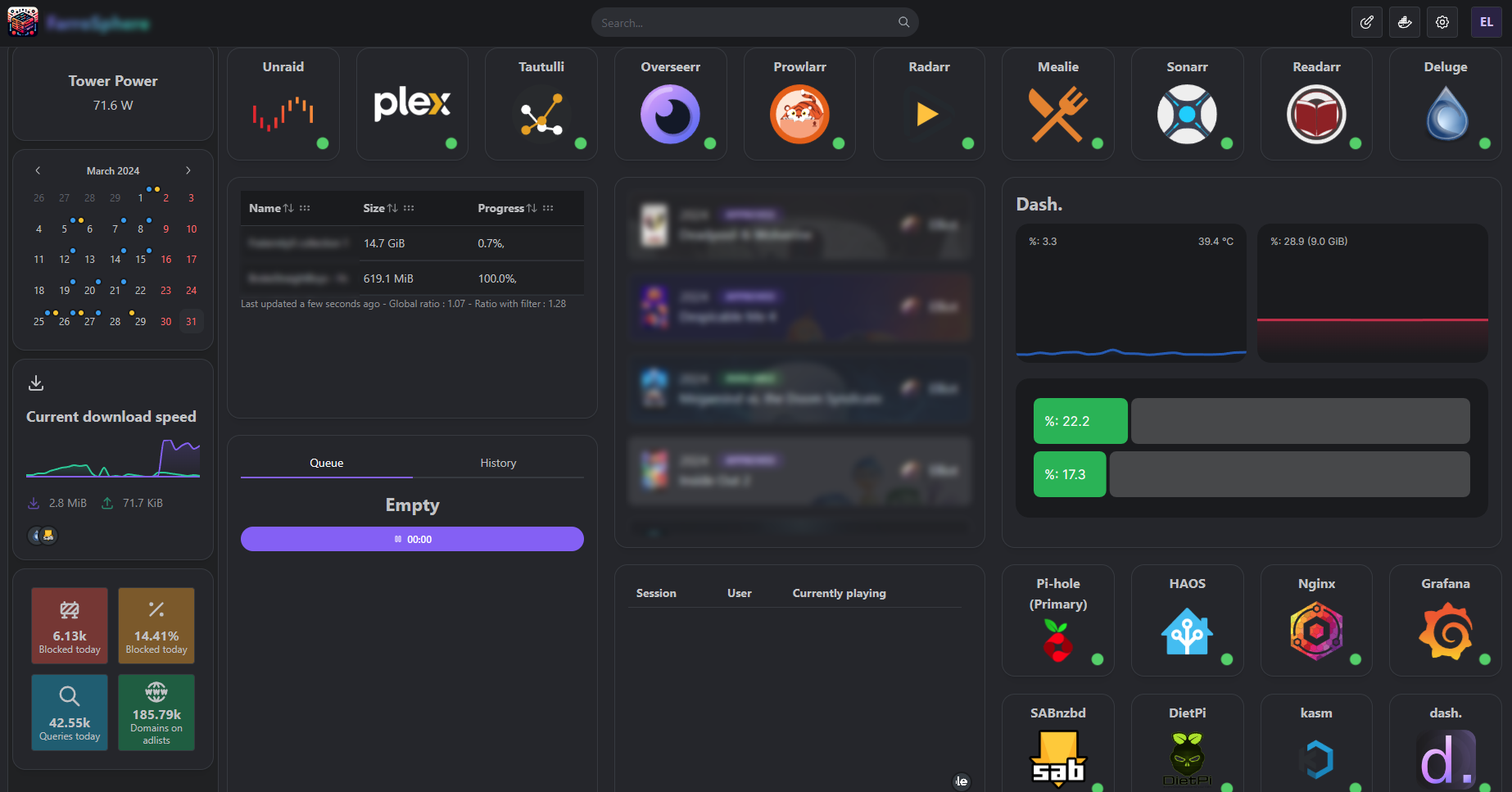

Homarr Dashboard shows most of the Containers currently running:
