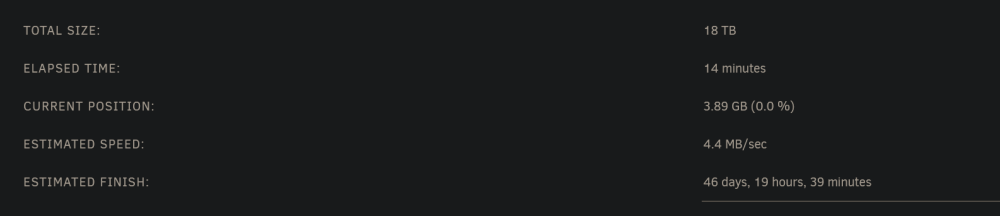

Slow Parity Sync - 2-8mb/s
Hey, trying to throw a parity disk into array but just cant get over how slow it is, estimates going from 40-600days, tried a couple of things, tried some more, stopped docker and vms, not doing any smb to it. It's a fairly big array mind you but surely it can do better than that. one thing of note is I've got ssd and nvmes in main array but if anything I'd expect them to be last ones to cause issues, left it to run for almost 2 days, got 1-2% done, stopped it and tried again same results, did a disk check on all drives, no visible issues, all disks have at least 150mb/s at start of disks and slowly fall off to around 100, the new parity performing best of the lot as well and ssds nvmes doing over 1gb within cache.
cache moved just in case, no other reads/writes on array, I've some old plugins but they shouldnt interfere i dont think, tried playing with tunables to marginal or no improvements (left it at default in the end).
Attached diags if anyone could help me out please.

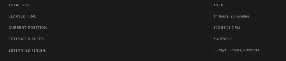

Okay, back to vm and docker off, removed unbalance and some other plugins I've not used in ages and removed my smb mount. still seeing same speeds, can you confirm where you're seeing the disk traffic in diags. cant think of anything else that might be touching the disk, any cmd I can run to spit out use logs maybe? could unraid connect be doing it? I doubt it but running out of things I guess.
attached post change. 6mb/s still.

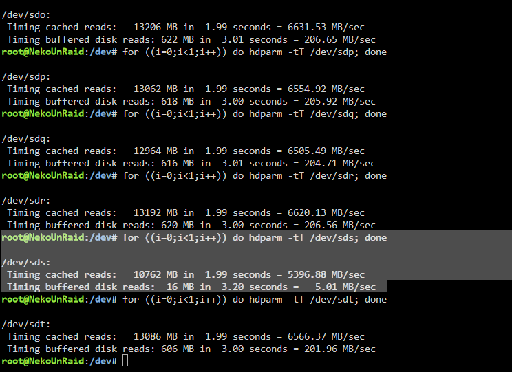

also i ran all disks through disk speed docker, they came back as expected, it complained about not seeing docker volume mount or smth but thats probably dev issue and/or 6.12.9. didnt grab screenshots but all were 200-100MB/s over span of platter with ssds doing better and nvmes happily doing 1.5gb/s
unraid cli can do quick check with hdparm right? from unraid docs
for ((i=0;i<12;i++)) do hdparm -tT /dev/hda; done
worth pausing parity sync and runnign across all disks?
Edited by Mizerka
Controllers look normal, but if the disks are performing normally with speed disk not sure what it could be, you could try syncing parity with just half the array, then try the other half and see if there a difference, if there's not, try with a different disk as parity.
did that anyways, this might be the reason, all disks coming back with 200mb ish (not accurate but close enough)
root@NekoUnRaid:/dev# for ((i=0;i<1;i++)) do hdparm -tT /dev/sds; done
/dev/sds:
 Timing cached reads:   10762 MB in  1.99 seconds = 5396.88 MB/sec
 Timing buffered disk reads:  16 MB in  3.20 seconds =   5.01 MB/sec
sds being disk 26, sob, getting unbalance back on and moving data off of it and gonna see how it behaves afterwards.image.png.09c0aebf8d3778281c7626a33254405c.png

Yeah, that one could be the problem
You say that you want to remove it from the Array.
Why sync the Array with disk26 IN the Array ?
Keep it outside (unassigned if need be) and sync with just the rest.
I want to replace 25 and 26 either way, 25 was already cleared prior sitting empty, I've had no parity for over 3 years it can wait a day for me to remove them for now. Thanks for helping btw JorgeB, I'll drop an update probably tomorrow with how it turns out, its about half way done.
Yeah that was it, on the shelf they go to never be used i guess. 100mb/s ish parity write with 2.3gb/s array read going atm, feel like it could do better but this time it might be capping controller, mere 2days to complete.

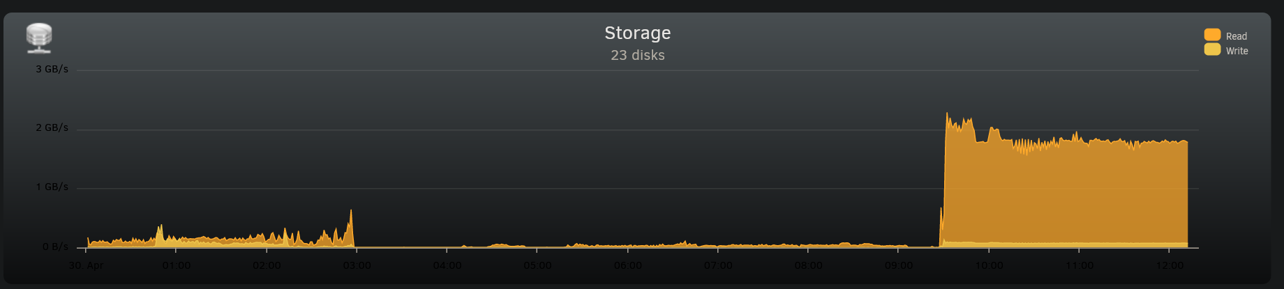

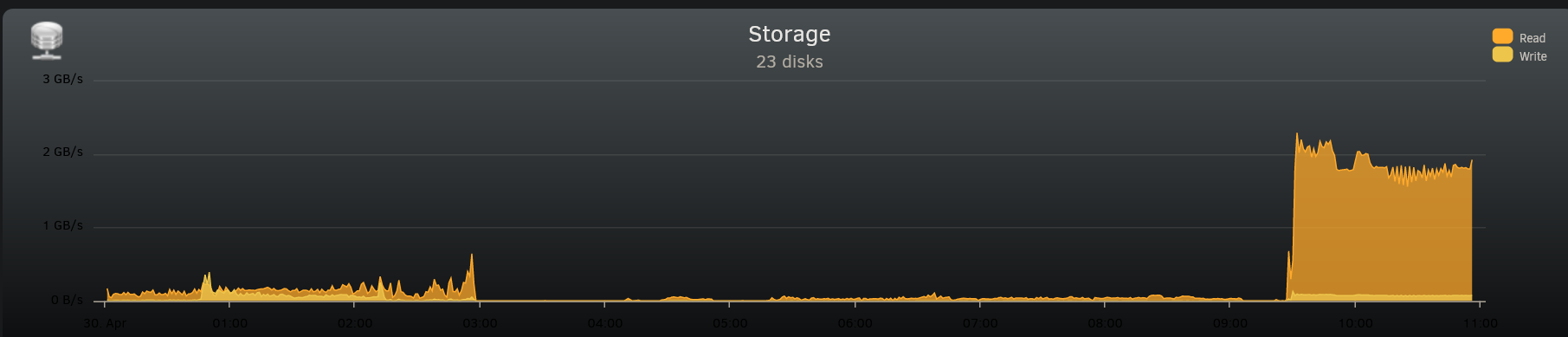

array reads improved but only temporarily? interesting, still worse than what it started as, got a bit wobbly for a bit but now back to stable 1.8gb/s, i assume unraid is doing some stability magic in background, not certain, or controller isnt happy, at this point, its past furthest its been on new parity disk. still 20x better than before but about half of expected read capacity of disks.
on graph, started at 2.3 ish, went down to 1.8, after tunable changes back to 2gig, wobbled a bit and now at 1.9
Edited by Mizerka
48 minutes ago, Mizerka said:
and 16 on 9201 16e
This will be the main bottleneck, max usable bandwidth is around 1600MB/s, with 16 devices 100MB/s per device.
Tunables should not make much of a difference with current releases, they did before 6.8, or maybe 6.7.
yeah figured as much, hmmm I might have 2x spare 8i's somewhere, now that I have a spare pcie lane, also could move disks around hot bays more strategically so as it stops reading lower capacity disks it can balace the 2 controllers better without capping out. I'll live with 80-100 its doing atm, will take forever either way. and ye I read your posts actually on the tunable stuff, weird that it made a difference albeit brief just after changing poll and num stripe.
for now continues at 1.8-1.9gb/s with 80mb/s write to parity, 2% cpu (crypto) and 2.3gigs ram use. happy enough for now, thanks.image.thumb.png.fe44863afd2dcecafe1ecd3af8645bd9.png
