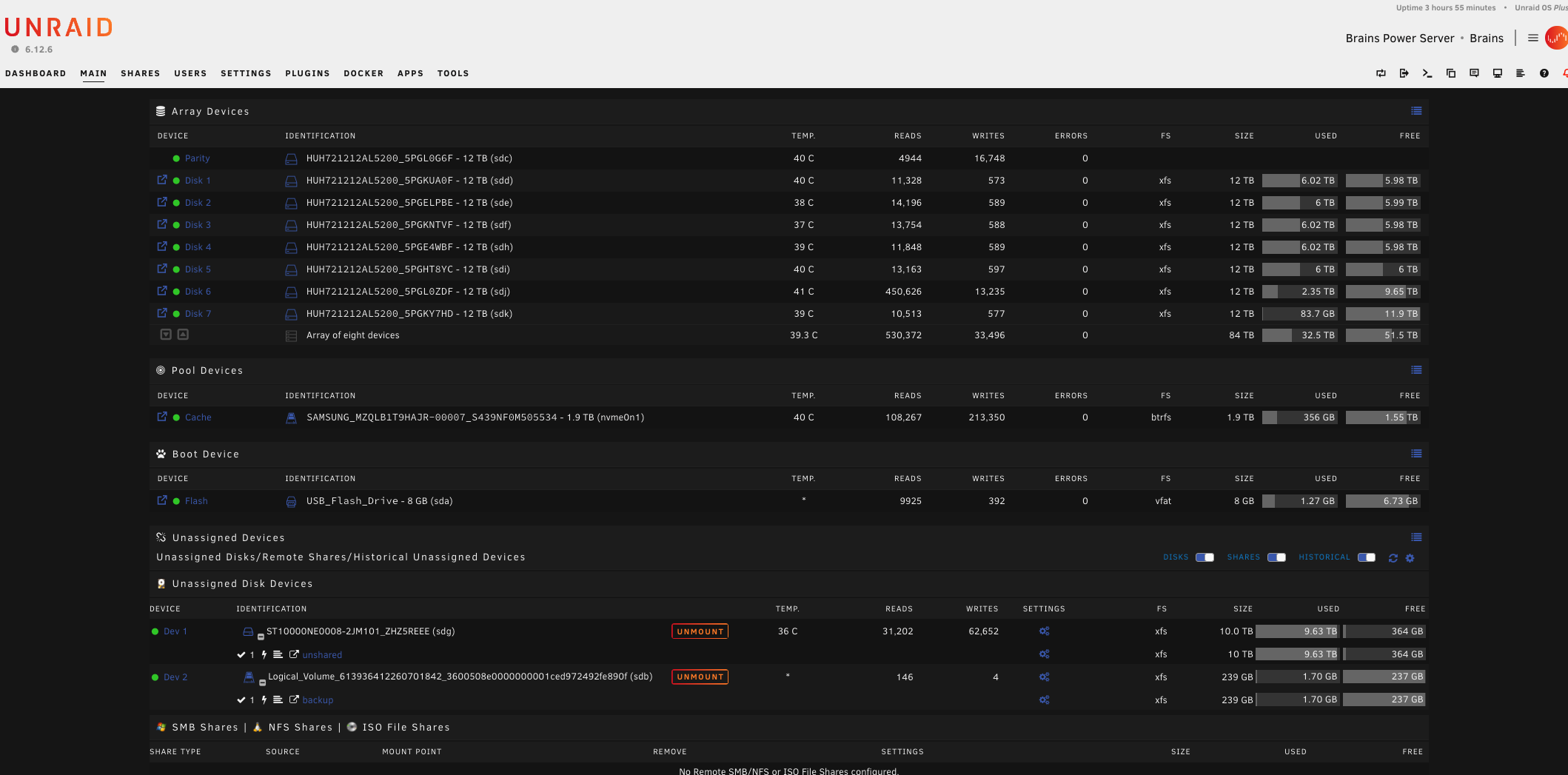

Log is already full of spam, but the pools appears to have mounted correctly, post a screenshot of main.
Yes i know about the firmware error, cannot get rid of it, it is a 10gb ethernetport and i cant find either how to disable it or get the proper hw driver for it.
Is there an easy way to get rid of this error?
Anyway, here is the screenshot of main:
