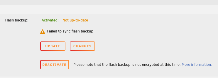

Unraid Connect: Failed to Sync Flash Backup
Solved by ljm42
I've noticed that if I run the steps @andrebrait suggested and then re-activate, I briefly see a "permission denied" message before the page refreshes. Once I click the update button after the page loads, I receive the "failed to sync flash backup" message.

I have all the same symptoms. On 7.0.1, don't know when it stopped working, but it used to work. I de-activated, re-activated, activated, removed the cert, had the cert re-created. Just says "failed to sync flash backup."
Same here. Tried everything suggested. UnRaid 7.0.1
thought i'd try unraid connect to get online flash backups, however flash backup is not working, same as op. what a waist of time, thanks

I believe LT is looking into it, but while there's definitely an issue, it just affects some users, and last I know of, they haven't been able to reproduce it yet.

LT believe the issue was found, it can take one or two days for the fix to get applied to all, but please keep testing and it should start working soon.
I de-activated and then activated. Received Activated: Up-to-Date
Thank you!
I can confirm it’s working for me now as well. I didn’t have to do anything - just loaded the Connect plugin, and it showed as up-to-date.
