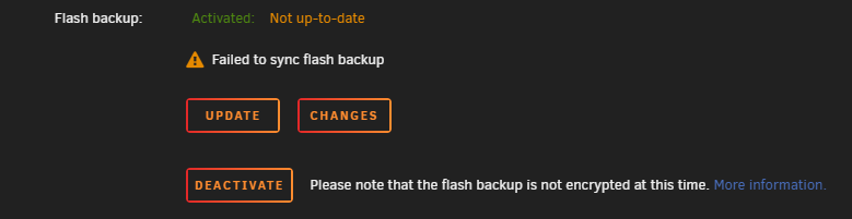

May 31, 20242 yr Hello, first, apologies but I cannot post in the Unraid Connect subforum, even though I am logged with the same Unraid.net account in my server. From today I noticed this. I already tried: to deactivate and reactivate the flash backup (without deleting old backups) sign out from unraid.net, restart the unraid api, sign in again rebooted the whole server ssh -v -T [email protected] command shows no issues (Unraid Flash Backup should have no issues connecting. Goodbye) If I clic on "Changes" button, it shows a blank window In Unraid Connect dashboard, my server is visible (so no connection issues with connect servers) I can create local flash backups without issue, but the online flash backup doesn't work. How I solve this? I changed nothing in my server. Thank you!

May 31, 20242 yr Having exact same issue. On latest release and getting same message of 'Failed to Sync Backup'. This seems to have been an issue for many going back to 2022 and here we are in mid-2024. Can someone from the Lime Tech please explain how to resolve this as of now because all the previous posts about resolving it don't work. Or if someone else has a clue on how to fix this then please advise.

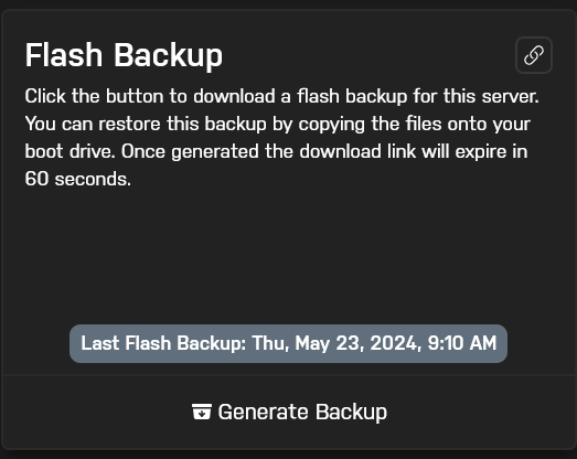

June 2, 20242 yr Hi folks, I can confirm we're seeing this too. If you need to make a backup in the meantime go to Main -> Boot Device -> Flash -> Flash Backup

June 3, 20242 yr 14 hours ago, ljm42 said: Aaaaand we're back: https://forums.unraid.net/topic/138392-unraid-connect-plugin-announcements/#comment-1427183 NOT working for me still. Signed out and signed back in. Still see same error. And now I can’t even deactivate the backup. Was going to try that and then re-activate before trying the backup again. Not sure where to go from here. Ugh.
June 4, 20242 yr @ljm42 This is still not working for me. In some ways it’s worse as before I could deactivate and reactivate even if the back up was failing. Now it does nothing. Can’t deactivate or back up. Tried logging out and back in to Connect and that didn’t do it. Stuck. Can you help?
June 4, 20242 yr 1 hour ago, misterwiggles said: @ljm42 This is still not working for me. In some ways it’s worse as before I could deactivate and reactivate even if the back up was failing. Now it does nothing. Can’t deactivate or back up. Tried logging out and back in to Connect and that didn’t do it. Stuck. Can you help? Let's see if slowing things down helps. Deactivate, wait 30 minutes. Reload the page one time. Wait 1 minute. Press the Activate button one time then don't press anything for 10 minutes. Reload the page, wait 5 minutes. If the status is activated but not up to date, press Update one time and wait 5 minutes. Has it stabilized at this point?

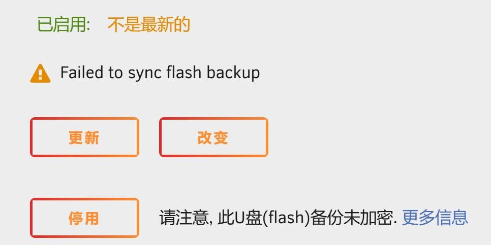

March 28, 20251 yr I’m still not able to backup either. Getting the “Activated Not Up-to-Date” and “Failed to sync flash backup” errors. I’ve tried all the suggestions on this thread. UnRaid 7.0.1.
