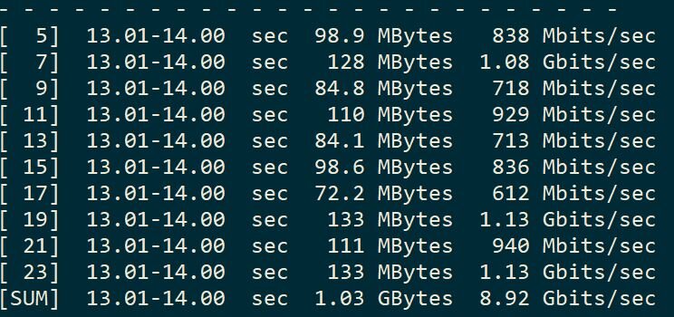

Hmm, interesting, I tried to run iperf3 -P 10 and it shows 9gbit sum speed. That means it is working somehow.

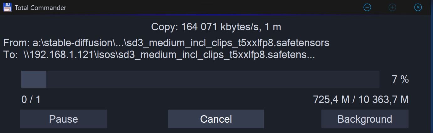

But how to reach good files copying speed? I have one nvme Samsung 990 pro ssd with NTFS filesystem in the unassigned devices which I shared to test copy speed, also I have some btrfs cache drives over some shares like isos folder. Copying files to ntfs drive speed is like ~150 megabytes/second, copying files to cached share is ~175 megabytes/second. Why it is that slow?
This means that you should get good speeds for simultaneous transfer, but a single file transfer is usually limited to a similar speed as a single stream iperf test, not always clear why some users see better speeds with similar NICs, maybe cable or transceiver related, if applicable.

If so then why did I have 2-3 times lower copying speed if my single iperf thread speed shows ~4gbit? 4gbit is something like 500 Mb/s but I'm getting 170 Mb/s. For me it seems that unraid has some serious network issues. Did it also has single-threaded packets queue?
It's never exact, it's a good indication of the current possible speed, but sometimes I see users than get transfer speeds faster than the iperf single stream results, other times slower.
But ideally you want a single stream iperf test to be close to line speed, I usually get around 9Gb/s for my 10GbE NICs, and around 1GB/s for an actual transfer, on the other hand, don't get close to 25GB/s for my 25GbE NICs, but still get close to line speed for an actual transfer.
