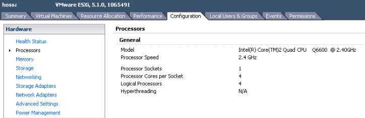

Yes, reply to old post, but I only recently did this install. I have ESXi 5.1U1 running on a Core2.

What motherboard are you using?
Just some junk, Gateway DX4710-05. I suspect you want the chipset, which G33.
Thanks for the info C3.
