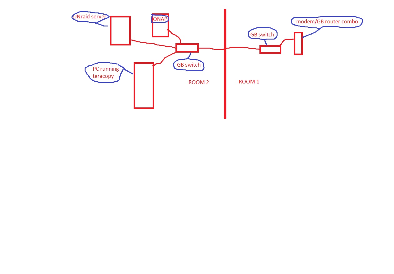

the write speed is about 35MB/s peak, in actual fact this is going from my QNAP server to the unraid server, both are connected to the same switch although the router/modem is in another room, see the network topolgy i have added (very crude), i can confirm it is hitting the cache drive as the file appears on there and is growing
You're probably maxing out your network copying from one network device to another. Try copying from the PC to the unRAID server.

Are transfers between two machines on the same switch faster?  You could always try that cache drive in your desktop and see what speeds you get copying to it from the network.

I would use a solid, trust worthy drive for cache. every bit of data you write to your array goes through this drive without any sort of parity protection.
It can be a weak link in your data protection. If your cache drive is spotty, it could cause corrupted data being written to your protected are of your server. you might not even know this until it is to late. I personally have experienced this myself.
You may gain the benefit of speed, but you open up other possible issues.
As weebotech pointed out, it is a good idea to have a spare drive for your system handy. you never know when a drive will fail. most people use the spare drive for the cache. usually it is the same size as the parity drive just in case that is the drive that dies.
For every one of my servers, I have a spare drive on a shelf or in the server just for this.
unfortunately, this hard drive shortage is just a pain a wallet right now and a lot of us are pulling out old drives from old systems to make due.
heh, I did not realize you had that tiny server.
If that's the case I would not put too much effort into it.
There are other cool products that do power over eSATA if you wanted to have an external eSATA drive without a power cable.
I don't even know if a cache drive is worth it if you have a low powered server to begin with and limited SATA ports.
are you laughing at my server ??? :'( LOL, seriously, it does for me, its a neat little box and the reason i chose UNraid was because when i go bigger i can just move all the drives into a bigger box and sell the proliant on.
Why would you suggest it may not be worth having a cache drive in such a low powered server like mine ?, after all, the psu is enough to handle the drives i have in it, im sure it wouldnt be happy if i installed another SATA card and tried coupling molex's to get power for more drives but as it stands i am only using what power outlets and ports that came with it, so surely a cache drive is better to have than have not in any case ?
I'm not laughing at the server, they are neat lil boxes. I was thinking of getting one, but stopped myself since I have enough equipment for 5 unraid servers if I wanted.
For my server,  I get 30MB/s write to a parity protected array drive.
If you choose fast drives for parity, max out the ram and tune the md driver well enough  you may not really need the cache drive.
I have one, but I do not use it to cache writes since 30MB/s is fast enough for me to write to the disk share directly.
Now if you had a fast cache drive that did 60MB/s it might be worth it.

33MB/s write to a parity protected drive is about right.
102MB/s read from a parity protected drive is about right also.
The smokin' comment was because Johnm used a SSD for the cache drive.
/mnt/disk4 is a parity protected drive, so those speeds are correct.
Your prior cache speeds are slow. So as you mention, you would be better off with a faster cache drive or just a data drive.
So i have my cache drive now, a 320 gb 2.5" WD drive.
What model drive is this? Blue? Black? if its a 4200/5400RPM Drive then i wouldn't expect you'd see faster speeds.
maybe with a 7200rpm drive
Even a 5400 rpm drive should get much, much faster speeds than that. When I was using a WD 5400 rpm drive as my cache drive I still got 90MB/s(720mb/s) to 100MB/s(800mb/s) transfer rates. With a 5900 rpm drive I was getting 95MB/s to 110MB/s transfer rates and a litle faster with a 7200 rpm drive. I ended up putting the 5900 rpm drive back in and taking out the 7200rpm Hitachi since I prefer to use Seagate or WD drives over Hitachi drives.
Any modern 5400 rpm drive with high density platters will easily get over 90MB/s transfer rates.
