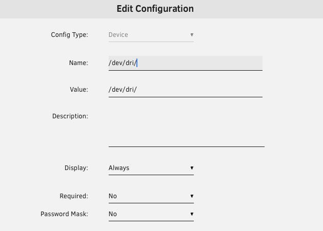

August 18, 20242 yr 1 hour ago, FoeHammerTime said: That's it. That's the question. I have hardware acceleration turned on in the Plex settings, but I suspect there is more to it than that. Thanks in advance! You need to add a device in the Container settings:
August 18, 20242 yr Author 1 hour ago, frodr said: You need to add a device in the Container settings: Just like you have it set up in the picture? I do not have the bottom three settings in the dialogue box. How do I know if it is working? Thanks! Edited August 18, 20242 yr by FoeHammerTime

December 15, 20241 yr Hey, im currently running 7 rc1 and i am having the same problem when it comes to assigning dev/dri/ to my plex container (linux-Server io). do you think this is a container problem or a greater problem? Figured it out forgot the initial forward slash. Apologies for this, its late Edited December 15, 20241 yr by Gsusking2 dumb
December 15, 20241 yr Community Expert You can also just add it here like this: Both ways work just fine.

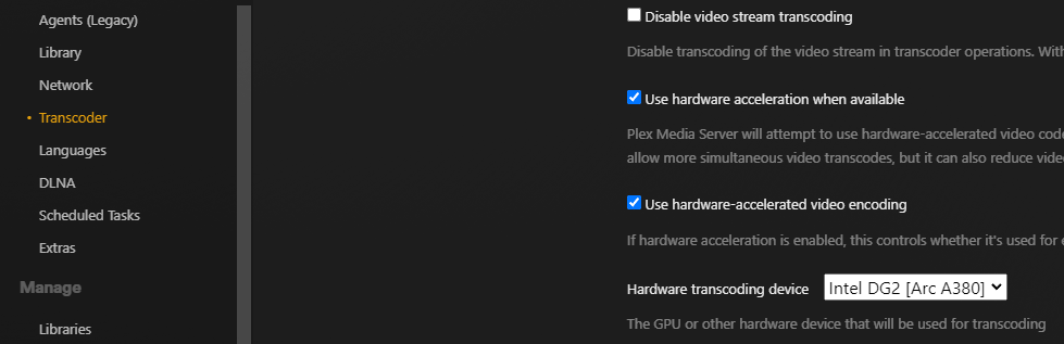

December 30, 20241 yr I've tried all this. I must be missing something small and silly, im not IT expert. its Driving me Nuts! Been waiting forever for ARC support without Beta unraid, So now with RC I was excited. But nope cant get it to work WTF! Running Unraid 7 rc2 Installed Intel GPU Top Installed GPU statistics The card is now visible on dashboard "Intel GPU DG2 Arc a380" Added the device in the plex config as found on other instructions, IE: config type= device, Value =/dev/dri/ Yet there is no "GPU" section in the Plex dashboard (there is Bandwidth, CPU, Ram) Also don't see the device in the "Hardware transcoding device" drop down only has "auto" in the transcoder section of plex options. I do have plex pass, Purchased just for this. Adding to my frustration. Stayed up till 4am trying to fix this and its driving me nuts. the other issue I'm having is when I click "webui" in the docker it opens up some XML crap I need to add /manage to the url to get plex to open up. I added /manage to the end of the webui option in the config as well but it doesnt change anything. http://[IP]:[PORT:32400]/manage.. Why why why does this not work either. Driving me nuts. using binhexplex.
December 30, 20241 yr 43 minutes ago, UrHandler said: I've tried all this. I must be missing something small and silly, im not IT expert. its Driving me Nuts! Been waiting forever for ARC support without Beta unraid, So now with RC I was excited. But nope cant get it to work WTF! Running Unraid 7 rc2 Installed Intel GPU Top Installed GPU statistics The card is now visible on dashboard "Intel GPU DG2 Arc a380" Added the device in the plex config as found on other instructions, IE: config type= device, Value =/dev/dri/ Yet there is no "GPU" section in the Plex dashboard (there is Bandwidth, CPU, Ram) Also don't see the device in the "Hardware transcoding device" drop down only has "auto" in the transcoder section of plex options. I do have plex pass, Purchased just for this. Adding to my frustration. Stayed up till 4am trying to fix this and its driving me nuts. the other issue I'm having is when I click "webui" in the docker it opens up some XML crap I need to add /manage to the url to get plex to open up. I added /manage to the end of the webui option in the config as well but it doesnt change anything. http://[IP]:[PORT:32400]/manage.. Why why why does this not work either. Driving me nuts. using binhexplex. Have you actually tried to do a transcode, even though the GPU dropdown shows only "Auto?" I'm not sure if something changed on the Plex side, but I am passing through an Nvidia GPU into mine and my dropdown also only shows "Auto." It used to also show my GTX 1050 Ti, but no longer. So yours may be working even though it's not selectable in Plex.
December 31, 20241 yr You are looking for the transcoder-section in Plex settings. However, as noted earlier in the thread, the current kernel does not support Arc, so it doesn't actually do anything. It would be very useful if Limetech posted a roadmap somewhere (especially kernel-related). I think we're stuck on 6.6 for now doe to ZFS issues, but I forget 😃 Edit: I seem to recall it worked like 3-4 months ago on one beta 3 or 4 if you want to roll back to that. Edited December 31, 20241 yr by DcDuke
