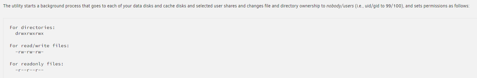

The tool was not working as the description, apparently it's been like this since 6.0.0, the initial idea was to leave read-only folders as read-only, but the tool description was incorrect, but LT decided to keep the description as is, so for the next release, the tool will changes any read-only folder to read/write, read-only files are still kept read-only.
I can see where this will still be a problem.  In my opinion, the number of people who will want the group permissions to remain read only will be a very small portion of the total universal of Unraid users.  (If one is using Share Access users to access shares through SMB, they are likely gaining access through the group permissions.  If the Linux file permissions for group are r-- and the SMB permissions are Read-Write for the Share Access user, it is entirely possibility that that user will be denied write access!)
I can recall several instances where Dockers were generating files on the array where the files were 755 or 644 and it was addressed using the New Permissions Tool.  I can not recall any complaint of someone having an issue with files having unexpected write permissions.

It can, but that is what the tool is supposed do:
We can always have the users run a command manually that would also change any read-only files to read/write if they want.
