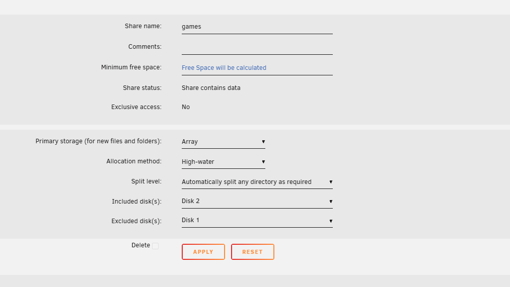

move a share to a new disk
Hello Everyone! I had a "games" folder inside my data share on my array I added a new 4 TB HDD to my array. I just want my isos, roms etc to be on this drive! So I created a new share called games and configured it like this (see screenshot) but according to the file manager and Main tab the disk 2 is empty and everything is still on disk 1. I tried to run the mover, but nothing happens. I once heard I should only copy from share to share, but never from disk to disk. What can I do now?
