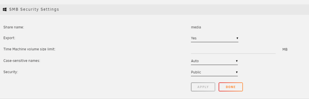

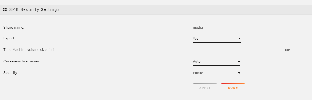

can't delete/write to some folders even though I have read/write permission
no, the tool had no effect on the folders with Dr-xr-xr-x permissions. I had to change those manually
I already ran the New Permissions tool many times. Using google I found this I used this command and got rid of the plus. I ran new permissions again, but some folders are still dr-xr-xr-x I have some basic linux knowledge, but I can't remember how to change the permission on the folder. If you could help me here I'd much appreciate it. Edit: seems like I fixed it. running find /mnt/user/media -type d -exec chmod 777 {} \; changed all permissions on my folders inside pictures
doesn't this mean that the Screenshots directory doesn't have write permissions? Also I have this + here on the picture folder. Which means I messed up on the windows side if I understand the guide correctly?
I get the exact same error on two other computers. But except of "You require permission from S-1-5-21..." it says "you require permission from unschwitz/nobody..."
